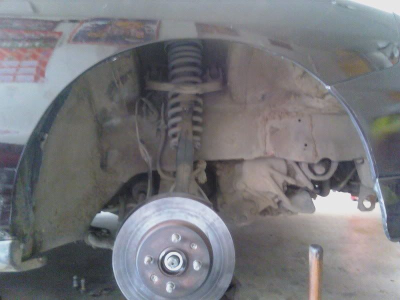

i need some Help tryng to figure out what is wrong with my integra the front passenger wheel got pushed back like 2 inches in a accident. i took a look at it and just cant find anything bent or broken?? lca and Uca look good spindle looks ok too? Any suggestions???

Post pics and maybe we can help you better.

the wheel is pushed back by 2 inches and you really can't find anything wrong? you must not be looking very hard. post up some pics with the wheel off so the control arms are visible.

Well nothing looks bent but il post some pics

Are you sure you know what you are looking at/for?

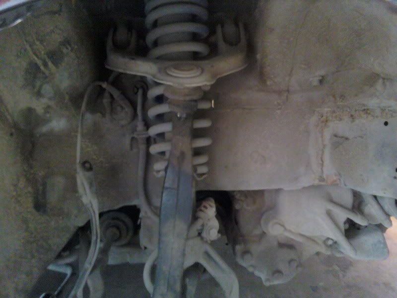

Default Re: 95 ls Alignment

You are telling me that doesn't look bent to you?

lol i know i just noticed that so just replace the UCA?? or what

You might need to replace more when you get a new one and start to bolt it up if it doesn't go.

well i got a new LCA spindle and UCA ama see what happens

the shock and/or shock fork might be bent too
