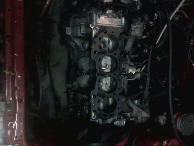

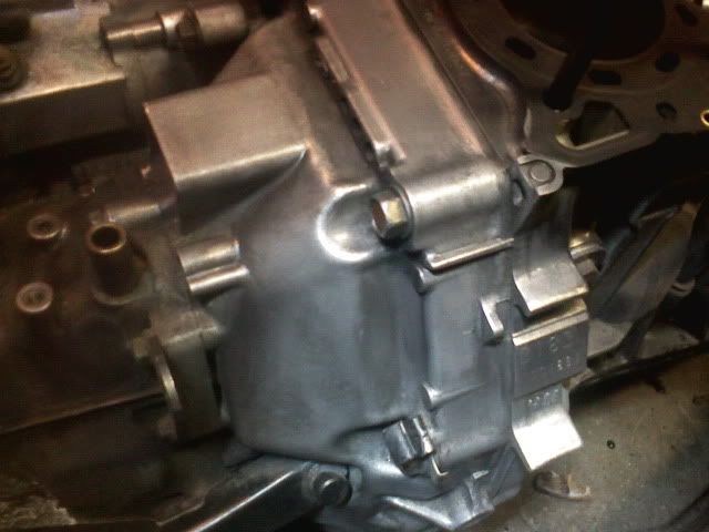

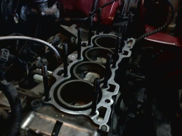

ok good news .. i finnally got the set up damn near complete . . i got the greddy ls/vtec sandwitch adapter with all lines and fittings for 60 bucks . got the head tapped and plugged . used the golden eagle ls/vtec dowel pins with vtec headgasket. got the head back on and working on timing it now . now im worried about what power its going to have i used the compression calculator thing and it came back saying .9.766713392915814 : 1 .. what do you think of that being N/a and would the gsr b18c cams raise the compression any ?
Old Jan 18, 2010 | 01:04 PM
93DB1GSR's Avatar
Joined: Dec 2009
Posts: 65
From: Phelan,CA,92371
Default Re: 93 Integra Db2 Ls Vtec Help
Sorry but no cams will not bump up your compression. You can use flat bottom valves, diffrent pistons, longer rods or a stroked crank. but 9.7-1 would be good for mild boost or nitrous. sounds like your making good progress keep it up maybe add some pics.
