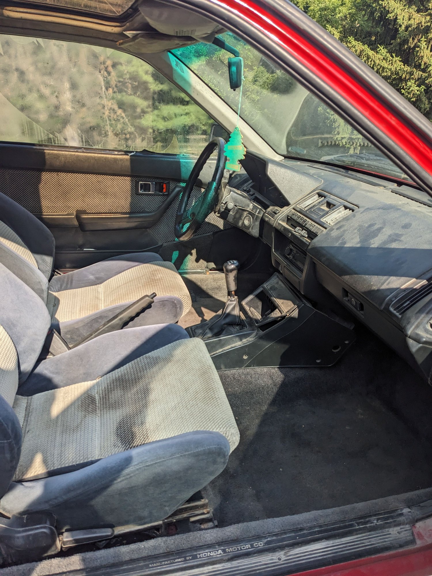

I just bought a rust free 87 Integra that threw a rod thru the engine block. Got it really cheap and want to replace the engine with something a little more powerful. Currently it has the brown top 1.6 and I can't find that engine anywhere, much less any info on what engines will fit into this old car. So far maybe a ZC will fit, B series, but the B is more than I want to spend. Point me in the right direction please. Just want the car running and driving for now. Thanks 👍🏻
