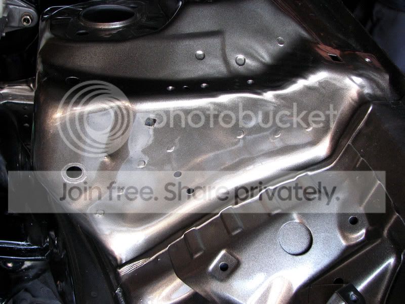

you should just use some mothers aluminum polish on the box. Spend a good amount of time on it and it will clean up so nice! i did it to my box that was kinda messed up, not as much as yours looks though. But im sure it will come out great.

I actually prefer using Bursch, it comes in a liquid so I can use it with my high speed buffer like I did on my bay to polish the paint. I should start working on the intake very soon, still waiting to hear a reply from weksos on the filter and new stickers. Thanks for the info, and like Ramirez428 said, I do a lot of polishing, and have been doing it for a while. I did SiR rims, LS meshies, ASR brace, my RSX exhaust, my GF did the Hasports after seeing me do so many things lol, and I'm currently working on a set of ITR wheels which are almost done. I'm thinking of using them as my daily rims for this car, and keep the MF10's stored away unless I go to shows/meets/track events/etc.

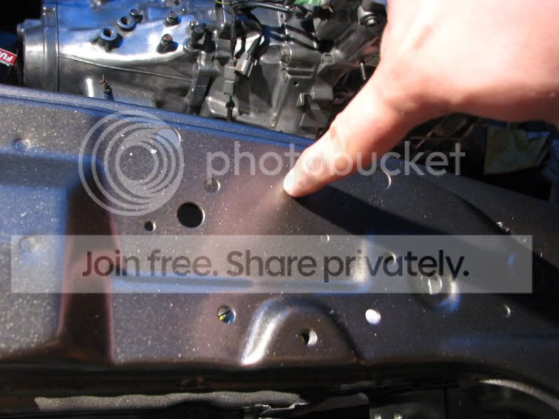

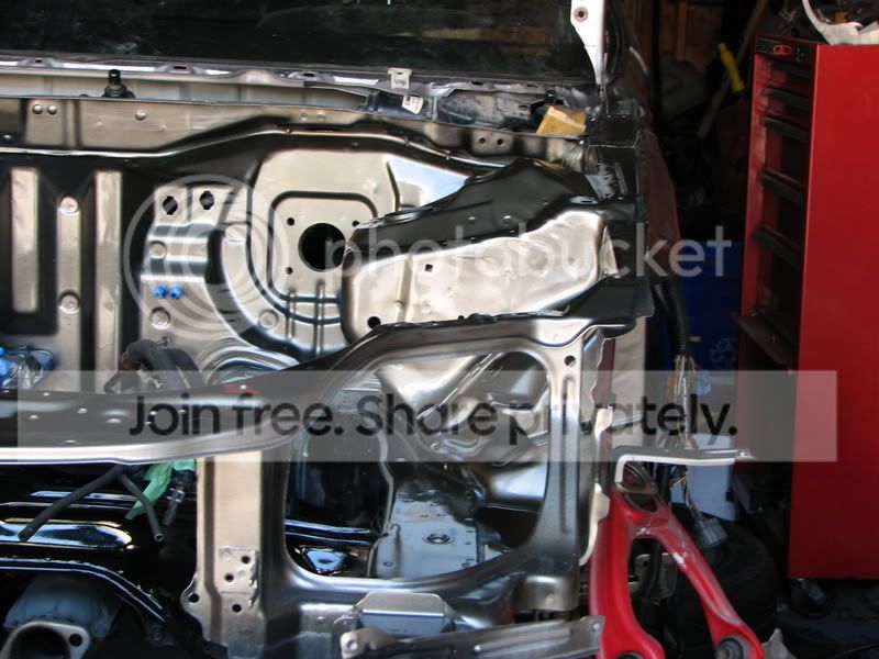

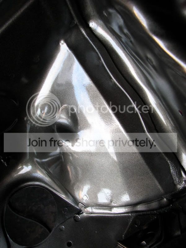

BTW, a teaser shot of the bay once I buffed it:

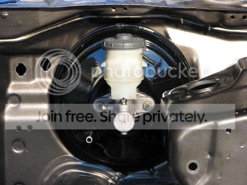

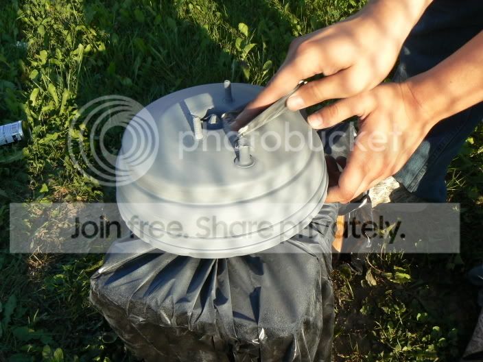

Here is a pic of the brake boosted I painted the first time:
Unfortunetly, I sat it upright and brake fluid splilt out on the paint and it stripped a bit. I ended up refinishing it. I'll post pics later.
After about a week or so of letting the paint cure and dry, I took out all my detailing supplied (I forgot to take pics, but it's just Optimum car compound and Optimum Polyseal which is sealant and polish in one). I'll take pics maybe tomorrow. I'll post the process as well, but for now, here are the after pics of what it turned out to look like:
Before:
After:
New repainted booster now installed:

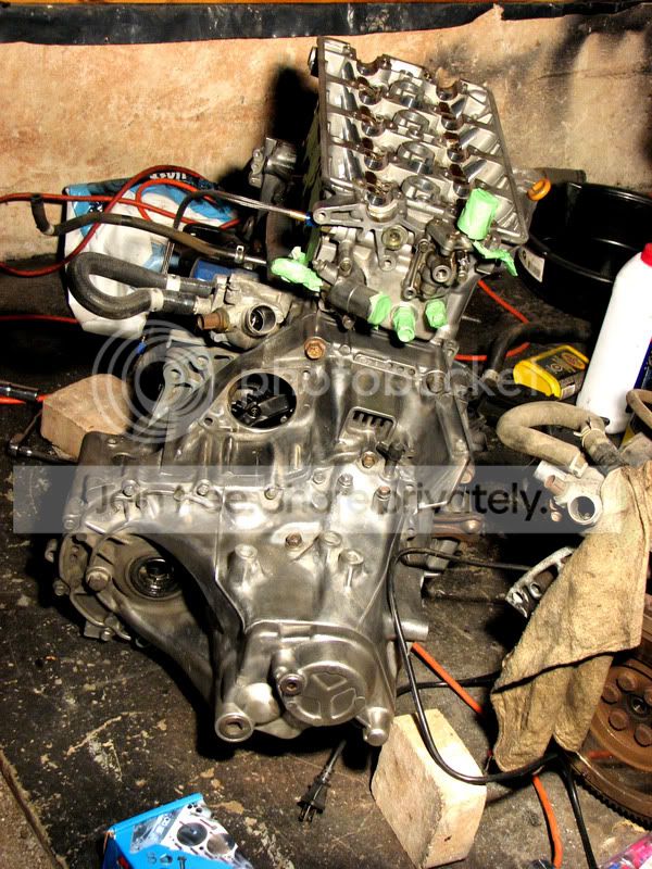

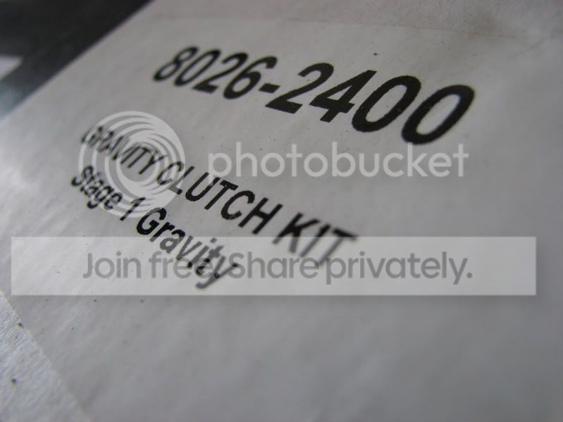

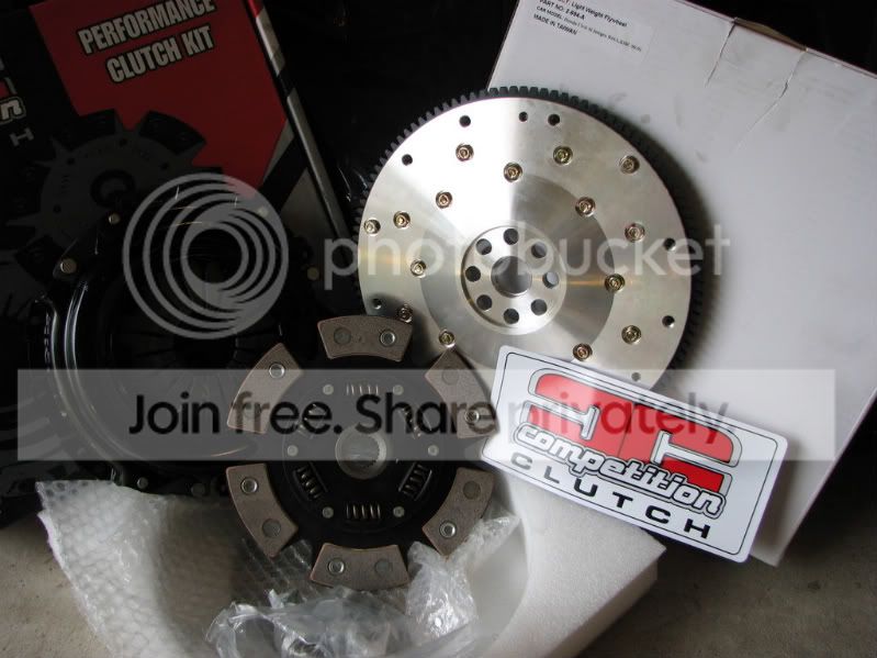

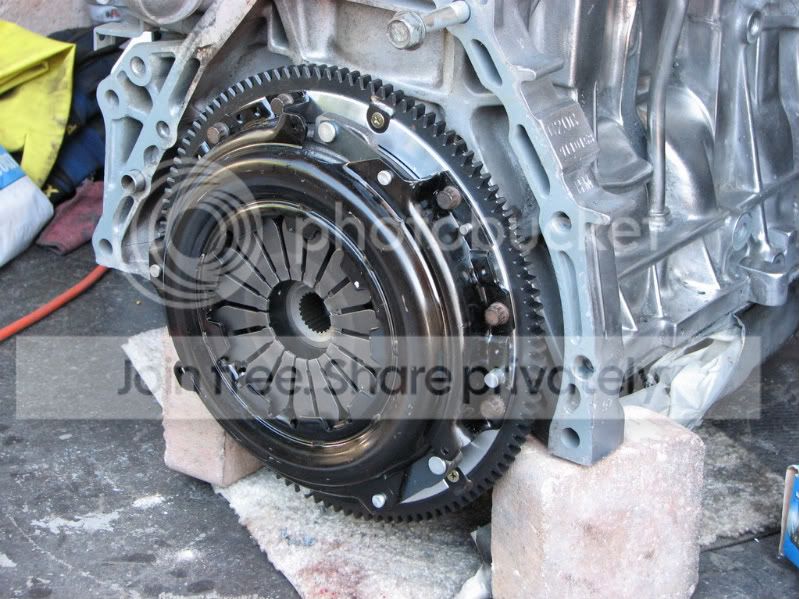

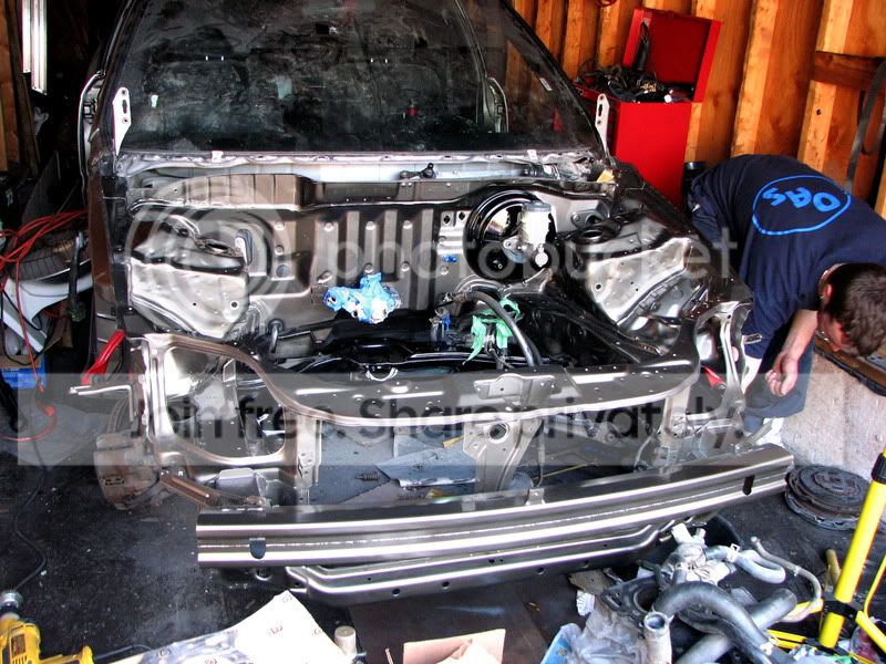

The clutch and flywheel were assembled, and installed with the tranny:
The motor got these:

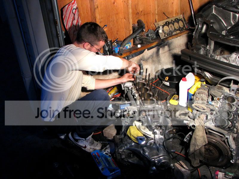

My buddy putting the head together (tranny on as well):

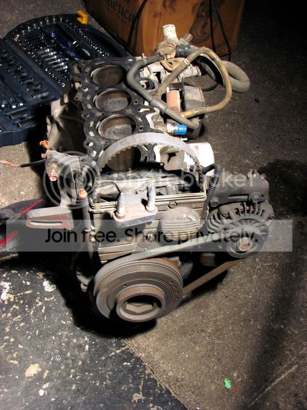

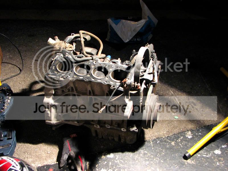

And this is what was pulled out:
Tiny little D with spun bearing
To be replaced with:

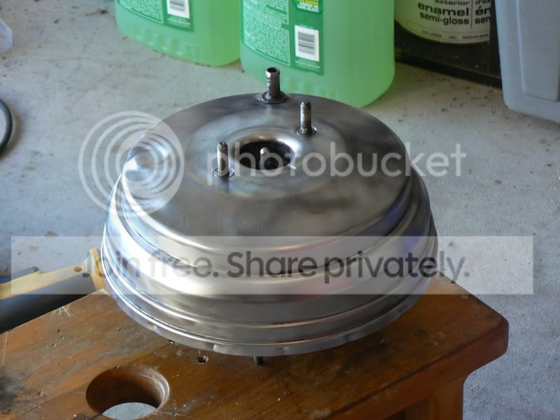

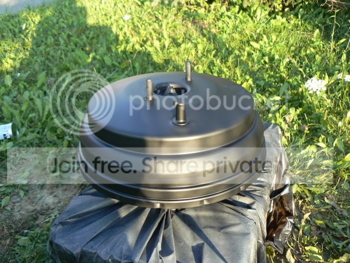

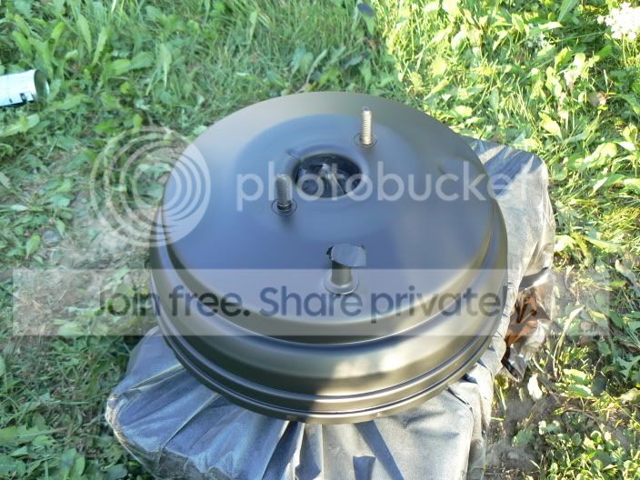

As you can tell from the previous pics I posted, there brake fluid running down the side of the booster, and it also had a lot of scratches in it which needed to be buffed out. Since the brake fluid killed the paint, I redid it.
Before pic:

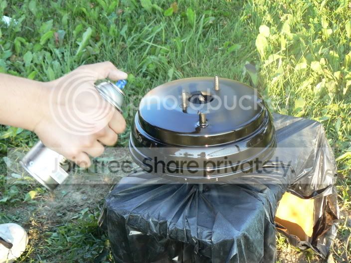

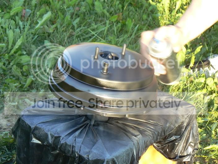

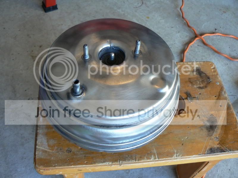

Here is the progress of my brake booster when I repainted it for the 3rd time. I stripped it to metal, and even noticed some rust underneath so I got rid of that:

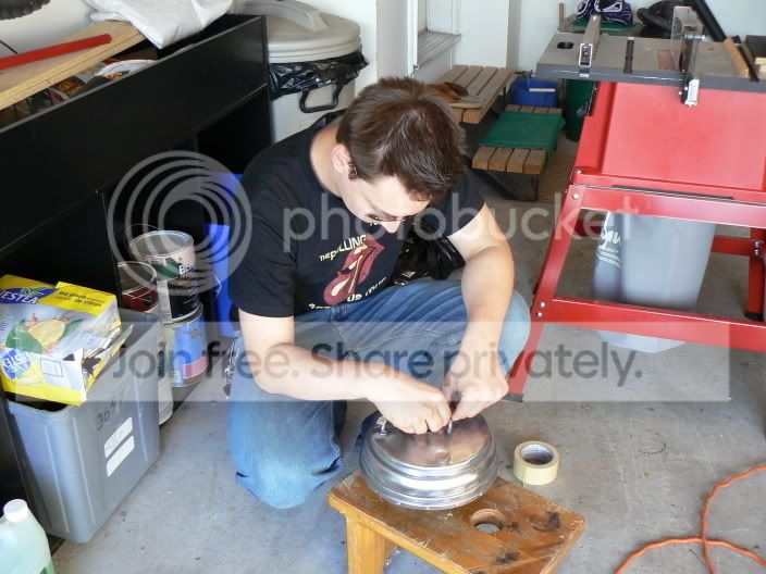

I taped off the vacume line and the hole for the master:

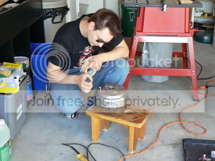

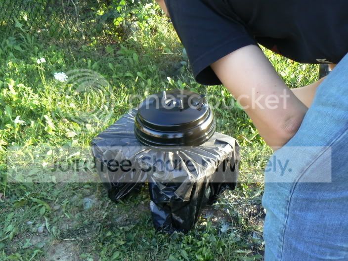

Luckily I found a stool that held it really well in place, it let me spray it perfectly even all over. First I applied primer:
Wetsand the primer with 400 grit (drysanded first):
Sprayed it with Rust encapsulating paint from Eastwood:
I kinda liked the OEM-ish flat black look:

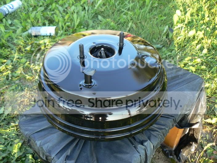

But I'm all about "da bling" so I sprayed it gloss black:
And clearcoated it:

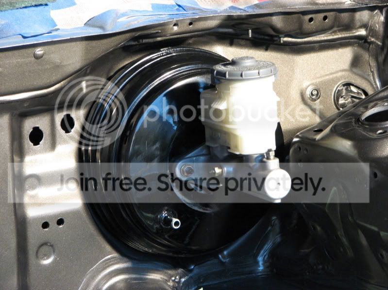

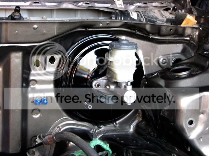

And threw it into the car:
I'm still going to buff it to bring out more shine when I get back from my vacation.
