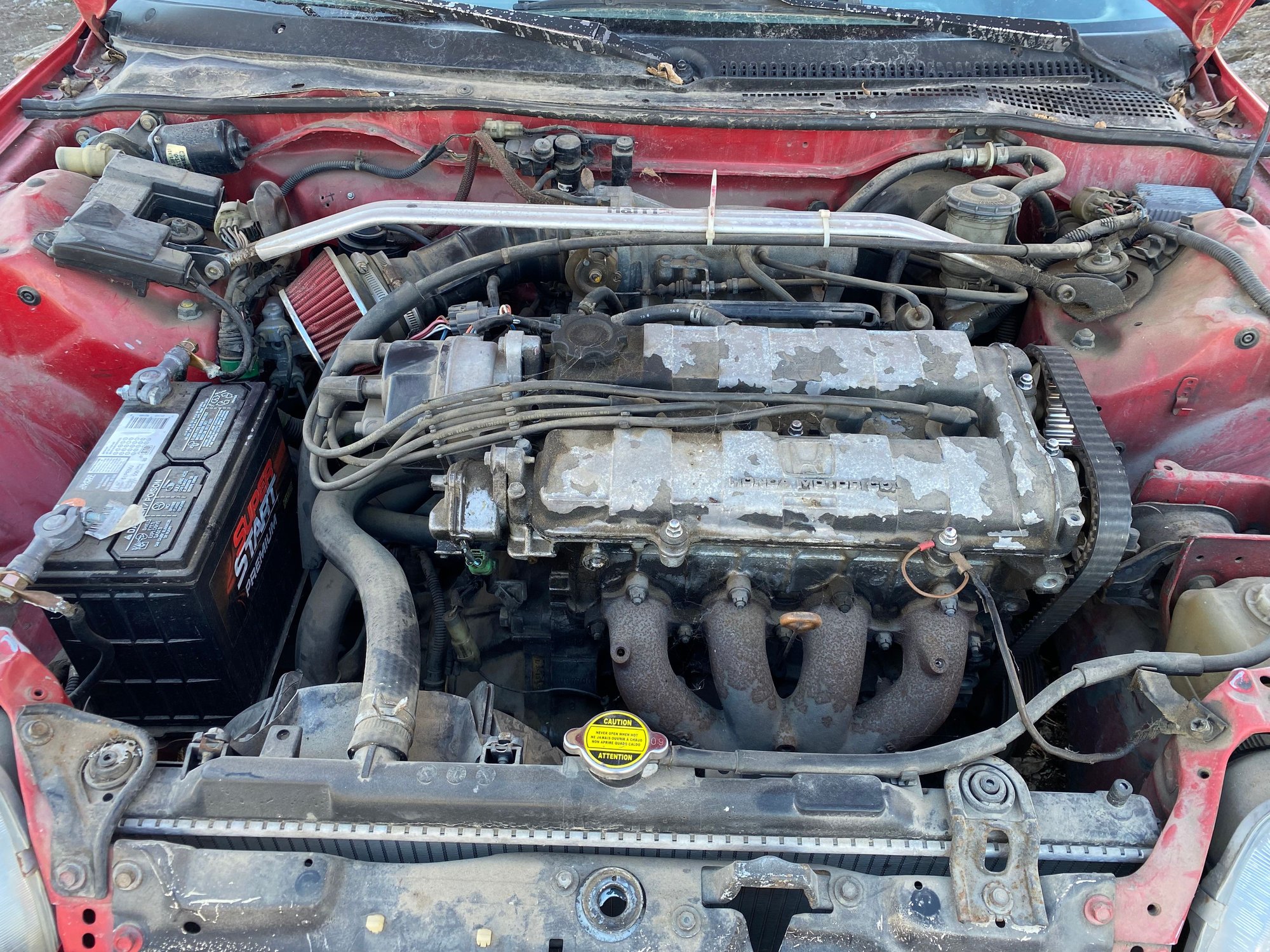

I recently bought a 90 hatchback civic with a non-vtec dohc zc motor and all I’ve found about it is this thread of you referring to it as the originally imported zc motor.. any chance you can point me to a engine code location? I’ve tried the serial number with no luck.. just trying to figure out if it’s the motor I think it is

The point of this thread is that there is no engine code on ZC stamped engines.
What color is the DOHC valve cover? Black or brown?

It is black, very very faded black haha

It is the "black top" or "3rd gen" version. Aside from the "black" valve cover, the easiest way to distinguish is by the valve cover, the Honda H is over the exhaust cam and the valve cover bolts are on the outside/perimeter of the valve cover where as the older version had 4 bolts going through the middle (over the cam caps).
