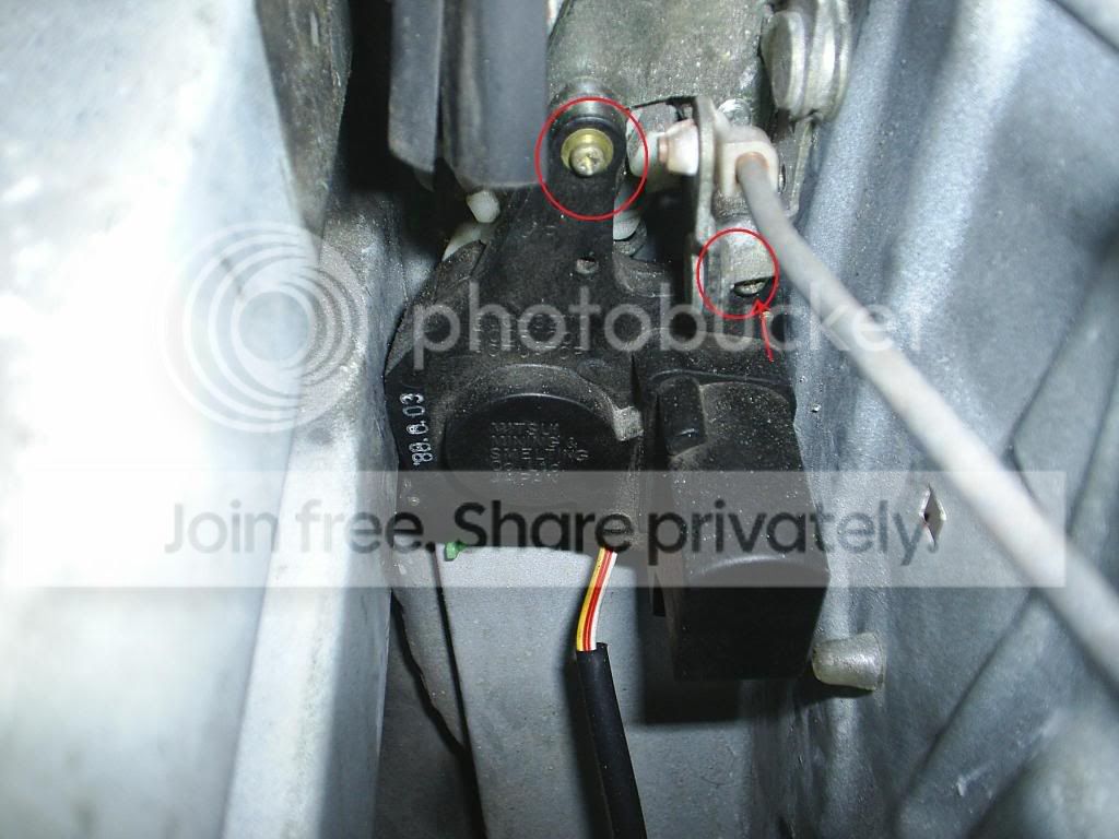

ok here is the way i did mine i went to the junk yard and grab the factory lock actuators of a 4 door ef with power locks of course you just need the actuators not the latch.it all bolts up. take the latch and actuator out of the donor car and you will see 3 screws holding the actuator to the latch remove and save. also there is a little plastic peice that you have to wiggle free change over to you stock latches and then all you have to do is install you alarm and run the correct wiring to the lock side note there is only 2 wires to the actuator one is going to get power and the other ground to lock then you reverse the 2 and then it will unlock. i can upload pictures of them already installed in my doors but i didnt take pictures when saping everything over. i am willing to do a wright-up on this is more people want me to. if you have 88-89 door some of the plastic case of the actuator need to be trimed i never try on a 90-91 door but i thing you shouldnt have a problem.
also if you wanted try taking out the rear door actuator from the 4 door ef and see ifs smaller i just modified the front ones i got. i need to upload the pictures i have to photobucket.

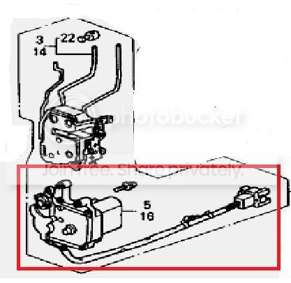

Ok what I did for Power door locks on my CRX
Tools needed
Phillips Head Screwdriver
Wire Cutters
2 SPDT 30a Relays or
Factory power door lock relay
and any other tools you think you might need.
Start off going to the junk yard and find a 88-91 Civic 4 DR
I took the Front door latches out with lock actuators. i paid a couple dollar for the latch and lock actuators i also took the main door harness so this way i didnt have to run wire to the doors all ghetto, plus i also have power folding mirror so it just makes for a cleaner install.
Remove the door panel on the donor car and remove the 3 screws hold the latch and lock actuator in also disconnect the levers for the outter door handle and lock and also the inner door handle.
Remove the latch out of your car and lay side by side there you will see the 2 little screws the need to come out next.
Next seperate the actuator from the old latch if you didnt do it at the yard.
all thats next is to put the actutor on your old latch and put it back in the car.
I had a little probly with the actuator fitting in the 88 doors i have on my car so all i did was file down the outter plastic case alittle.
I had a idea after the fact to try and see if the rear doors on the 4 door civic actuators would fit and it they are diffrent shape.
I dont belive anybody should have a problem with 90-91 doors as there are a little thicker in the rear for the seat belts.(but i have not tested this out i just modified to fit my doors but after installing and testing everything works perfect.
Honda uses a two wire actuator so i am posting a wiring diagram
also i didnt install any switches inside the car as i didnt want them all you will need is the wiring diamgram and switches and some time wiring them
if there is any other questions let me know i will try and answer them
The alarm i am using is a Code Alarm model ca160 i have the diagram for that also but i figure all alarms with be diffrent.
