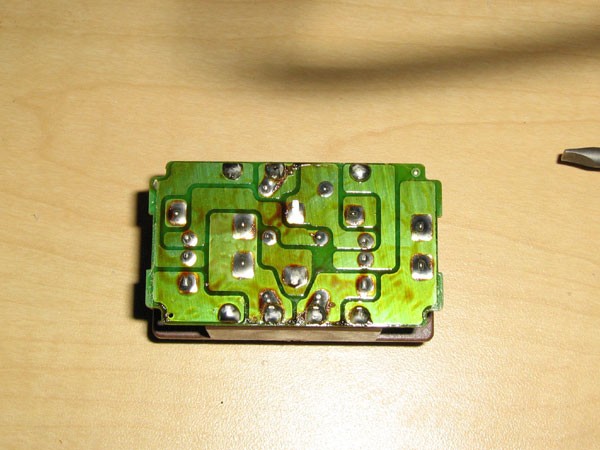

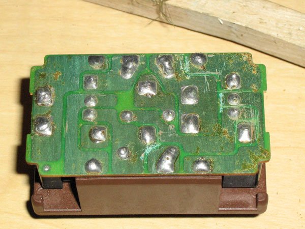

i resoldered my main relay tonight. that did NOT fix the problem. however, i think my ignition switch is the culprit. i can put it in the auxiliary position, and nothing happens sometimes, other times it acts just normal. i can start the car and it will stay running, but i can shut it off and try to restart it and it is just dead. it has to be the ignition switch. i just hope it isnt too expensive.
i guess this ignition switch thing kinda makes sense, because i think my car has had to have been re-keyed atleast once for sure.. because my normal ignition and door key does not work on the hatch. the rubber boot that usually is around the ignition switch is missing on my car, and the upper and lower steering column covers are broken and dont fit together like they should.
i need to run a car fax on my car, because it seems like it may have gotten stolen in the past. i dont have an s on my title though, and i register it just fine.. soo..
here are some pics of before and after of the main relay. i didnt de-solder, i just added some solder over the old joints.. pretty ghetto, but i guess the main relay wasnt the problem in the first place.
before, not pretty..
after, yeah gross.. but it works..
