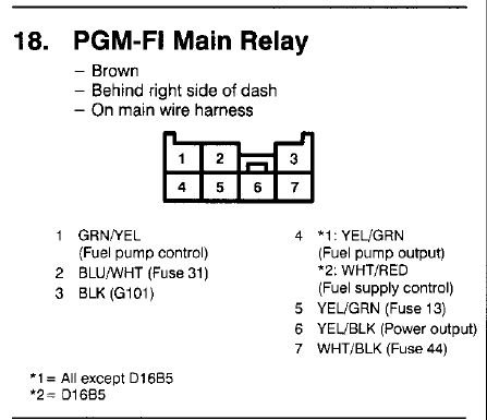

Unplug the main relay and test whether the main relay connector gets battery voltage from both fuse 44 and fuse 13.

Test whether voltage from fuses 13 and 44 reaches the main relay connector.

Where is the main relay? Ive been looking and cant find it

Default Re: no power to ECU, 2000 civic
Right of glove box.
The main relay connector:

Figured it out. Fuse 44 was blown. I had only checked the ones under the dash.
