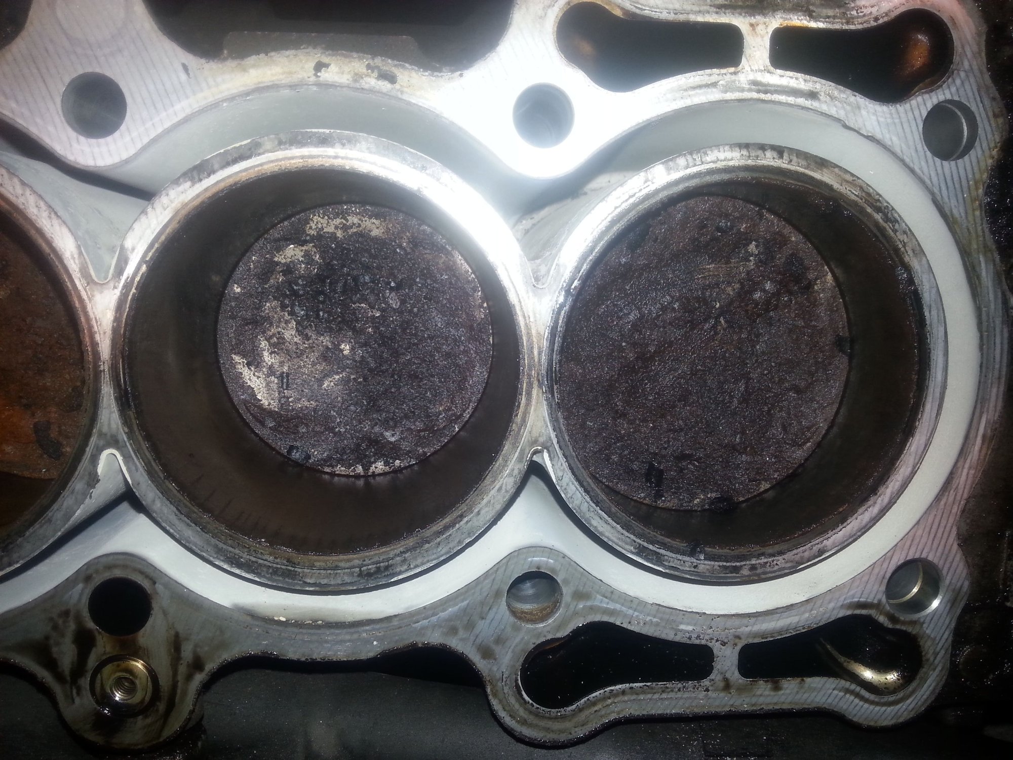

Okay so I finally got it loosened up and this is what she looked like inside:
Ugh! Gorgeous right?...
rust...
rust...
and more....
RUST!
At this point I'm thinking I just lost 40 bucks, no biggie. But then I remembered that the block needed to be overbored for this build so maybe I could get past the pitting in the cylinders? So off to my machinist to see what he had to say. And around that time some packages arrived.

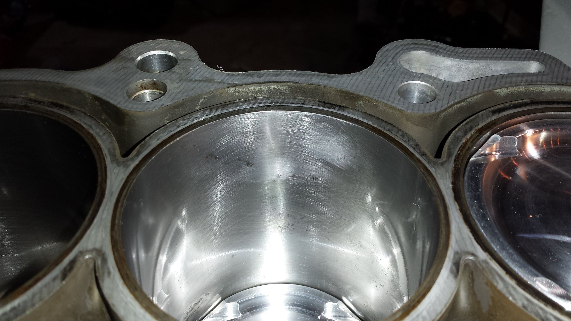

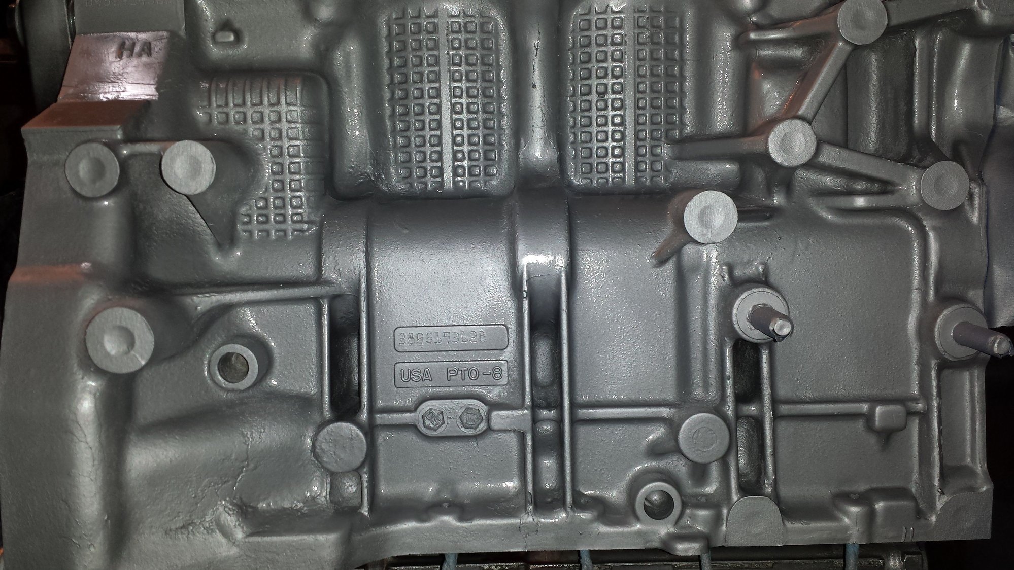

My machinist says, "It's a go" and that with a half mil overbore we should be good so I left it there and waited for a phone call (Which took FOREVER). And about idk 3-4mos later?... It finally came. Now all I had him do was the overbore, hone, hot tank, and ring gaps. Money was tight and I don't have access to those types of tools, but plz believe if I did, I would've done it ALL myself. I didn't have the head worked at all because it's pretty much scrap. But I did keep it and that's an ongoing project in my garage. But I won't be using it for this build, instead I'll be using my current head off the stock B1 which is in the car currently. Also I didn't have the block shaved/decked because... well it just didn't need it! It was dead nuts straight! No warpage and completely within specs, so why spend the money right? Anyway, for whatever reason, when I got it back I didn't have the foresight to take any pics of the bores and immediately began cleaning it so here's what I got:
This was straight from the machinist.
Cleaning main threads and oil holes.
Looking good

Pistons and rods are in...
Main bearings, crank, rod bearings, and rod caps...
all torqued down to ARP specs.

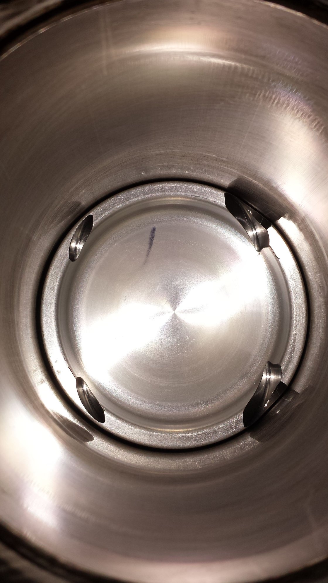

A closer look at cylinder #3...
and #2.
Main bearings, caps, and girdle all torqued down to factory specs.
Overhead of cylinders 1 and 4...
close-up of #1...
and #4.
An overhead of all four cylinders with the pistons at half mast.
And here's a shot of the right side plate with the new rear main all buttoned up.

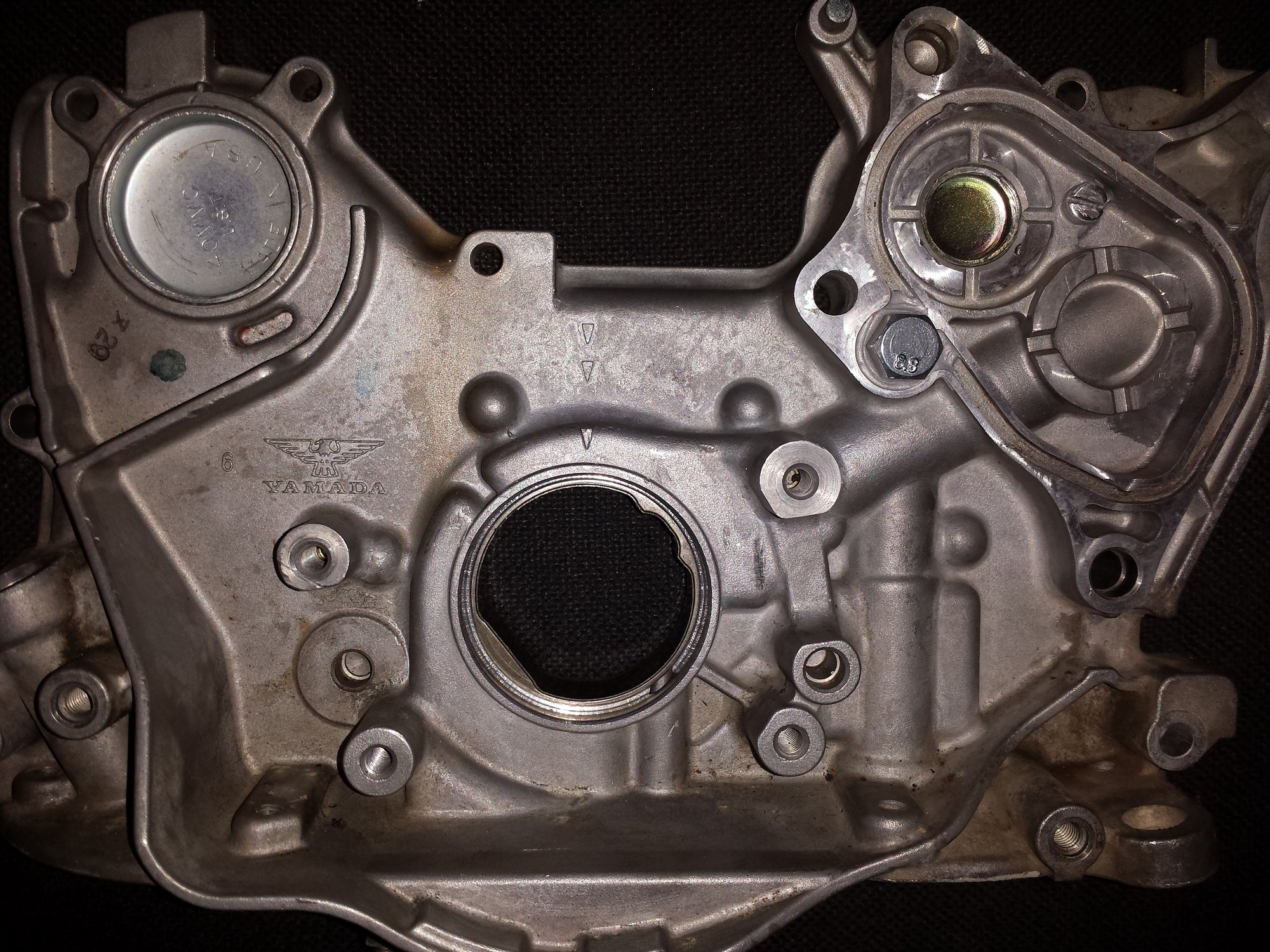

Now, this is basically where I'm at currently. I was going to reinstall the balance shafts along with the oil pump but when I got to checking the rotors and housing the wound up being right outside of the service limit:
Oil pump housing with rear balance shaft....
and a close-up of the pump rotors (inner/outer) which were out of spec.
It was actually looking good until I checked the clearance between the outer rotor and the housing... FAIL. So I began looking to replace the rotors (per the service manual) and of course Honda discontinued them, forcing everyone to buy the entire assembly for right around $200 that I don't have. The rotors btw run you right around 15 bucks a peice. Luckily I was able to find an online distributor that still had some new parts in his OLD stock and I'm pretty sure I can get the rotors if need be. The hard part was finding the part number which I had to get from an older NON-Vtec F22a1 diagram. All the pumps on the F blocks are the same part number so the rotors should be the same also. I know some folks think there's a difference between the Vtec and non-Vtec oil pumps but from what I can tell that's not the case with the f-series. And if there is a difference it won't be in the housing or rotors, it will be a washer applied to the relief spring. Anyway, the only reason i haven't ordered the part yet is because during the time I was thinking I could no longer buy one, I figured I'd just use, or mix and match parts from, the pump on my current motor, until I have one that's within the service limits. I already plan to use the head, most if not all of the sensors, the water pump and timing belts (which were recently replaced) along with all of the accessories, so why not use that too!? If ain't broke... right? So yea fellas that's where I'm at today. I still need a cheap yet functional turbo, intercooler, manifold, wastegate, BOV, injectors, and an ECU! All of which I'm really not sure I'll be able to afford before the current motor dies on me? But I'm keeping my fingers crossed

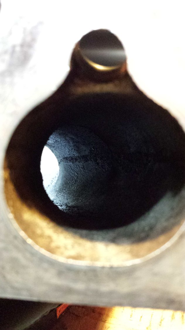

And here's the lovely PIT I found... it's the tiny speck directly to the right of the pencil, which btw is there for a point of reference. I figured EVERYONE knows how big a standard #2 pencil is... But I'm sure someone will shock me? Lol! Anyway, here it is...
Close-up...
And from here it's so small you really can't see it, even with a 14MP camera.

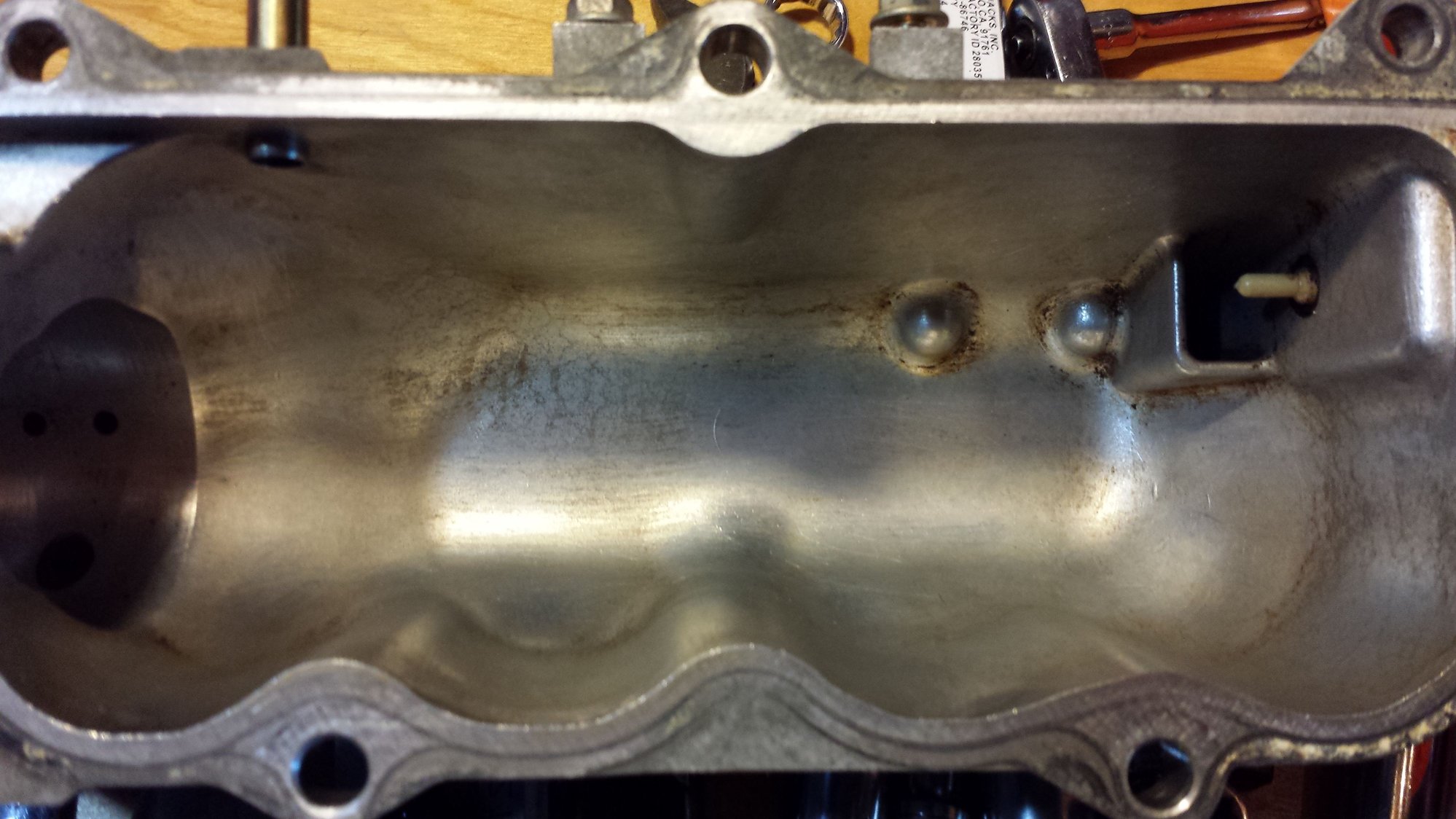

Minor update... Worked on the F23a1 IM a bit over the weekend. It was a MESS, to say the least. I forgot to get pics of the initial opening and the upper plenum, but if the lower plenum is any indication of how bad it was then I'm quite sure you can imagine what it looked like (plz imagine the worst). So here are some pics of before and after. There's still a bit more cleaning to do, and then some deburring, mild porting (I wanna get rid of the huge casting lines), and of course port matching the TB/upper plenum and runners/head. I'll do my best to document the journey.
Here's how she started when I pulled off the upper plenum:
And after some significant elbow grease, mineral spirits, and Brakleen...
Here's one of those casting lines I spoke of.....
EGR ports still need more work. The rectangular one runs just about the entire length of the runners and is a PITA to get in to. This is after 30mins with a rifle brush and the entire gamut of chemicals/cleaners I had available to me. It was SO gunked up in there that it may very well have been blocked off completely!?
Upper Plenum...

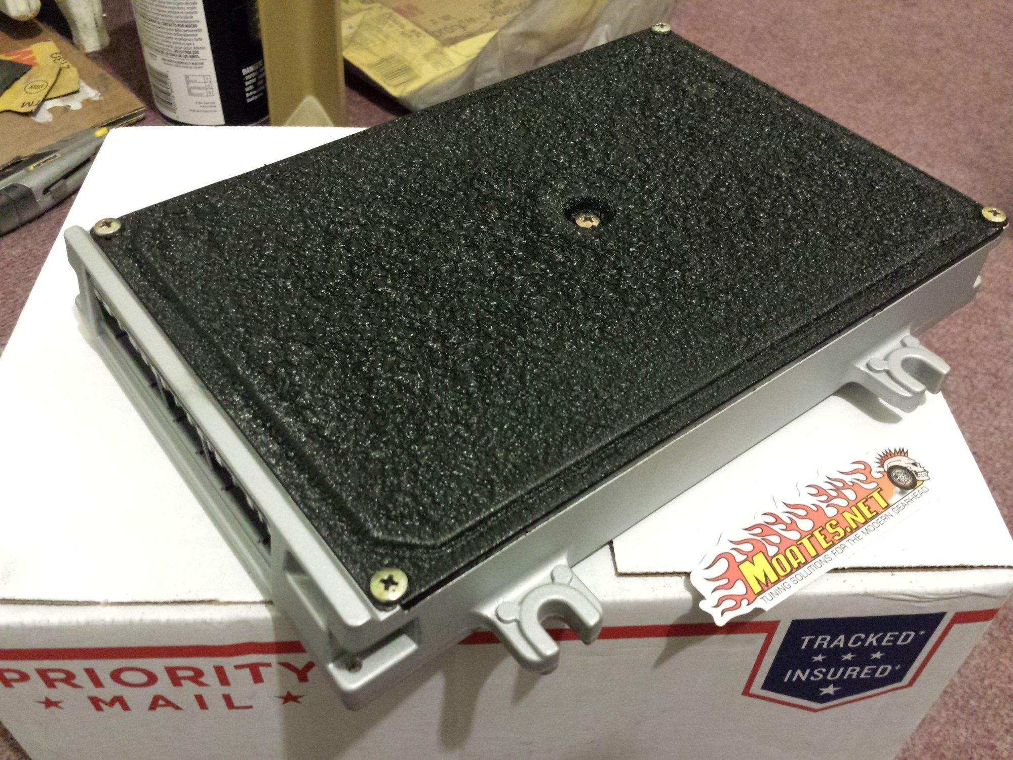

And last but not least, I got my Moates Demon v1 on the way! I picked it up dirt cheap. And I plan on using that to run Neptune RTP (per strong recommendation from BoostedCD5 and a ton of research, good reviews, ect..) on a P28 ECU. I'm hoping to have the motor in and running (w/o Boost) by Thanksgiving and the turbo setup pieced together and any engine quirks sorted out by the New year.

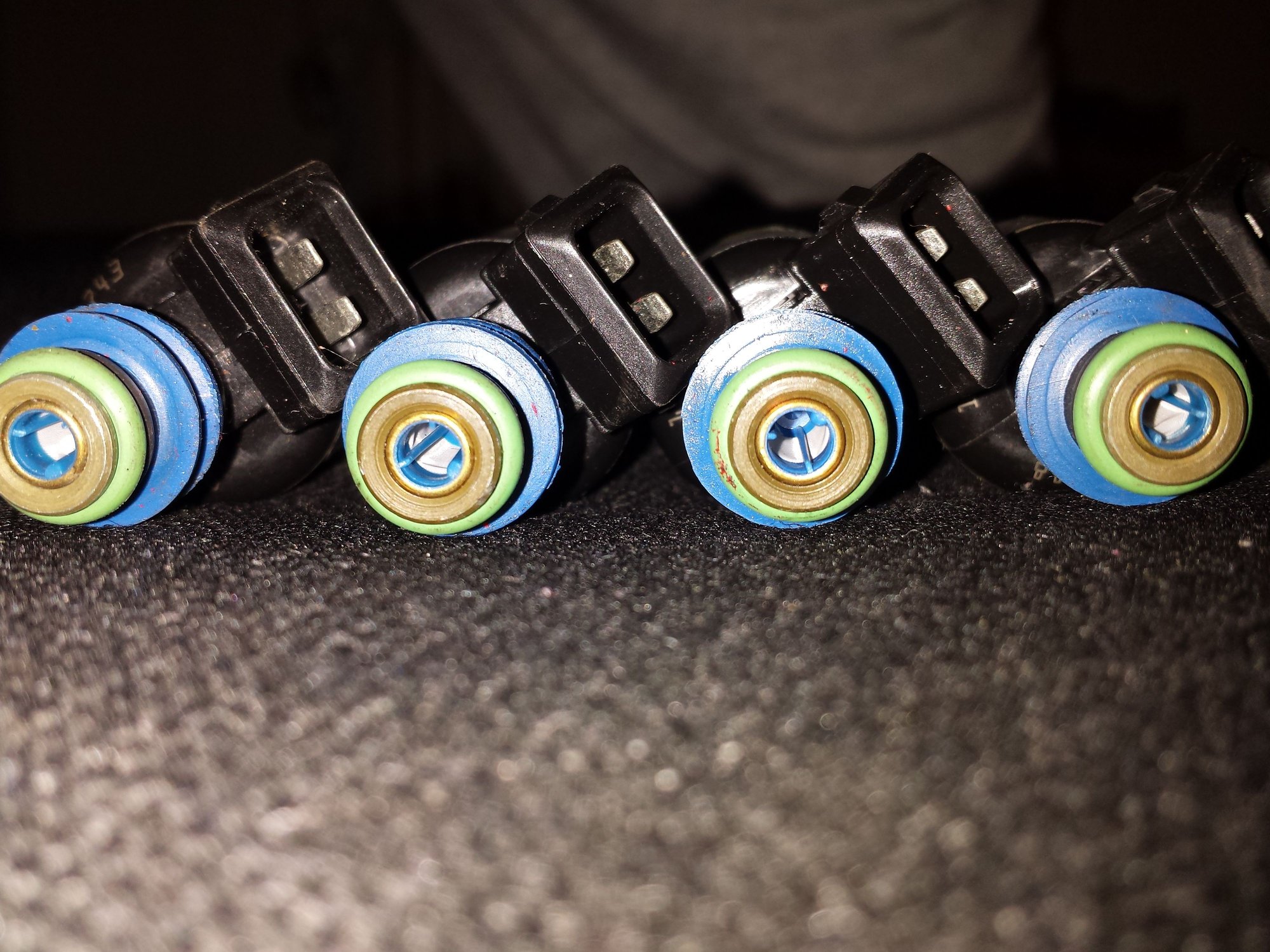

Real brief update on the oil pump and some injectors I scooped up. First will be the injectors I really didn't know how to tell if they were good or bad but I know they retail for a good bit more then what I paid so I was a bit apprehensive to say the least but I grabbed them anyway and hopefully yall can tell me if I made the right choice (pics to follow)? And as for the oil pump well you guys know I went with the F23A pump and I did the cheapo balance shaft delete so I just wanted to point out a few differences in the F22A/B's pump vs the F23's because one of them caught me off guard while following the DIY BS delete. Also got the BWR adapter for the F23 IM. And the Vision headlights. So here come the pics...
First the DSM 850cc injectors (which I just realized DON'T seem to fit my IM?!)

And oil pumps... so first is the F22A/B and right after that will be the same portion but on the F23A pump. It's the location of the rear balance shaft and on the F22's it has a removable press-fit bearing that once removed leaves a hole the size of a 1in freeze plug BUT the F23's pump DOES NOT. The bearing is actually PART OF the housing itself!? It's literally built into the oil pump, so in order to do the DIY BS delete using the F23A oil pump you must find a 21mm freeze plug (Not that easy btw) in order to block off that hole. Or of course, if you have the resources to do so, you could just mill out a piece of steel or aluminum to fit over that entire section like the KS BS delete kit does... I don't have those resources. Ok so just to reiterate 1st F22A/B (with bearing removed), 2nd F23A (same portion as F22), 3rd F23A (close up)...
Now these are the F23A pump all tapped, plugged and sealed and ready to go on the motor.

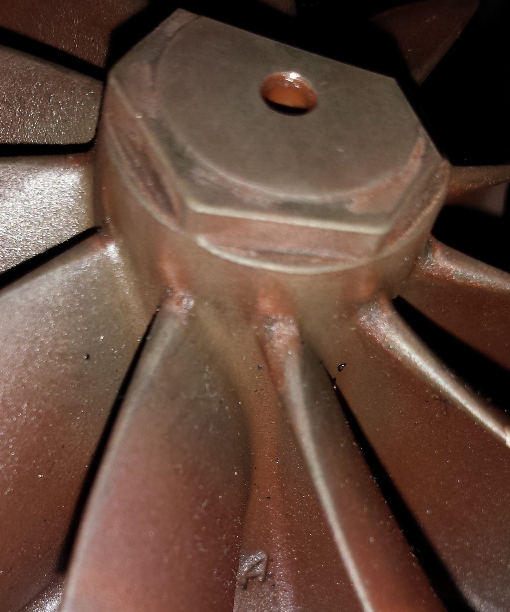

Oh and I'm still trying to decide on a good street turbo? Anybody? 16G? Hx35? 50 or 57 trim Garrett? Suggestions? Quickest spool in the 300-350HP range... That's what I'm looking for.
And can anyone verify for me if those injectors should fit? They're for a DSM Eclipse/Talon 4g63 but when I put them in my IM they were really loose? Am I missing something? Thx in advance.

I LOVE the look of those FIC injectors!

I didn't take pics but I might later?... I found some VERY small hairline cracks (if you even want to call them that?) in the surface of the OEM flywheel, which I just had resurfaced like a little over a year ago, so I was forced to pick up a new flywheel to add to this.
I was impressed by the overall build quality of the ACT disc and pressure plate....
BUT (and this is a big BUT) I was also a little surprised to see the paint chipping off of the PP before it even saw it's first engagement!? And there was a small (maybe quarter the size of my pinky nail?) but still noticeable chip on the edge of the clutch disc itself!? (No pic) So yea I was a little bummed about that but overall good solid stuff from ACT. I'm sure neither thing will affect performance/functionality at all.
