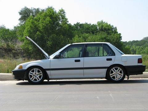

the pink is for memory of my aunt that passed away from breast cancer me and my father had built the car in her memory, now the blue and pink are for both of them since he passes away of colon cancer. his goal was always for the car to go low 10s or a high 9 so that's where I'm heading with the car and build.
car sits at 440hp right now. made 567 before then ran out of fuel.
its going to TURBO ELEMENTS here in a week or so for a new coolant reservoir, hood lashes, dual pump install , front bumper bracket so it don't sag, new top mount manifold and hood or side exits and solid mounts inserts.
car was sold at one point after my pops had it after me and I recently got it back for his memory after he passed.

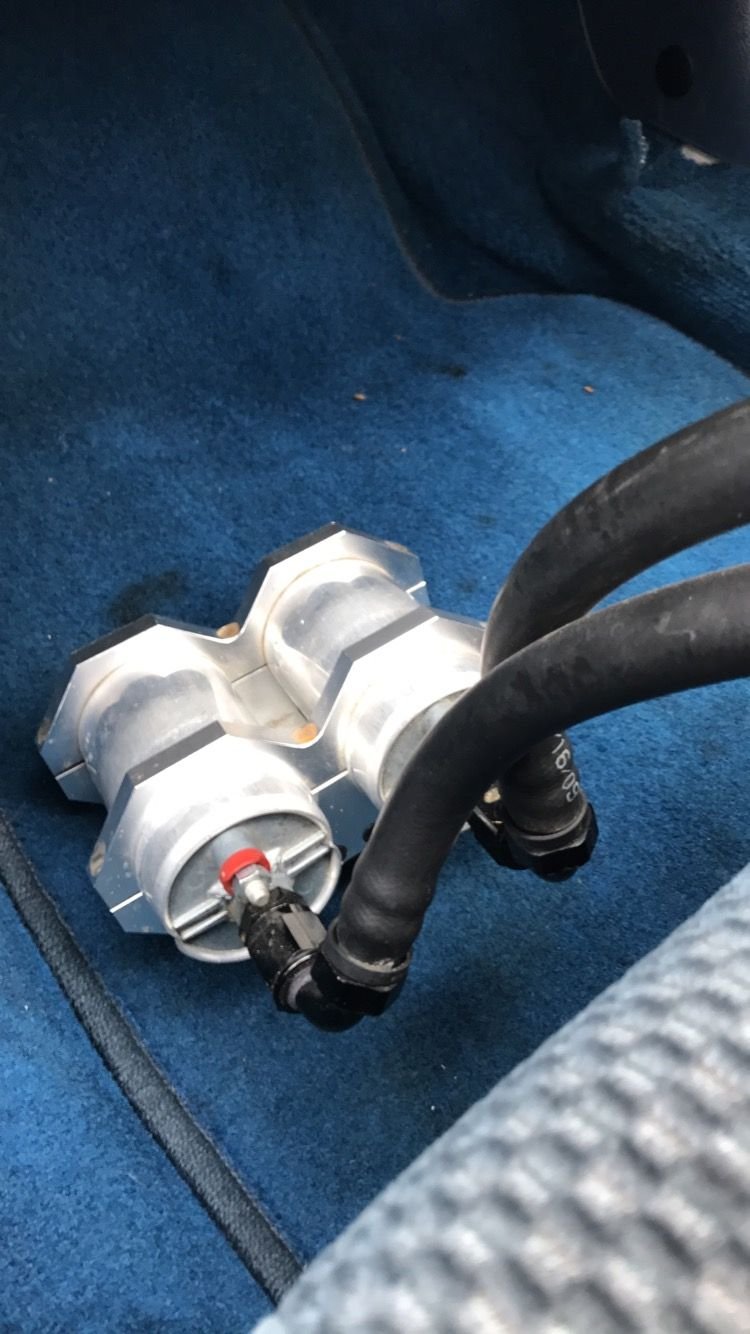

new fuel filters were done and injectors last week (jan-2017)
