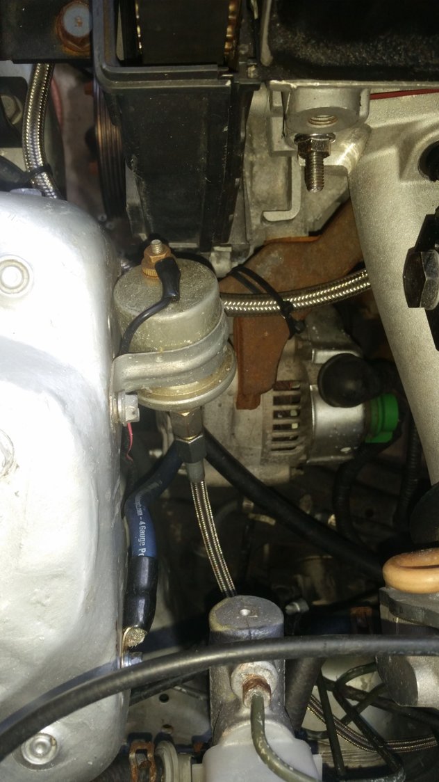

I run this fitting, it's made out of stainless and I use it for turbo oil feed, aem oil pressure sensor, and oem oil pressure sensor. If I would have known about the one posted above at the time I would have probably gone that route. Although mine has been leak and trouble free so far.
1/8" BSPT Oil Pressure Sensor Fitting,Gauges, Sensor, Turbo Oil Feed, Toyota eBay

Old 01-19-2017, 02:51 AM
