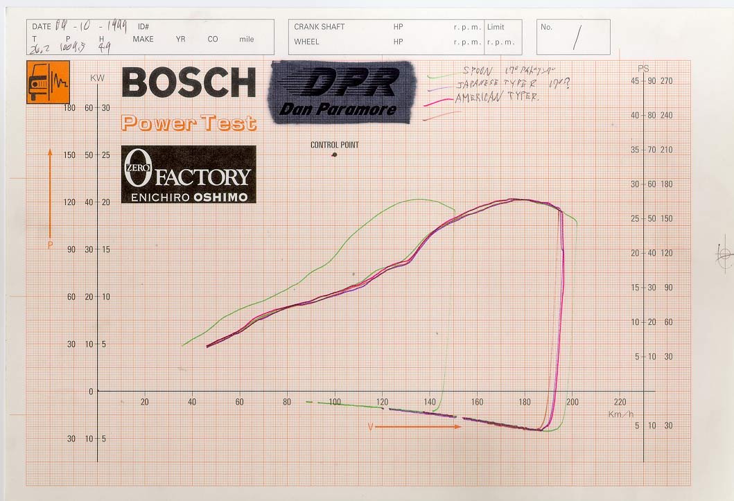

Re: ITR cams in GSR with stock ECU?? (GOLDBERG)
<TABLE WIDTH="90%" CELLSPACING=0 CELLPADDING=0 ALIGN=CENTER><TR><TD>Quote, originally posted by GOLDBERG »</TD></TR><TR><TD CLASS="quote">is there any difference between the usdm and jdm itr ecu?</TD></TR></TABLE>
Yes, the US P73 ecu will make a tad more power over the JDM P73.
I've dyno compared either type's of ITR ecu's on a friends stock '98 US ITR back in '99.
Here's the dyno graph:
http://www.ff-squad.com/tech/d...o.jpg
(ignore the single green line on the graph)
The dyno test was comparing an OBD2 Spoon ecu, US & JDM ITR ecu's.
The OBD2 Spoon ecu pretty much prevailed over both ITR ecu's.
In contrast, there *may be* different dyno results if using a stock JDM ITR engine with a JDM + US ITR ecu & spoon ecu.
