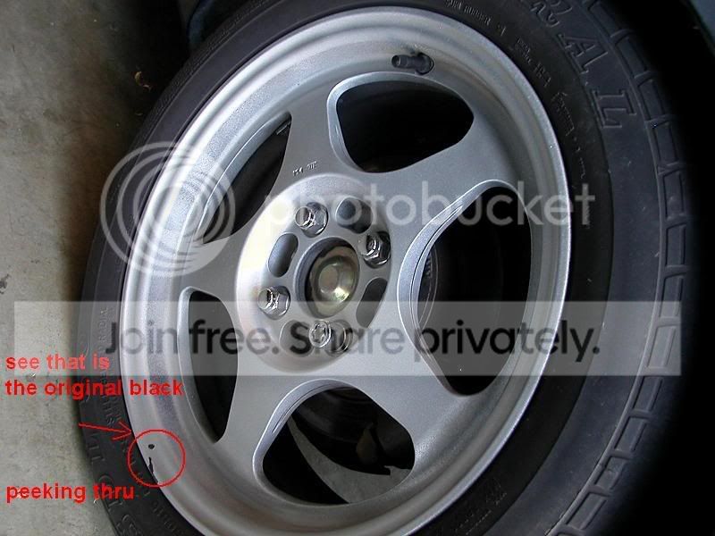

so i got rota slipstreams, my friend that i bought them from, had painted them silver (from the original black), (i think he used duplicolor wheel paint)
i want them to be black again, (or white, not sure what i want)
so my question is, what should i do?
i don't know if paint remover will take out the silver as well as the black underneath, so id like to know what other methods i could use,
what would be the easiest method, sanding? powder coating? i dunno really. so any help and suggestions, or experiences would be great thanks.

just strip them completely and then respray them black, that way it will be a nice even coat of black

try first to remove the grey paint whit a solvant that is not so strong like paint striper maybe you can save the original black that is shurely powder coated!
you can't powder coated whit cheap paint underneat!

if you can find something not too harsh that starts the peeling process, do that, then take a pressure washer to them, paint comes right off under pressure washers. im still struggling with mine though.

air craft stripped, pressure washer, elbow grease.

try paint thinner,air craft remover will strip the original finish aswell

i think i seen a guy here use the nail polish remover over his evo regas painted black.

thanks for all the advice, ill just strip it completley and repaint, im thinking white...
