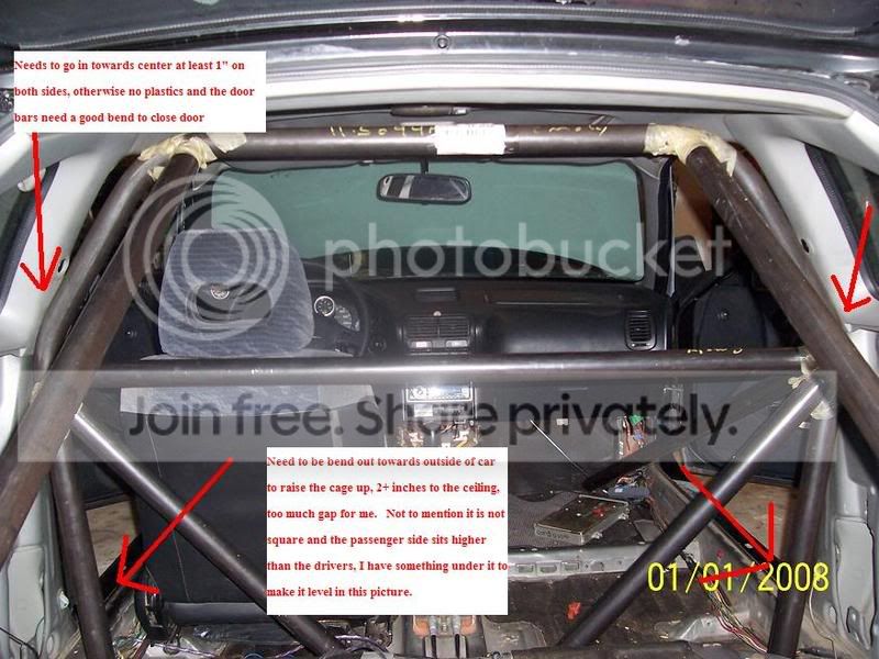

this is what i bought for my 1998 jetta....
you can see its a very very basic kit. no special bends. just the minimum.
i ended up going to a local hot rod shop, and they tweaked the kit to fit real well.
i ended up saving like 200$ by buying the kit, rather than just having the shop bend one up. the kit was like 600$.(moly). i just got a main hoop, rear legs, harness bar, and door bars. the door bars and rear legs were perfectly straight.
the main hoop was very basically bent, and short, way short....
they would have done a straight up instal, but the fitment was crap. it would work....but when you figure your gonna do it once, why save a few hundred???
just get it done right and nice.

I think they are a hit or miss man, my hoop was way to wide at the rear pillars, it hit the metal underneath the plastics and had to be bent in, it was also really short and dog legged in alot at the bottom, it was also slightly out of square when you lay it flat but that could of been the shippers fault. It has taken alot of tweaking to get my hoop to an install ready status

The widest part of the hoop is just flat out too wide, it hits the vertical quarter window pillars, which unless I am 4'6 makes the car undriveable because the seat is too far forward. Funny if you look closely, you can see it is out of wack, look how level the harness bar is in relation to the bends on both sides of the hoop.
after having to mess with this ****, I couldnt even imaging trying to assemble a 10pt from them.

well, look at the pictures of the main hoop in my jetta above....
does that look good to you?? its a solid 3in at least away from the roof, and a solid 2.5 on BOTH sides.

looks better than the one sitting in my garage, atleast you can get yours in the car.
