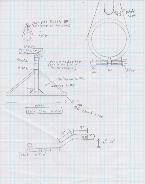

I've been thinking of a device to tow small cars with all four wheels on the ground. Like the RV'ers do that would bolt to the factory tow points on Honda's and most other imports.
But lack of time, metal and a welder have prevented me :-(
Your welcome to build it and let me know how it works ;-)
