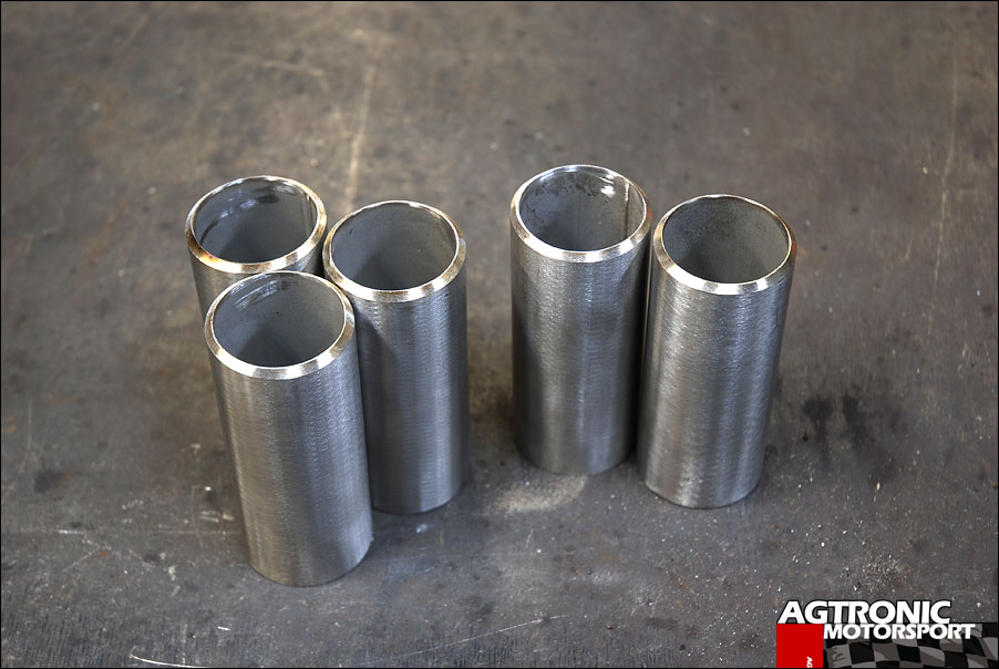

Old Oct 19, 2011 | 03:24 PM
Agtronic's Avatar
Posts: 988
From: Montreal, Quebec, Canada
Default Re: pipe beveling
I always used my belt sander and rotate the tube carefully by hand. Then give it a quick touch to give it a flat "seat".
how are you cleaning your pipe so shiny
Old Oct 19, 2011 | 04:50 PM
Mr.Burner's Avatar
Posts: 151
From: Arizonian
Just get a wheel for stainless on your bench grinder and it works wonders for polishing.
I just use the side of my chop saw to bevel the edge. Works good for me.
