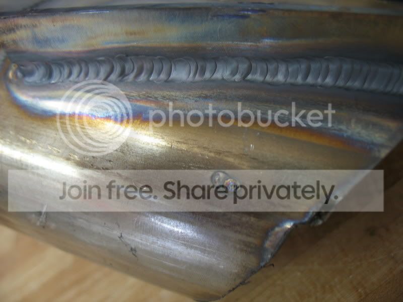

For certain welds (like pictured) I'll actually "pen hold" the torch up near the cup, then just rest my hand on the material. Your consistency (width) is what appears to be the issue, but it doesn't appear to be because of unsteady hands. Your weld is hot, and your fill contributes to width consistency.
It just appears you have a mixture of problems, that aren't significant really, but since they're all together that's what you got. Work on better heat control, hand stability, more consistent and quick fill (from a low approach angle when poss.), and maintaining proper torch angle.
Keep practicing...you'll get it.
