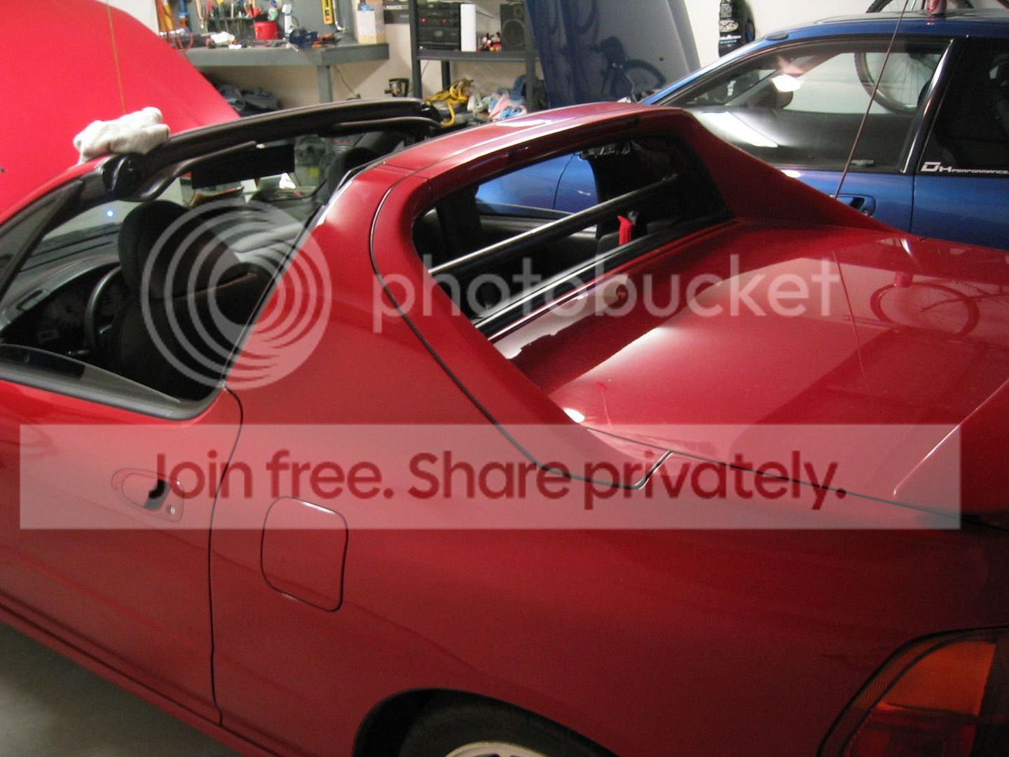

made this bar for a friend out of 1.5" DOM tubing, said it stiffened the chassis a lot.

This is a known trouble with del sols.try the bar as suggested stich welding will also help

Make a pillar bar like the one pictured, it should help. I have seen a bunch of people "stich weld" all the rear panels on Integra's and Acccords to help body roll, not sure if that's gonna help much on you sol or not. If you want to try to do a bar this weekend let me know, I've been wanting to do one for the teg as well.
Also some strut bars may stiffen things up a bit.
