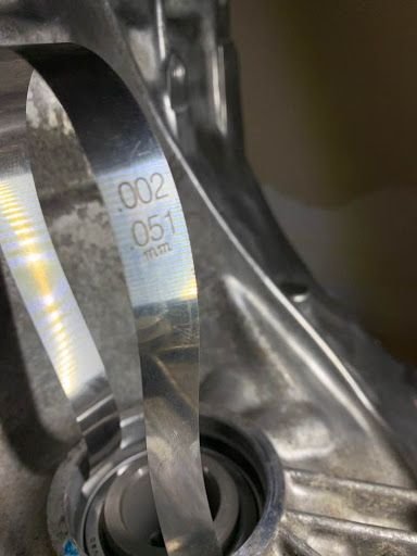

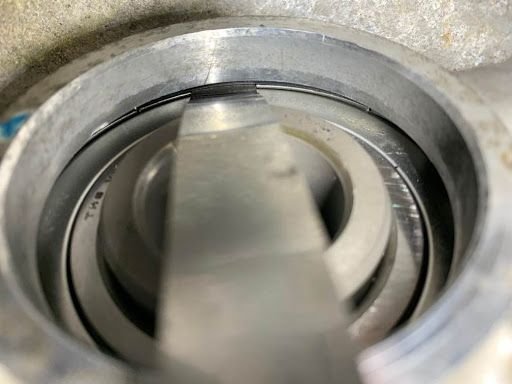

Ok so I got it buttoned up. I ended up using the 1.2 mm shim and came out with .051 mm or .002 in of thrust clearance. A few pics for ref.
Something that others might find useful... once you have some clearance, go straight to your .004 feeler and see if it fits. If it does, go up in feeler thickness until you get drag. Take the difference in thickness between your .004 in gauge and the thicker gauge that currently has some drag, then add that difference to your current shim thickness. Once you have done that, you will have the right shim thickness part number to select to get thrust clearance between 0-.004 in. (Kinda like JR says above )
just enough drag on the feeler
Thanks for the help to those that posted in the thread, much appreciated!
