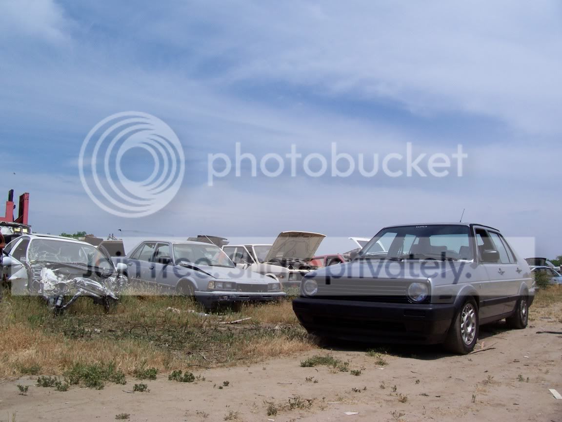

thanks alot for the help guys... and hmm just for the hell of it i'll post a pic of my VW Jetta GLi
that is a pic i took of it today when i was at the JUnkyard getting parts for the honda haha yeah i know u guys are probably thinking that deserves to be in a junkyard but nah, i love my VW
