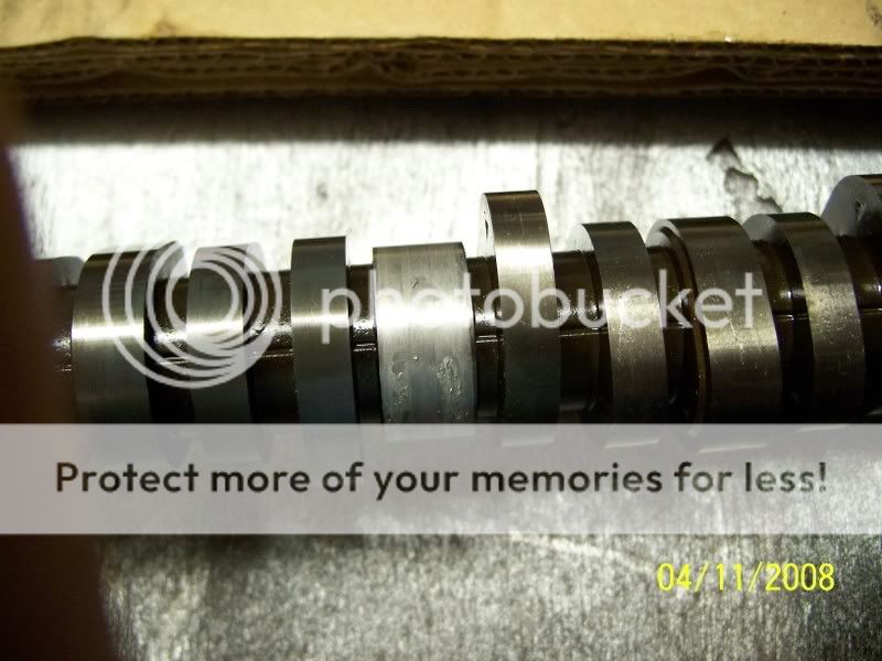

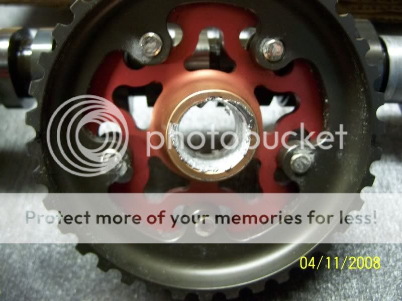

After putting about 2 miles on my re-built Z6 motor, the car shut off. I saw that the cam gear was sheared off the camshaft.

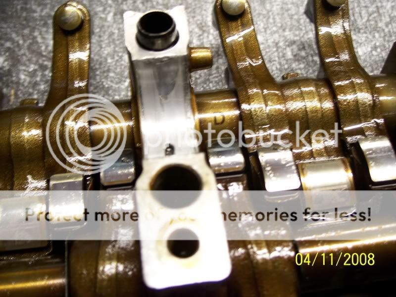

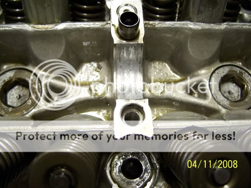

I pulled the V/c and noticed the cam was damaged and so were the caps and the head itself.
Has anyone seen such a thing before? There was oil in the head, and it was torqued to specs. Any ideas why this happened?

I used assembly lube, and primed the engine by cranking it with the dizzy unplugged. Everything was torqued to Helm manual and it seemed to turn fine.
Upon further inspection the other journals look scored also. I should have plastigauged it.

I bought the head used, and I had the machine shop check to see if it needed to be
milled. I did not give him the rocker assy with the caps. It is possible that the caps were off of a different head. I learned the hard way that
the caps are Not interchangable.

Default Re: Camshaft seized? (1991civicsi)
Bearing clearances could have been extremely tight, not letting oil in.
or
You mixed up the caps,which have numbers on them to show where they belong. Doing that, probably blocked the oil passage hole to the bearing that seized.
