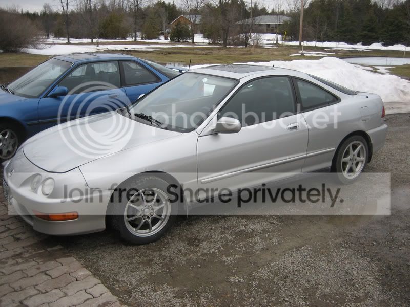

edit: problem solved, see post with car pic below.
'98 integra 3 door, bought it a couple months ago and now, right after i put the 205 16" performance tires/wheels on it the steering became all wonky.

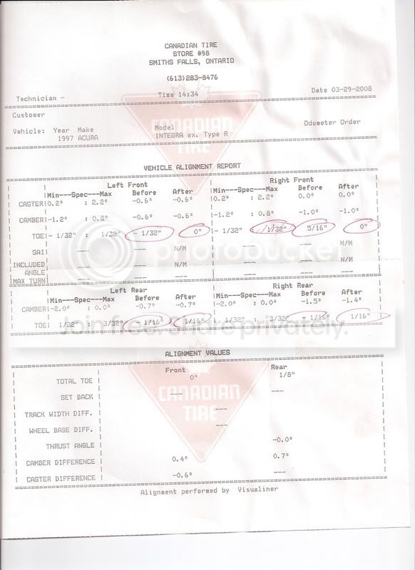

I got an allignment, didn't change anything, so i took it back and got it done again and asked for the specs, and this is the new sheet
Doesn't pull left as hard on the highway now, but its still a bit wonky on poor pavement. What could cause this?

Why is you caster messed up like that? An Integra should have around 1* on both sides, yet you only have 0 on the passenger side, and negative caster on the driver's side.
I only ask, because when I had an Ingalls camber kit up front with the sliding UCA bushings, I had wonky caster as well (low on one side and 0 on the other), and the car would wander all over the freeway. When I pulled those stupid things out, I installed a set of SPC UCAs, set the caster to 4*, and now have a very very stable car. Though, with the high caster setting, it does take a bit more effort to turn the steering wheel...
you may be on to somthing tho, i've read that negative castor can create that condition while using radial tires, and you can see that the minimum castor is+0.2 degress and i'm below it. front end collision?

I would still find out why your car has such a messed up caster setting. Especially negative on one side, thats seriously not good.
My first guesses (and I am no expert) would be bent parts, or a shifted lower subframe. Since both sides are off, I'd check the subframe first.
yes its no doubt front end collision related before i bought it. The car had been fixed up, but i can tell there's still a wider hood gap. As long as it drives nice with the proper wheel offset, and doesn't abnormally wear the tires, i'll likely let it go. this car is no spring chicken.
