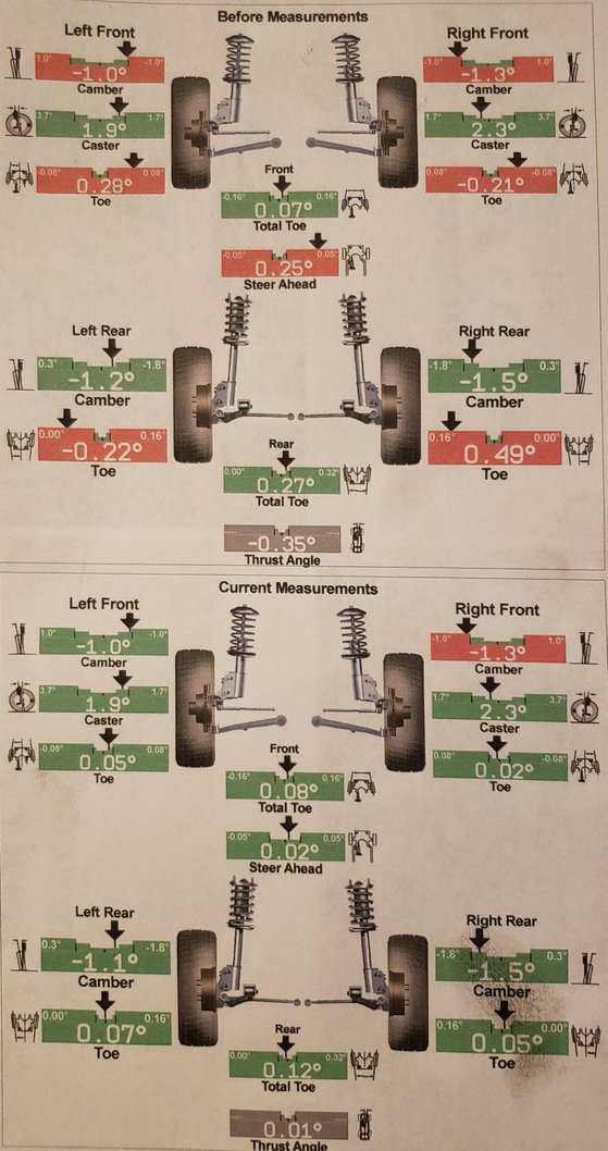

I had my 95 Prelude aligned today because it was pulling right, see attached alignment info before and after. The mechanic indicated camber is not adjustable on my car. The car is still pulling right a bit even after the alignment. Any suggestions on what could be going on? No accidents or harsh impacts and the UCAs are fairly new, ~20k miles on them.

i dont see a problem with your camber, despite the red.
i think the technician could have done a better job aligning the toe and adjusting for the caster difference upfront.
also, your tires are probably really worn in from the last alignment. are you still using them? that would affect how it pulls too.

Update: I swapped the front tires and the pull moved to the opposite direction....pulling left now. Guess it is time for some new tires which I have been looking to buy anyway.
