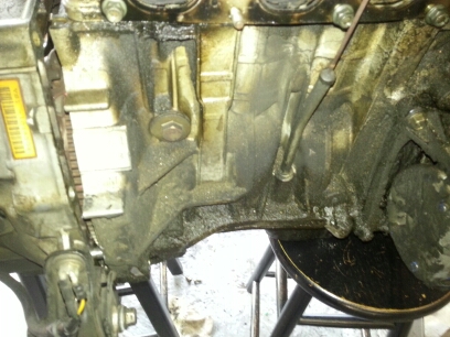

Well bad news, was at my shop and decided to look under the car make sure everything is fine.... well its not.
I noticed on the passenger side a section of oil coming from the output shaft. Well apparently the bearing is going bad since i can take the passenger axle right by the tranny and wobble it around a fair amount. There was a few drops of oil leaking from it, so we checked the oil level and it wasn't very low. So i topped it off. Looks like i'm going to have to find a used transmission soon.
looked online for rebuilt ones, almost $2000!
So, i'm going to look for used ones, and maybe rebuild this one later?

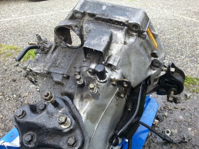

So I finally got to look at that transmission I bought for $150 from a guy on craigslist. He said it had 80k miles on it, that it had no problems and that the only thing i'll need to replace was just the axle seals. Which was understandable.
Well it seems like the guy was truthful, cause this thing looks mint! A tiny bit of surface rust but i literally rubbed it off. The magnet at the bottom was really cruddy so i took it out and cleaned it. But all in all, it looks great!
I think i'm going to clean it and primer it grey and call it good.

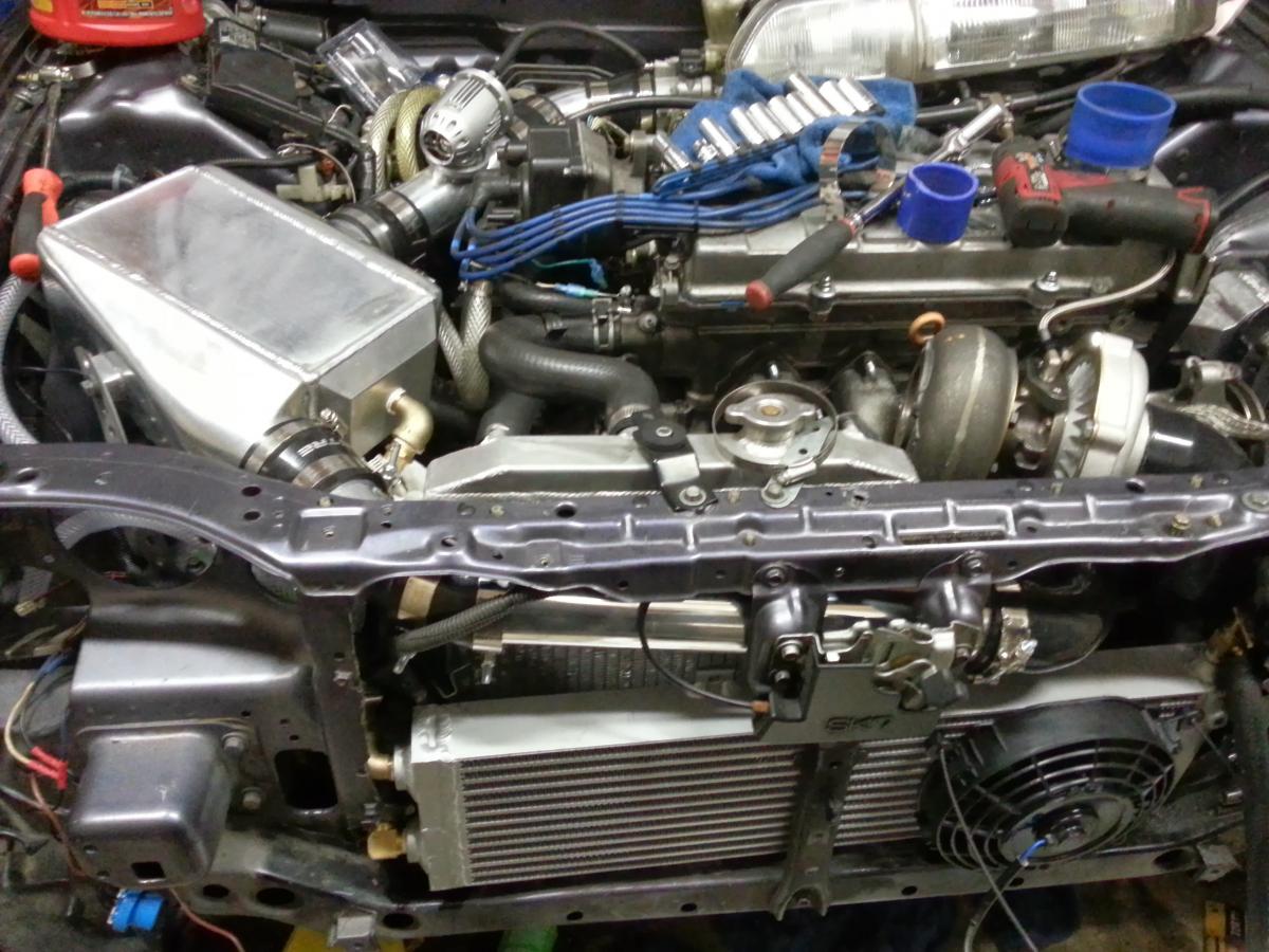

I will take more detailed pictures and explain my ideas i have, but here's the overview of all that came.
Was tearing down the engine preparing to pull it, so I figured I'd try a test fit... haha
It's a Spa Top Mount Manifold

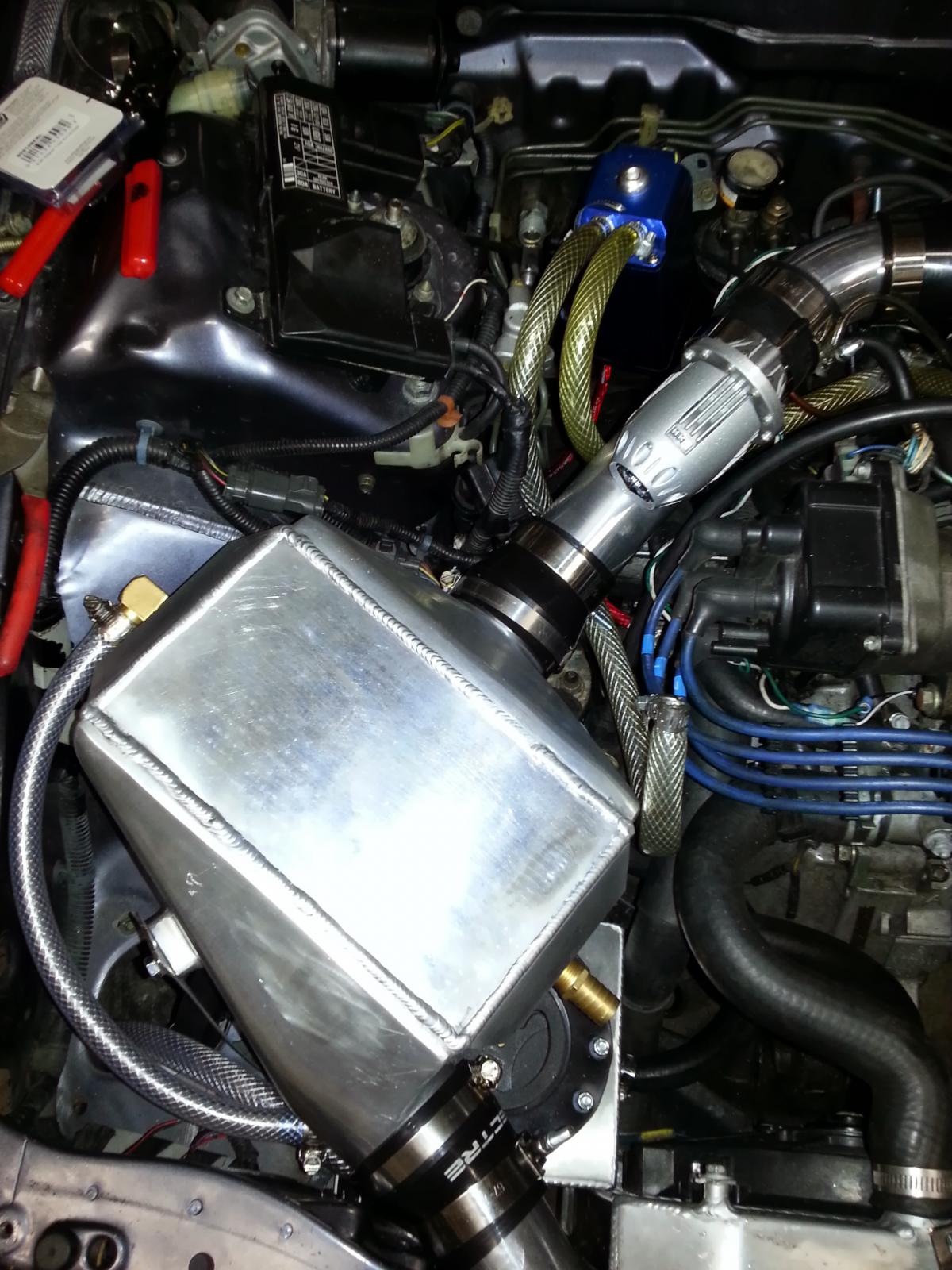

I decided to go a completely different route when it came to inter-coolers. Some might say it's not the smartest choice, some might ask why i gave myself the head ache. I did do my research on this, I didn't just go for it to be different and well, I wanted a sleeper look. Where you couldn't see an inter-cooler from just looking at the car. I thought it would be a bit more interesting going this route anyways.
Got Cores? LOL

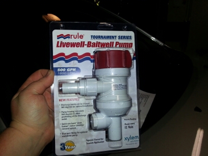

Water Pump
I decided to go with a water-to-air inter-cooler. Mostly because it gives me the option to place it where I want to and stay hidden. But also because I will use less piping, I will only need about 4 feet of charge pipe, which will help with throttle response. And less modifying the body. Yes, I will have to plumb it and get a water tank for it. But i think it'll be cool to have done something a little different than normal. Shall be an interesting adventure.
So the engine was just disgusting, 21 years of oil/dirt/grime built up A LOT! Luckily I had WD-40 and a bottle of this purple degreaser. Still got a lot of cleaning up, but dam, what a difference for the first try!
Before
After

I decided to clean the rest of my block and transmission before I worked on it. I swear, this stuff (purple power) kicks ***!
I decided to open up my noisy transmission and see what was wrong....
Well I opened it up, 3rd gear looked a bit rough, but then I looked in the magnet tray and saw bits and pieces of bearing in it. Looked at the main bearing and this is what I saw...
Makes sense why my it was so noisy! Geez!

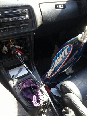

Also, I got bored over the weekend and went to a swap meet and found a budlight beer tap for $10... haha so I figured what the hell!
Just for a good laugh!

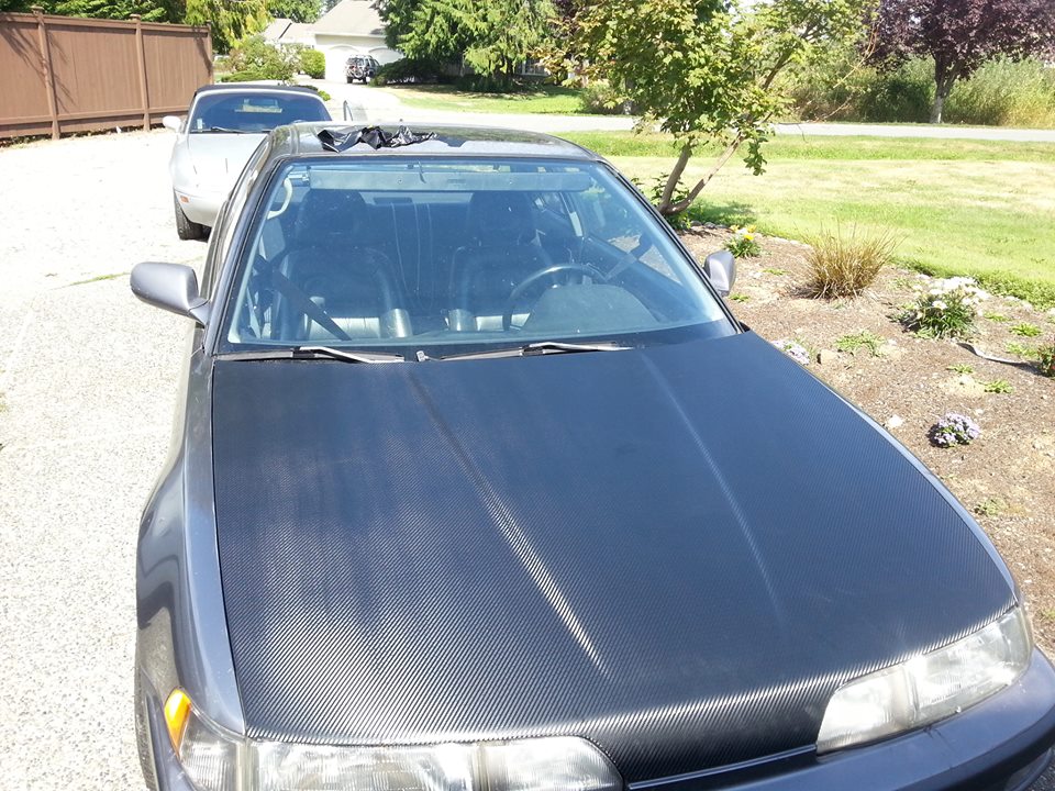

Got my carbon fiber vinyl a while ago and finally got to installing it today.....

Started by putting it on jack stands so i could get under the car easier. And so I can fix my rim.
Then after i put the manifold, turbo, and oil lines on. I mocked up the piping.
After that, I set it all in place.
Making the water lines and figuring out where they go.
The water pump, I was wanting to put it in the rear. But, I couldn't figure out a great way to run the lines to there. So for now, the reservoir and pump will be up here. I have separate relays for the fans and the pump as well.
I found an RCI 1 gallon fuel cell for $80 off ebay, and honestly... I cannot believe the quality of this thing!
Making some modifications to fit the radiator for the intercooler.
All done, well at least installing everything. Now I have the task of cleaning up the rats nest. ha but that will be for another day.
I'll update about the downpipe in another post.
Also, i was worried about having the reservoir i the engine bay. And i was going to shield it, but I drove it to the exhaust shop with the hood closed and the intercooler was pretty damn cold.
I am honestly really impressed with this water-to-air kit from Frozenboost.com! Just fantastic and gets me more and more excited to get tuned and see what happens!
Before
After
Update 26! 5/30/2013 NEW JOB
So, I have a week off before I start my new job and got bored.
