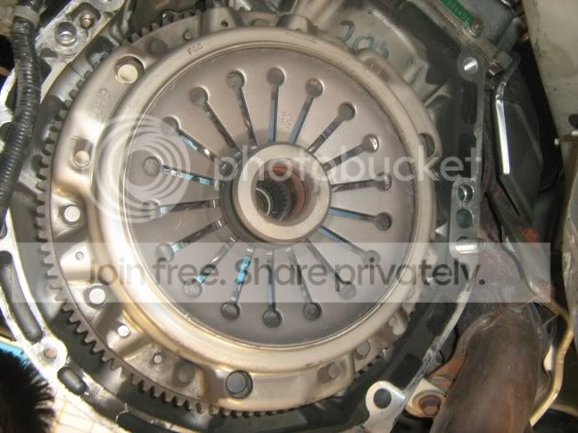

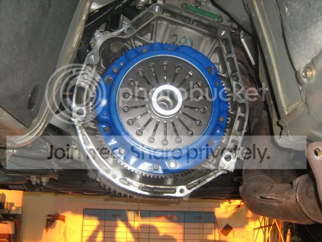

yes you can
I i have said before, it is possible, and it makes it a lot easier if you grind off one of the tabs that hold on one of the poinless heat shields. I has no issues removing the tranny on the last clutch swap i did
