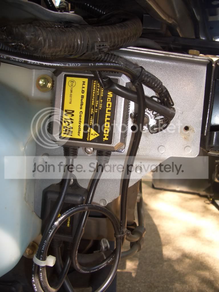

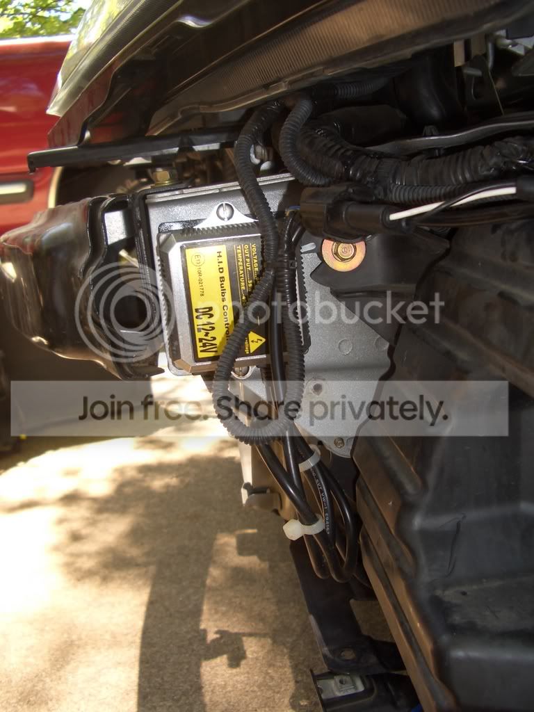

I can get you McCulloch 3000K(yellow) kit if you would like. Here are the pics of my installation.

wow you did a good job!! i mounted mines in the exact same spot...
But i got 12000K bulbs. they say that the higher the kelvins, the shorter the distance of light. but for my, all i did was aim the fog lights a bit higher and see everything...
and Boosted_F22B if you want to run ur fogs with out the headlights on, just take out the high/lo fuse under the hood for left and right head lights and you can run it like that. i drive with my fogs at night alone and i see everything... obvously its not as BRIGHT as the head lights cause they arent projectors but I still blind people LOLz... more pics to come soon
