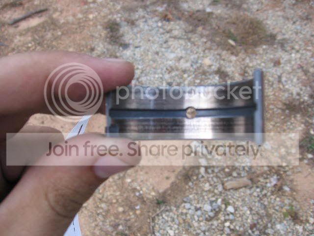

Scored one bearing during dyno of non-vtec h22, any opinions?
I'm running a built h22 bottom end with a h23 head on it turbo'd with a homemade kit. I put about 370 miles on the motor for break-in and during dyno tuning we scored the center main bearing. It didn't spin, but it got hot and started ticking.
We pulled the girdle off with the main caps while it was in the car and found the one bearing went bad, anyone know why, or have any ideas?
We spec'd the motor before assembly (Both ways, with the micrometer and plastiguage) and the numbers were all withing factory spec (On the loose side of factory) and it ran great for the first 370. We had boost around 11 psi and all was well, made about 12 pulls and then the ticking.

Maybe that one bearing was a bit tighter than the rest, but I don't recall any of them being of any concern when assembling it.
I'm going to pull the crank and have that journal polished and have the crank in general checked out again, then back in once again.

Well, after doing some research and talking to some engine builders the Rotella 15-40 was recomended to me. Even read a few articles online about the benifts of using it for initial engine break-in.
I broke it in non-turbo with the same tune as my old setup running the 550cc's, it ran fine and I never got on it until I had it re-tuned.
I did have the block completely gutted, since it was sleeved I took no chances for any garbage or chunks floating around.
As far as turning the crank, the journal looks 100% fine, but still having the machine shop check it out and give the journals a polish to loosen up the tolerances a pinch.

have you tore the motor down and what have you found. pics speak a thousand
words and would help everyone HELP YOU.but here is another guess if it matters.
you could have some dirt or something of the sort under the bearing.i have seen this when the crank is in and turned by hand and WON'T.here is one more theory
for you also.was the motor dry when you done the plasti gauging,maybe your cali-
per was off or not calibrated.but like i said post some pics and that will tell the real
story.

Well, we cleaned the backsides of the bearings along with the caps themselves. I left the main caps attached to the girdle after the machine shop align bored it so all should be good there as well.
I'm thinking that maybe the tolerances were just to tight, but we have the motor tore down and the crank will be going to the machine shop this week to be checked out.
I've got a buddy that may be posting up a pic for me, if he gets it up you can take a look at the bearing.

I built the motor.
I trust the machine shop fully as they have spec'd out motors for me in the past with no problems.
I myself mic'd the bearing tolerances and plasti-guaged the motor during assebly.
I did spin the crank when torqued down by hand and all was good, even with the rods/pistons bolted down it would still spin nicely (Obviously harder, but smoothly)
I had never heard of running the center bearing looser but have had a few guys mention it as I ask this question.

well something isn't right and needs to be addressed so this does not happen again.what does the motor look like now or have you even tore it apart.all you have to do is look at some of the books for these honda motors and the majority
will tell you to run # 3 looser than the rest.
I guess thats the main thing I missed during assembly then, a looser center bearing.
Anyhow, the motor looks great other than this one bearing, so the next question is, do I re-use any of the bearings? Or do I replace all of them? I'm running Calico coated bearings in the motor and (In my opinion) could just replace the one bearing.
The rings and bores look great, all of the rod bearing are perfect and the other mains look new still.
Modified by bjaccord at 12:18 AM 11/24/2007
