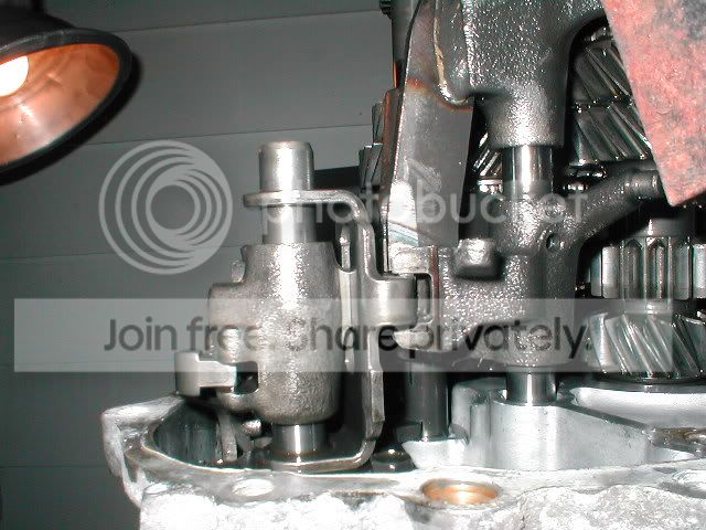

anyways here is the case, im going to just give it a shot and weld it, i work at a sheet metal fab shop, there are some exellent welders there...if it gets fuked up, ill get another case...but i think its worth a try...
and can you two take a look at my change holder and tell me if its correct? Bone you got me scared with your "make sure its all right" post lol...if i need to take a pic of something else let me know......i really appreciate your help tranny guru's!

this is the first tranny i have disected...can you guys tell me if my change holder looks correct?
whats the little "catch" under the change holder for?

Default Re: (fast2camciv)
Your shift lever looks like it's aligned fine. When you're putting the case back on... make sure that the little ring on the bottom of the top of the bearing is pointed toward the right spot for the top of the case, make sure that all the shift rods are seated right, then the shifter lever is the last one that's hard to get down right... put the tranny in neutral, put a screw driver in it and turn it while pressing the top case down and it'll go back on. I usually don't even spread the C-clip to get it back over the bearing... I just put the bolts back on and tighen them until it pops on itself. Don't forget the 12mm bolts that have a bearing and spring on them, the 14mm bolt that holds reverse in, or the dust cap. Good luck... I had to do everything the hard way(by myself and figure everything out). There really isn't any good B-series tranny write-ups just d-series ones.
