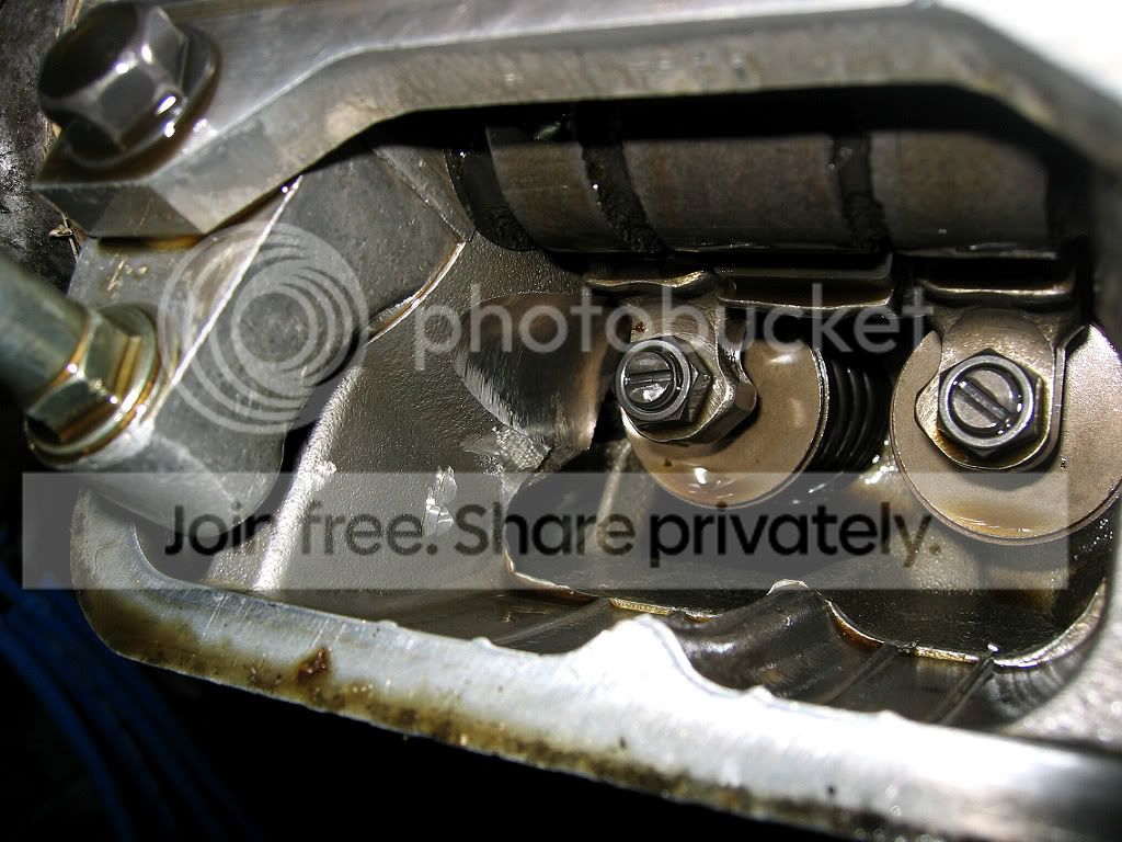

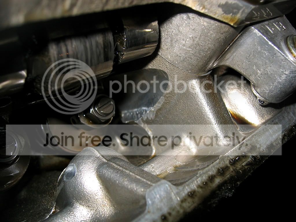

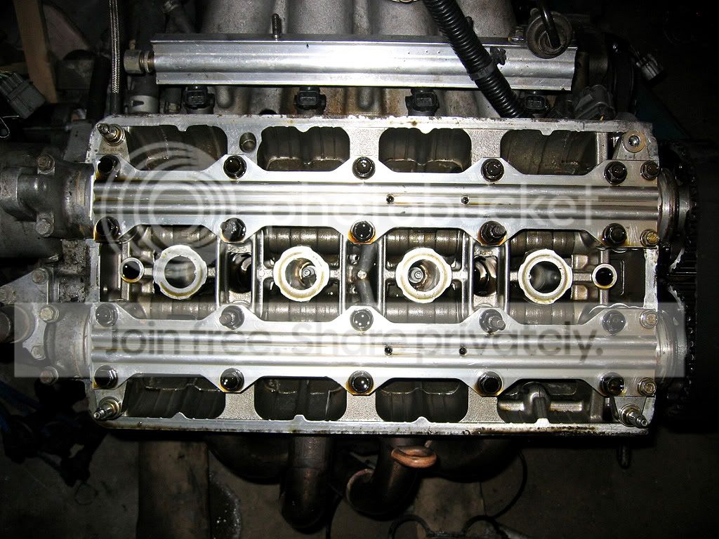

well i removed it finally and saw that it looked like parts of the head was chipped away...is this anything big?

looks like a normal casting to me.

<TABLE WIDTH="90%" CELLSPACING=0 CELLPADDING=0 ALIGN=CENTER><TR><TD>Quote, originally posted by Combustion Contraption &raquo;</TD></TR><TR><TD CLASS="quote">looks like a normal casting to me.</TD></TR></TABLE>
same here. If you are paranoid though change your oil and filter it as well as open up your oil filter.

normal head casting flash

I'm sure he'll be asking about the rectangular punch out next.

good cam quality ill say that much.

thats normal, standard head casting characteristics

casting flash, normal.

one thing I will say is that there seems to be some scoring on your
vtec lobes, what cam/valvespring combination are you running?

my Type-R head has WAY more crazy marks like that than yours does.

supertech valves and springs.....and crower stage 2...i do beat on it tho lol. the camera is canon s400

Your exhaust cam is toast. Change it out and any rockers affected before you drop your valve and then be really hurting.
