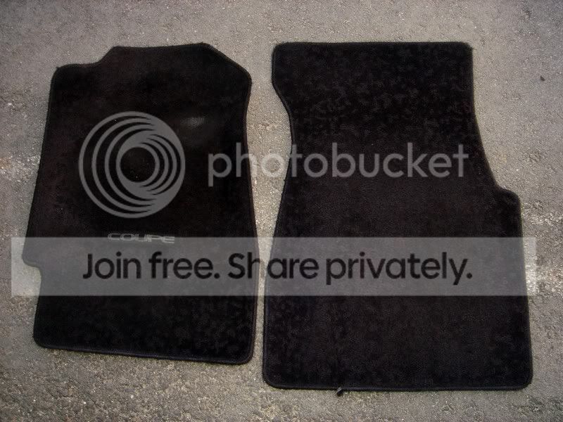

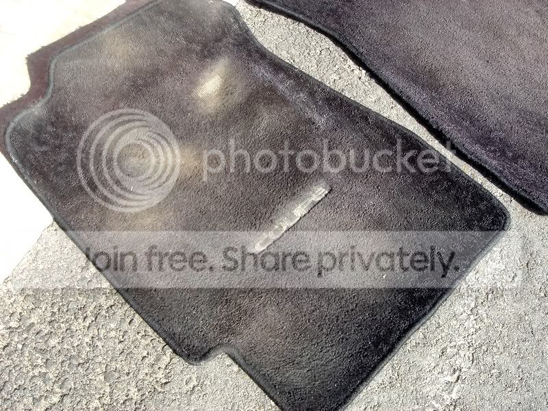

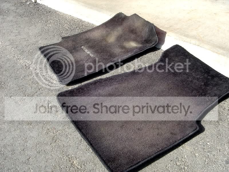

Wanted to paint my 95 integra Gsr's floor mats cause I just didn't like the grayish color and also is was kinda faded.
Decided to make this "How To:" after I was halfway through
1. Pull mats out of car and give them a good wash.
I used "Woolite Dark Laundry" for the washing process.
(Note: This works good if you don't want to repaint, will darken the mats)
Pour Woolite into bucket, add water and go to town!
2. I used Dupi-color Vynil and Fabric paint. (Flat Black - 4.06ea) You might be able to do it with one can but I bought 2 and used a little of the second can.
3. After scrubing the crap out of the mats you need to dry them, I hand dried them using towels.
4. Now your ready to paint. Spray can about 6-10inches away from the mat. I went along the lines of the mat. I used about 2 coats, waited about 10-15 mins in between each coat. Only took me about an hour to do.
Looks good to!
Let me know if I left anything out, which I bet I did.
Ill take some picture of them in the car later!
-Corey

hey looks pretty good.
personally I wouldn't want to paint anything cloth.
but that looks ok,
only problem is that your pics kinda suck, they're blurry.
Can't really judge if it actually came out good or not..
But looks good from a distance for sure!
nice and black!

haha! it looks pretty good up close, still kinda shows some of the white/gray spots so makes it look good, but hey all you got is my word! lol
