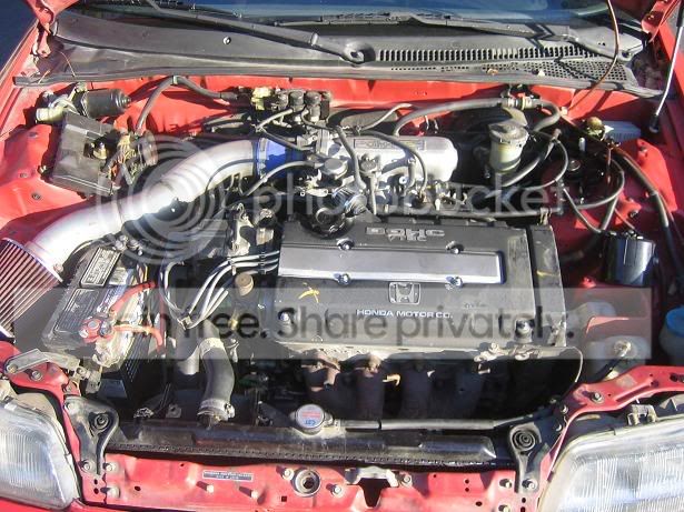

Which b16 do i have and how can you tell? I need to get a new temrsender and a new thermostat and i want to make sure i get the right ones thanks people.
I was only told that it was a jdm b16 so i dont know anything else but on the otherhand does it matter as far as those parts go?
Thanks

wouldnt it say like b16a1 or b16a2 on the metal square piece thing to the left of the valve cover, kinda right next to the block on the left, right above the transmission?

If its jdm it will say "B16a" and thats all..And it looks like your b16 has 2 dashpots on the intake manifold so Im thinking its from the xsi integra ..Also there is a date stamped on the motor right above the exhaust ports..

No..B16a2 is obd2 and from northamerican 99-00 si/sir..B16a sir2 is obd1 from 92-95 jdm cars..B16a1 is obd0 from edm civics and crx vtec models..B16a sir1 is from the 90-91 civic/crx sir japan..Then theres also the B16a from the 90-93 integra xsi in japan,,90-91 being obd0,,92-93 being obd1..Theres a bunch,,Im not going to list them all..
But from the 2 dashpots on theintake manifold and the dohc vtec letters it looks to be a b16a from the 90-91 integra xsi,,

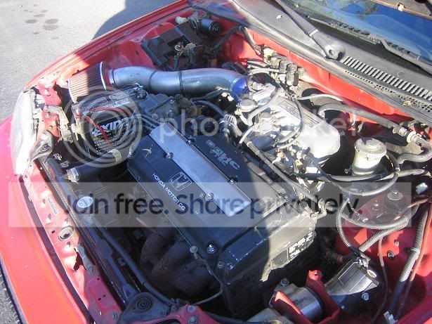

Here some more pics so you can see how really cluttered it is.

If the valve cover is origional, then it's a late b16a, early b16a2

Judging by the dizzy... the verdict is first gen B16a possibly with a XSI Intake manifold on it but doubt it. And FYI the 1st gen B16 said DOHC in big letters and VTEC in small and also said HONDA MOTOR CO. on the bottom The 2nd gen said DOHC in small letters and VTEC in big and only said HONDA on the bottom. look at the first circle from the left above the Exhaust ports that will tell you the year good luck

Yeah you dont need the dashpot(s)..I removed them on my car as well as the charcoal canister..Then simply plugged all the open nipples they left..Only vacuum lines on mine are brake booster,map sensor,and fuel pressure regulator,,Its pretty cleaned up ..By the way ,car runs perfect..I dont even know what the dashpots do..

the one on the left slows the throttle down when you snap it shut, i guess so dosent go super rich for i split second, i don't know what the one on the right does

Look again,,His has 2 dashpots..So that means its a b16a from an integra..But its all the same motor either way..But to answer the original question,I always use thermostat for the 90 integra,,others may work also..
