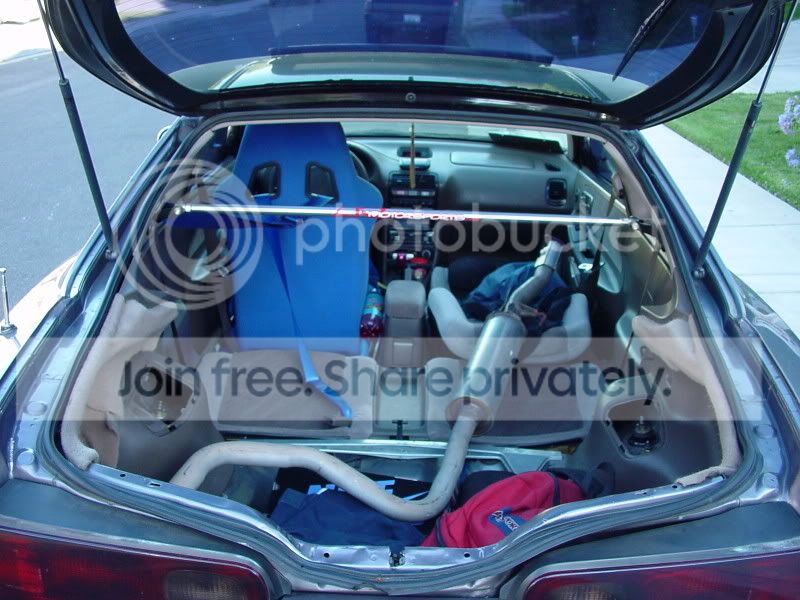

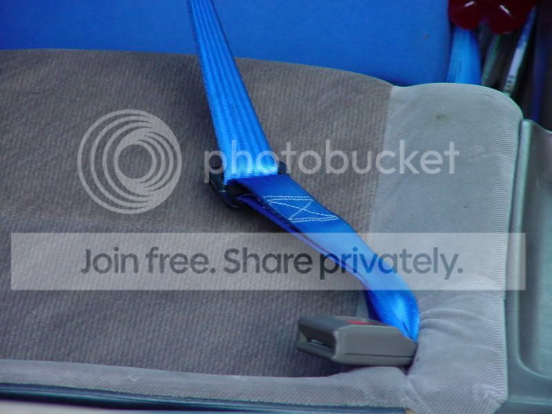

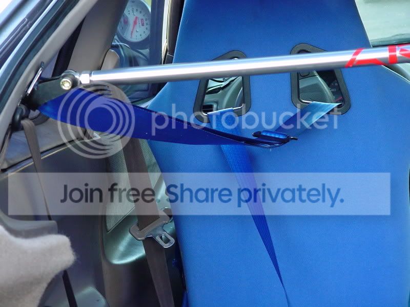

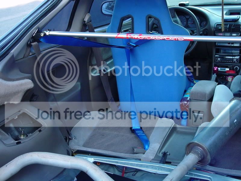

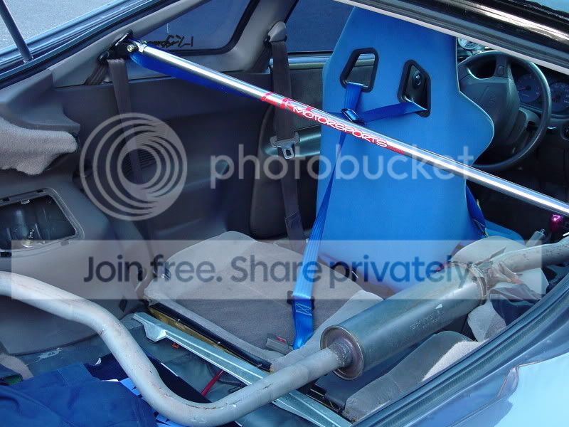

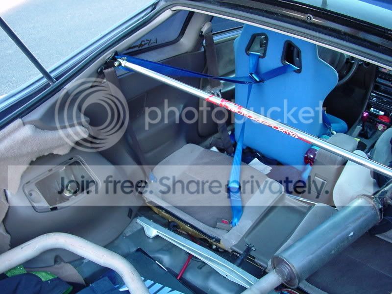

I'm not sure how the harness buckles mount on the front.
I am not an expert so any insight is appreciated. Also, if you can explain how the angles are safe/unsafe, and how that affects the body in a crash, etc. I remember reading about the physics and the distribution of stress/force through the harnesses in a GRM issue a few years ago but totally forgot what is the right/wrong way to mount the harness straps.
No flames please.
No flames please.

that is quite scary looking, not sure why you did it that way?
move the one mounted to the strut bar thing down to the bolt hole near the rear seat belt buckle, that would be less bad
i assume this setup is for autox use or somthing since you retained the stock belts? id say it would be fine if that is the intended purpose, but that setup is DEFFINITLEY less than ideal, although im sure you know this.

My mistake. However, the Sparco guide linked above says you shouldn't have the harnesses angle downward more than 5 degrees. It also says to keep the shoulder straps 6" apart to keep them on your shoulders. I'm no expert though. And I guess it would be fine for autocrossing either way?
Without seeing the whole installation and just going by the way the shoulder straps are mounted in the pictures, I would have to say no, neither harness set is safe. Since only the shoulder straps are questioned, I'll just answer that.
The shoulder straps ideally should be perpendicular to the spine. If that's not possible, they should be no lower than a 5 degree angle down off the shoulders or more than a 30 degree angle up off the shoulders. Any more than a 5 degree angle down and you rish spinal compression. If more than a 30 degree angle up and the shoulder straps will not restrain you in an accident. For mounting, the runs should be kept as short as possible to minimize stretch and not mounted more than 4 inches apart measured at the inside edges of each strap. If you have an SCCA legal roll bar or cage, the shoulder straps will typically be wrapped around the cross brace/harness bar. If no roll bar/cage, you need something like a harness bar to get the correct angles. I couldn't really tell but the one in the first set of pictures looked too high for this purpose. Maybe the harness bar can be mounted upside down (right side up???). I'm not sure about the strength of the bar but some manufacturers say the shoulder straps can be mounted directly to it but you would have to check with the manufacturer of your bar. Most harness bars are used to just run the straps over (for the correct angle) and then down to the chassis.
As far as mounting these to the chassis, mount them as straight back as possible (so not to give on one side more than the other) in a solid part of the chassis and use a seat belt backing plate.
