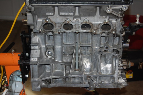

Old Jan 9, 2011 | 07:43 PM
Charlie Moua's Avatar
Posts: 12,561
From: MN
Default Re: painting in the winter?
before and after....
I used wire brush, de-greaser, cut small squares of green scuff pad pinched pliers to get in between all the cracks, vth 1300f primer and 500f paint.
I used torpedo heater so the -10f temp outside this weekend wasn't an issue. In fact I had to open the garage up to vent it after each coat of paint.
Old Jan 9, 2011 | 08:29 PM
CivicxTree754's Avatar
Photogenic
Loved
Joined: Jul 2008
Posts: 502
From: Baltimore, md, United states
Looks sweet. I wish I coulda had that much patience with mine. I just degressed hit with the brush where i could and then sprayed lol. Didnt turn out bad tho...
