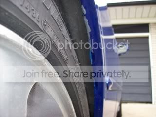

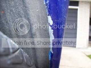

Okay so i just got done rolling my fender and the paint crack and started peeling. what can i do to fix it? or prevent it from rusting?

to prevent it from rusting, im guessing use an epoxy primer

I used clear nail polish. It worked great for the 6 months it needed to.

Default Re: Fender roll paint crack (h3art)
got pics up

did u use a heat gun b4 rolling your fenders??i think honda has a detail pen u can use.. jux ask for the color u want..

i used a hair dryer. didn't work that good. but will the pen prevent rust too?

use a hammer instead of a roller for the rear quarters. I used a hammer on mine and i think it chipped one spot the size of a pea.
as for preventing rust, just get some epoxy crap and paint it on... or repaint your car because that looks awful.

yes im pretty sure it will prevent rust..make sure its not already rusted b4 u put any thing on..

Just remove the wheels, painters tape, duplicolor spray to match your paint and spray down there.

touch up paint, nail polish, spray on clear coat (clean surface first). any of those will work.
easy fix.

Thats what I would do. That part of your fender isn't showing much anyways and nobody will notice it.
