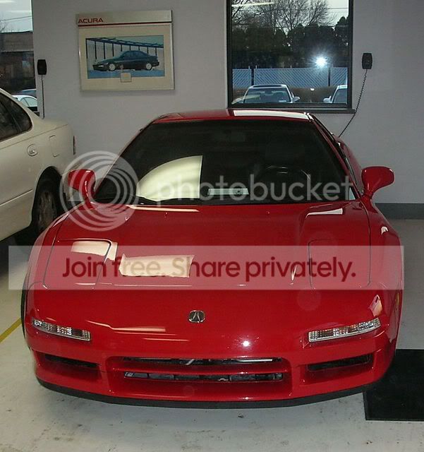

I've used PPG, Dupont,BASF & others,ect. My preference for completes is BASF RM Diamont, the DC5300 rocks. It has a slightly longer cure time before it can be handled and buffed/ polished but it has an awesome gloss and it buffs easy for fresh paint. BASF also came out with DC5600, a newer different version thats pretty similar. I've sprayed it but I haven't used it as much as the 5300. The DC series is some quality UV protective shizznit. Cheaper type clears can look similar if sprayed out nice, heres a pic of a job I did with Shopline clear(lower cost)
Here is a pic of a job I did with the DC5300, a complete except for DR side door & QP
