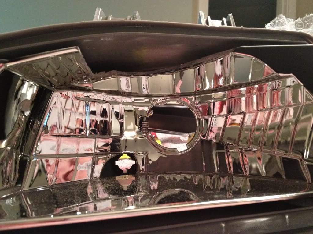

Cut out upper area to make room for projector shroud:
http://i148.photobucket.com/albums/s...o/egretro4.jpg

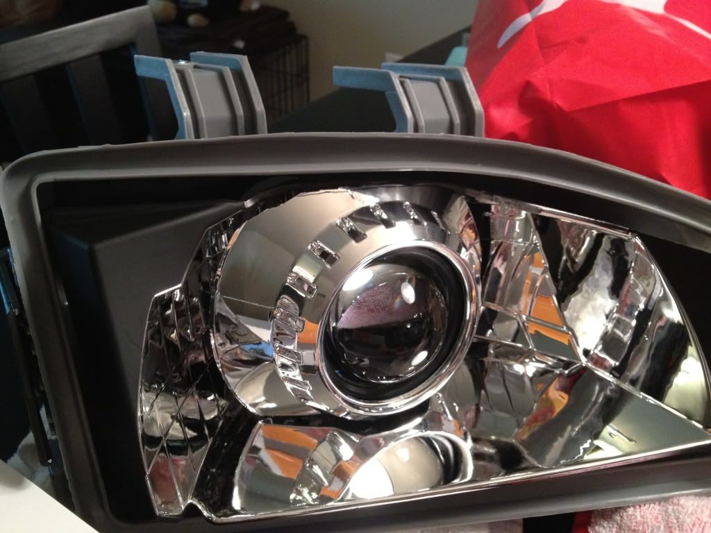

Installed projector and shroud:
http://i148.photobucket.com/albums/s...o/egretro3.jpg

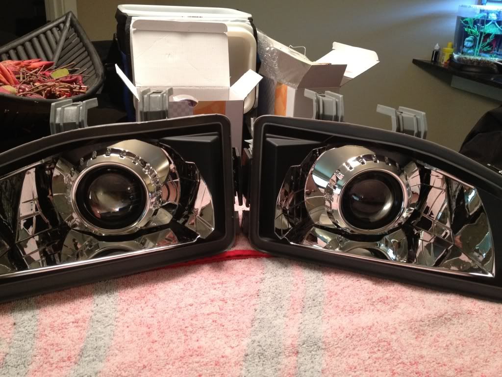

Both headlights done, just need to install glass:
http://i148.photobucket.com/albums/s...o/egretro5.jpg
Will update when installed.

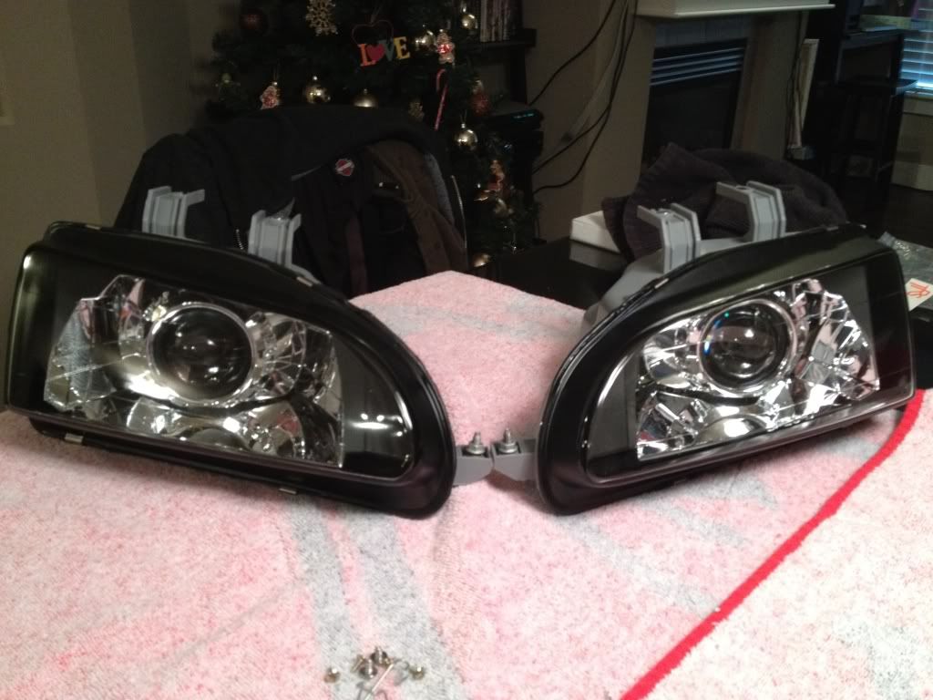

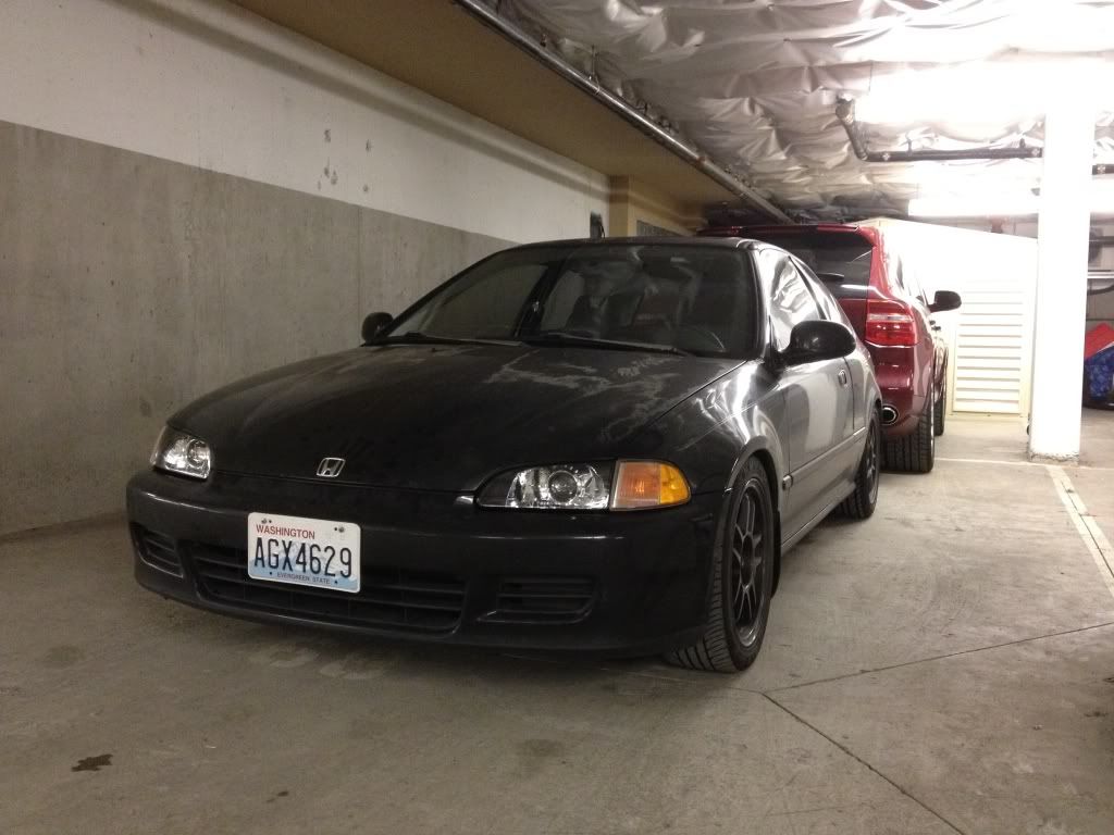

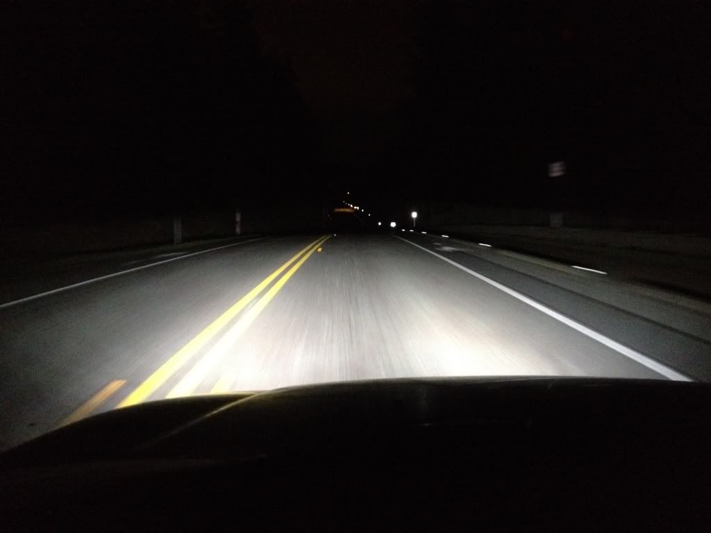

Complete:
http://i148.photobucket.com/albums/s...0Retro/eg5.jpg
http://i148.photobucket.com/albums/s...0Retro/eg6.jpg
http://i148.photobucket.com/albums/s...0Retro/eg9.jpg
EgInvy Apr 4, 2012 08:54 PM
Re: Looking for a good projector headlight
wow, that looks like Christmas :D What projectors are those and did you test where they were pointing before you sealed them or did you just eyeball it?

Saggio Apr 5, 2012 06:36 AM
Morimoto Projectors with 55w 5000K DS2 bulbs
E46 Shrouds
I didn't check anything as far as light before sealing them back together. Took 5 minutes to aim them correctly.
