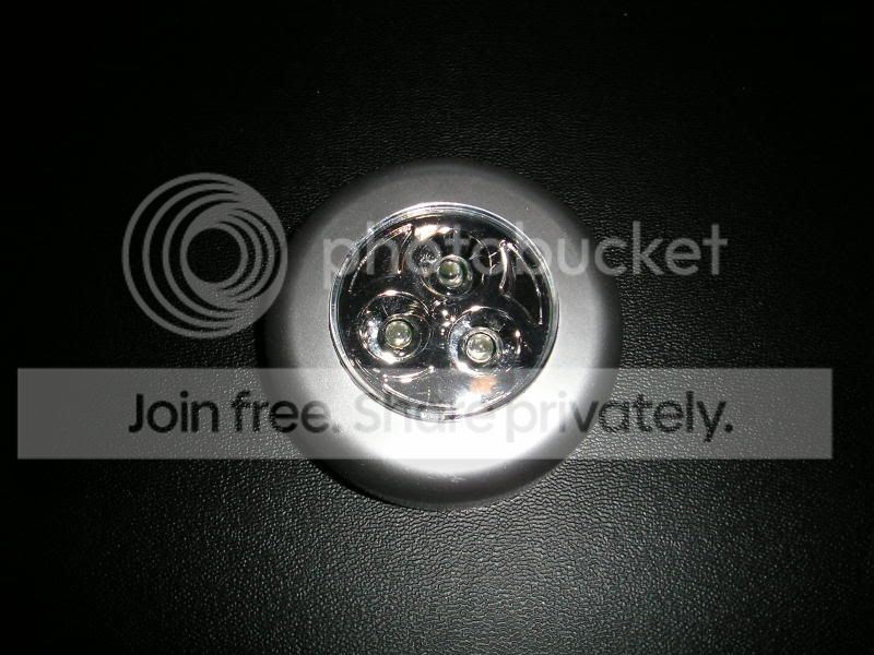

I noticed i super good deal that a store locally was selling led "click and stick" puck lights. They give off a super bright white light and for the price i couldnt complan. So i bought 4 packs for $2.99. Heres a picture
(Note: led flashlights or something similar would work, or you could just buy leds and make your own)

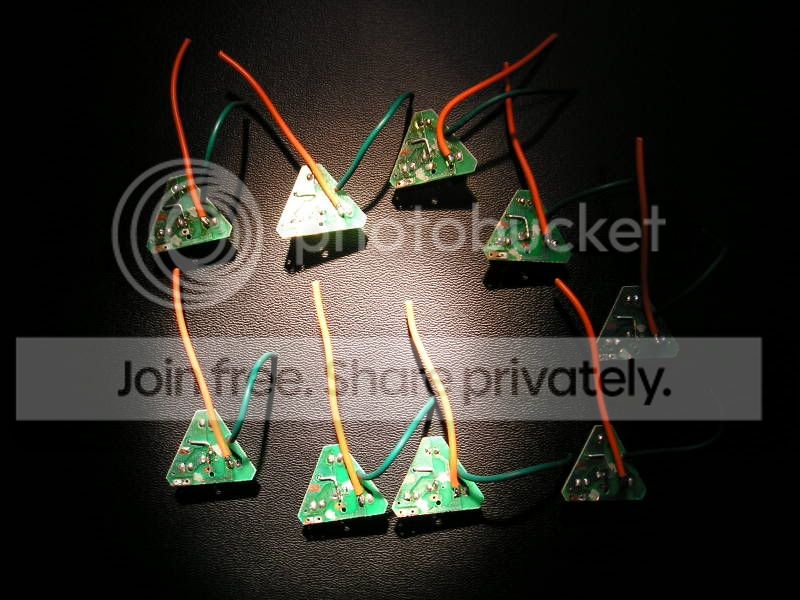

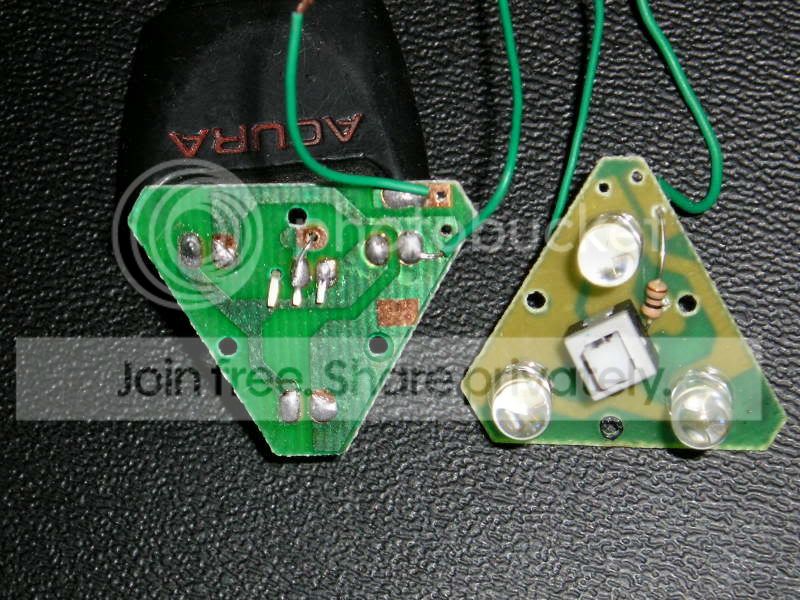

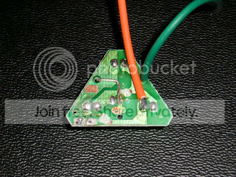

I took them apart and ripped out all the stuff that i dont need and was left with this
I needed to change out the resistor so it can run off 12-14volts and also wire them in series for best results. (thanks Just In KY 2002 and Azdave for the helping me) heres the website i used to find the resistor that needed to be changed http://www.quickar.com/noqbestledcalc.htm
More photos yeppy hehe. Heres the leds modded
The led fleet

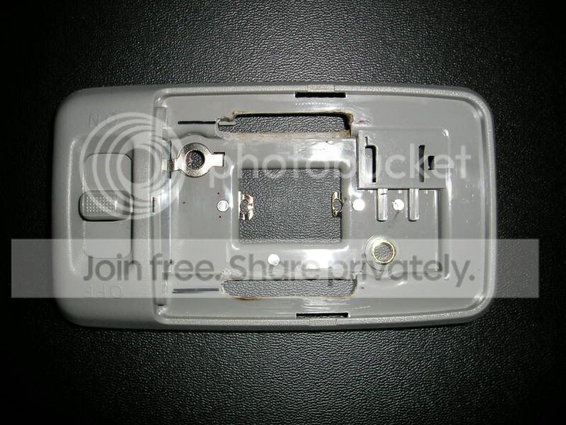

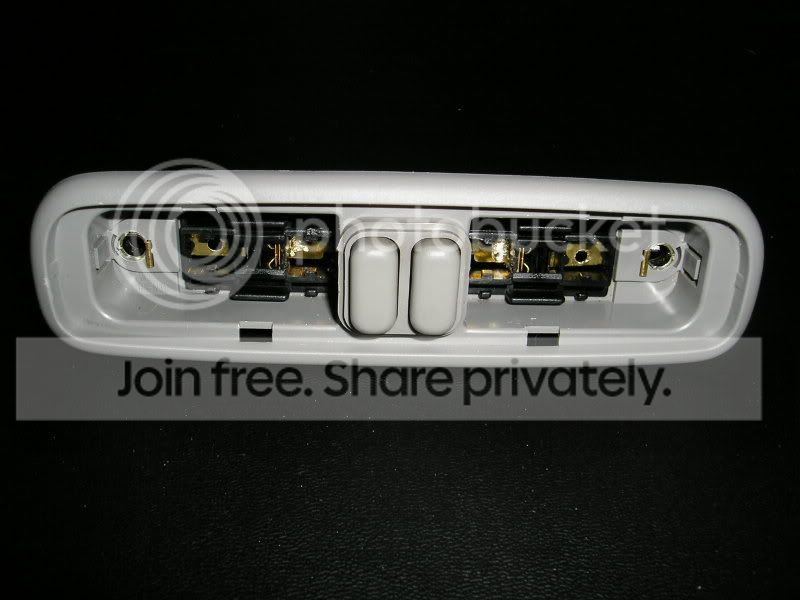

To install the leds onto the dome and map light housing, the terminals for both the light bulb holders needed to be cut off since they would be in the way and also some triming need to be done. Side cutters and a dremal took care of this. Here is the dome housing and map modded to accept the leds
Dome:
Map:

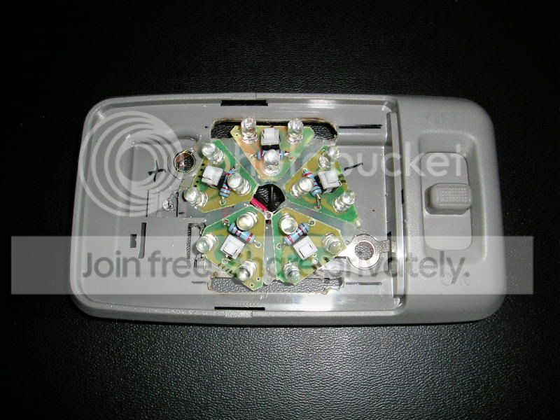

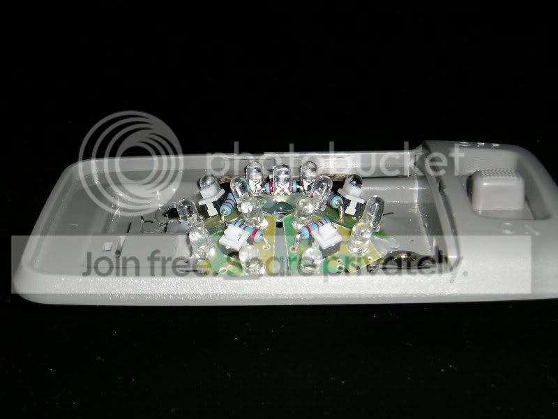

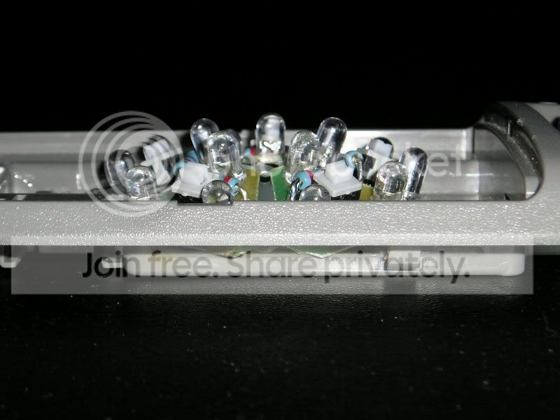

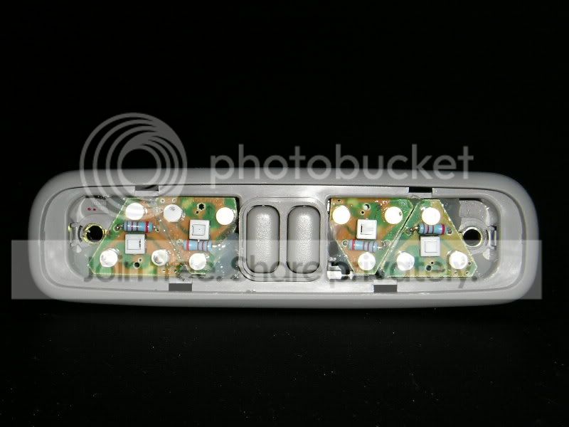

Pcb with leds installed onto the dome and map housing. For the dome light i angled all the leds in each direction to disburst the light evenly so it would shine throughout the whole interior
Dome light:
Map light:

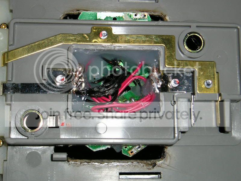

Wiring: (sorry only have pic of dome)

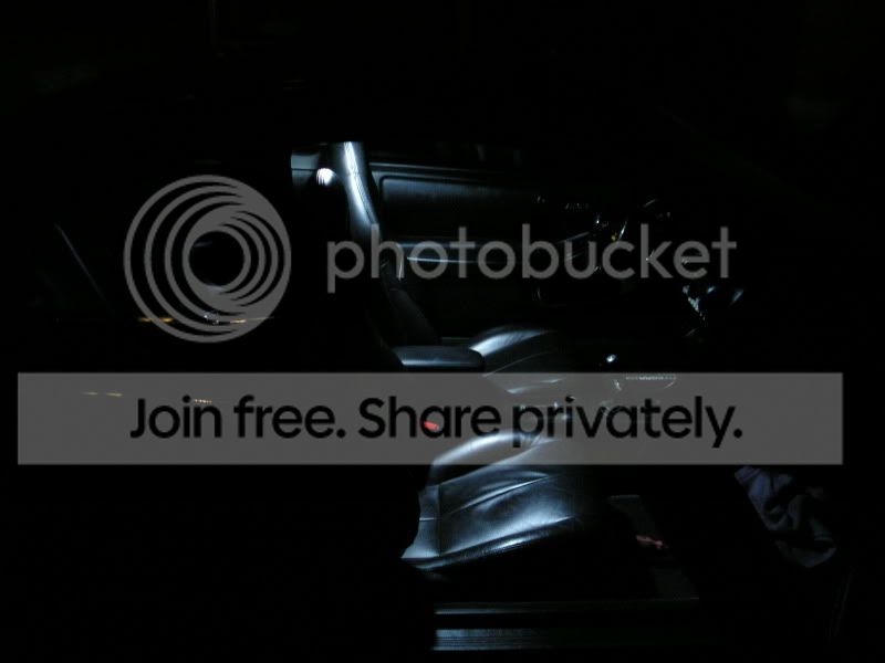

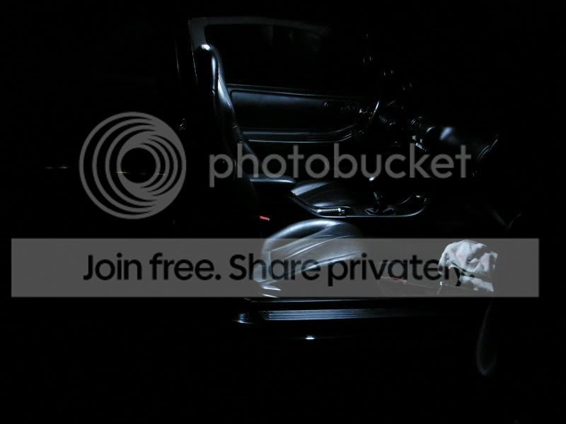

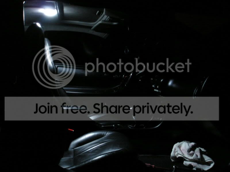

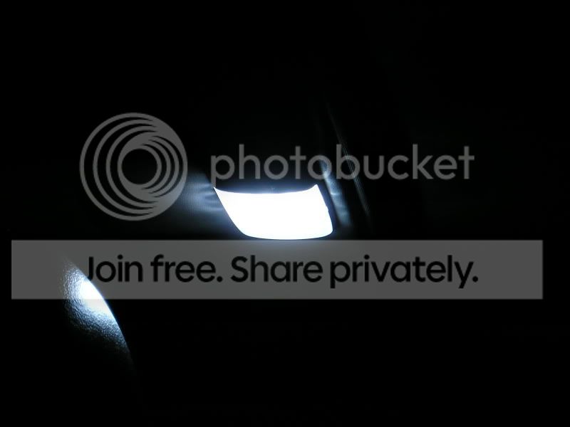

And last but not least the installed pictures. Sorry about the bad pictures but its very cold out side and my car is put away in the garage for winter. (Note: my battey isnt fully charged so the leds arnt getting full voltage thus cousing them to have a tint of blue light.)
Dome:

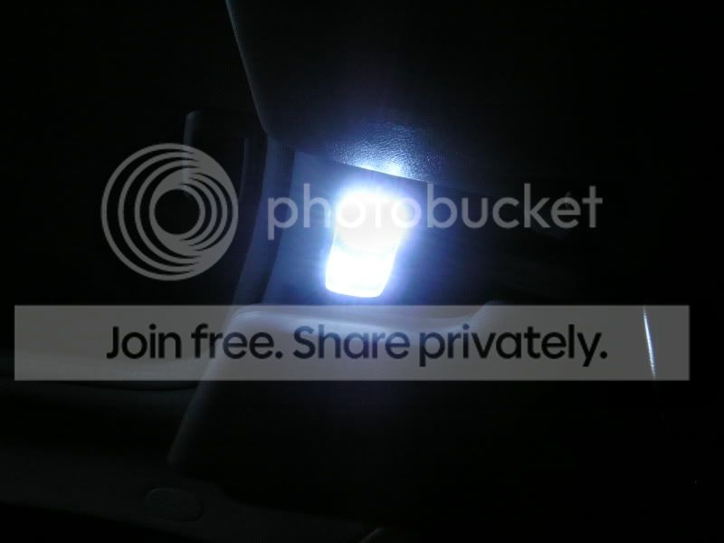

Map:
Dome from distance:
Map and dome:
I dont have any before and after pictures because my camera dosn't really work well without light so it probably wouldn't have shown the old bulbs anyways couse it was so dim.
The pictures really dosnt do it any justice couse there alot brighter then what it shows in the pictures. Over all im very pleased with the way it turned out and would do it again.
