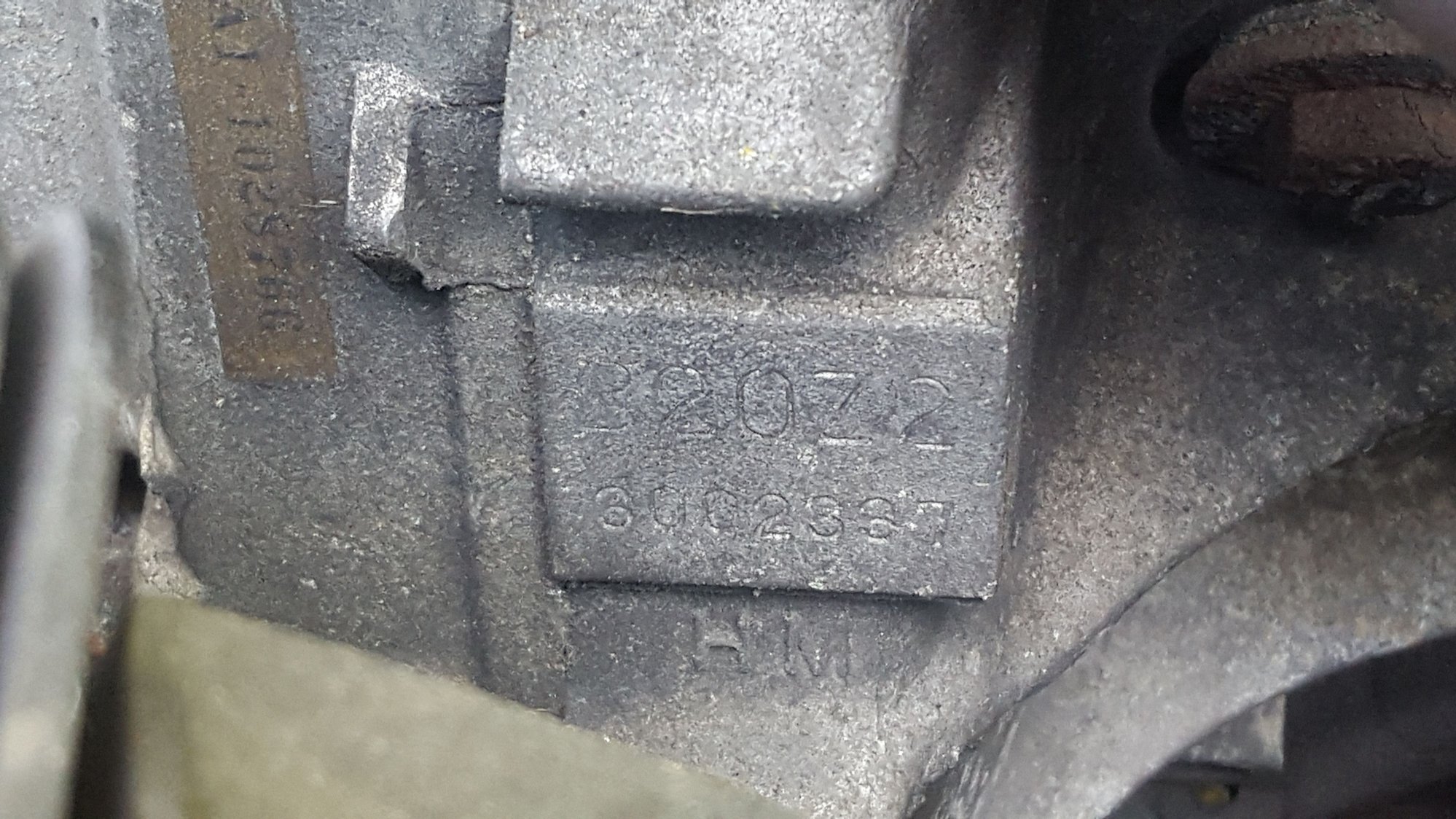

I have really never gotten into the Tuner scene much or anything I have always admired them I just never got into it too much. When I was younger I had an 89ish CRX HF that I did a b18 swap in. I just recently picked up a 1991 Civic Hatch that someone did a half **** B20Z2 swap in that I am currently trying to get squared away. I think that I will hold on to this a bit, I believe that it will be a little fun car to tinker with. I know it needs some work especially with the exhaust it is obnoxious and rusted out.

B20Z2 aka Cr-V powered lol

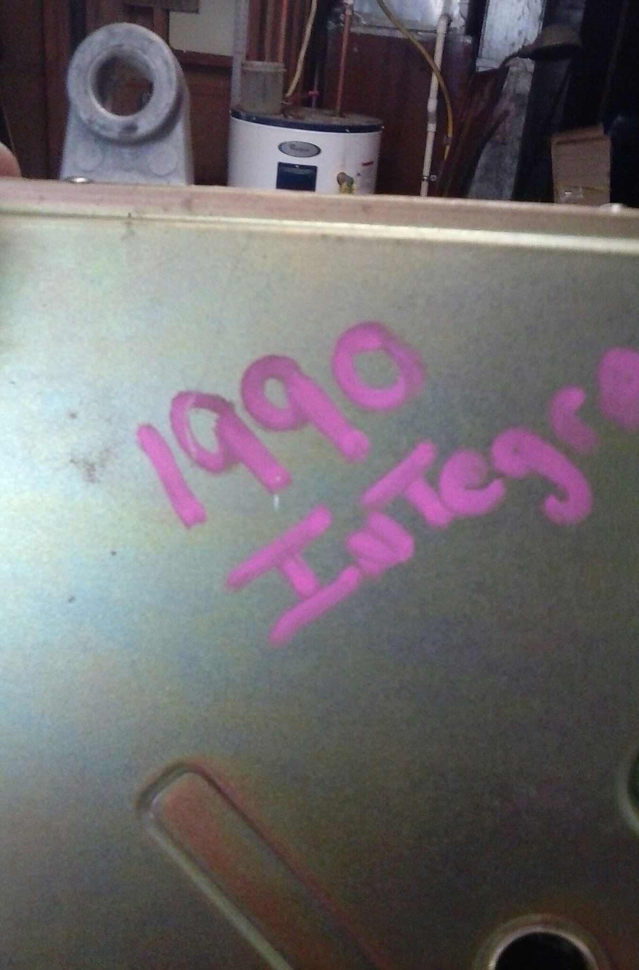

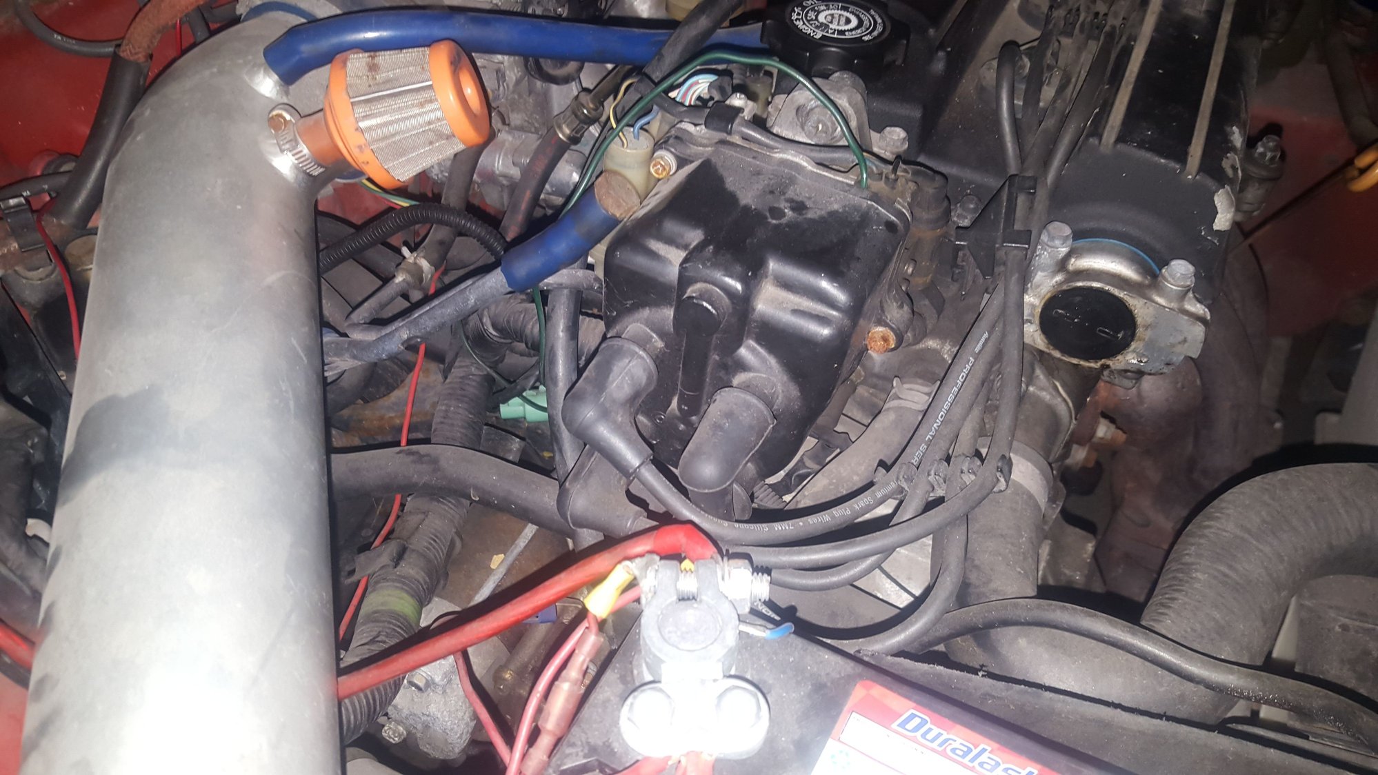

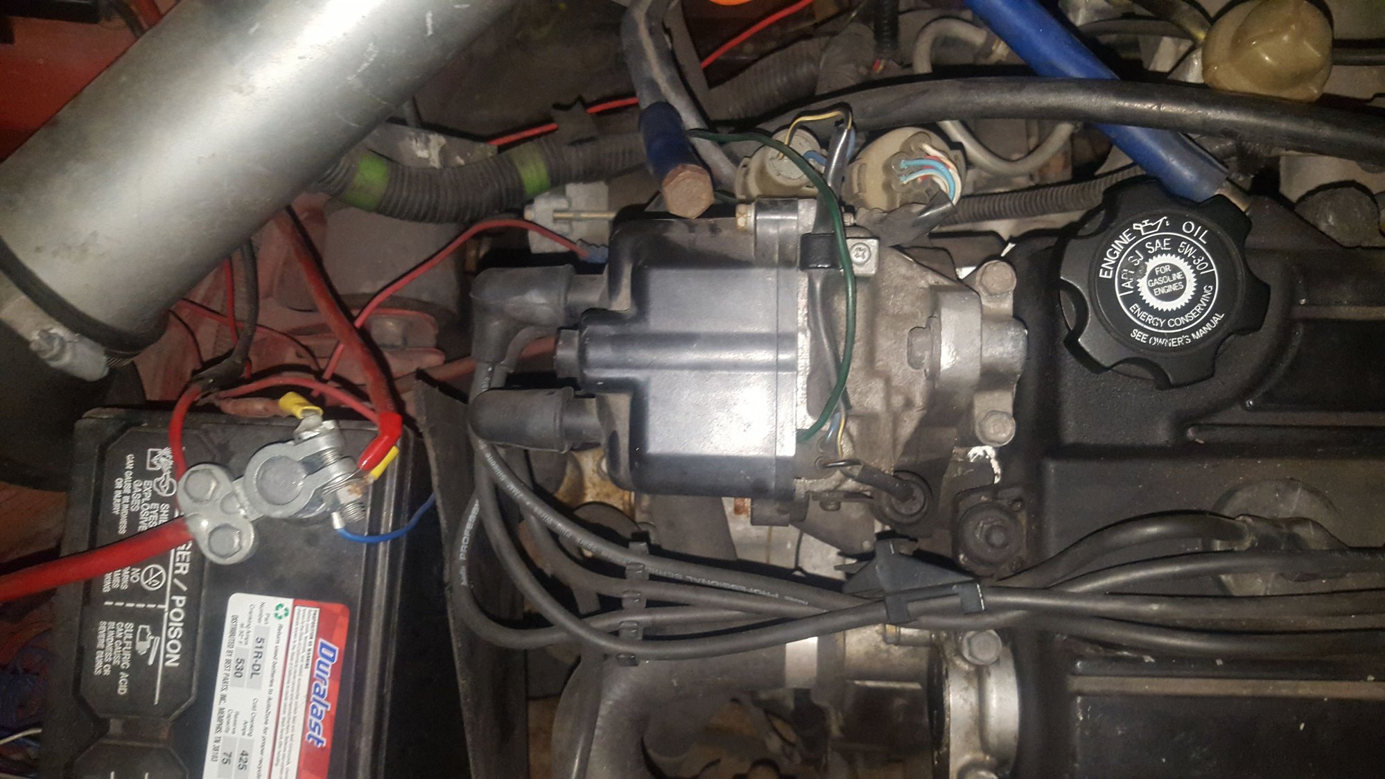

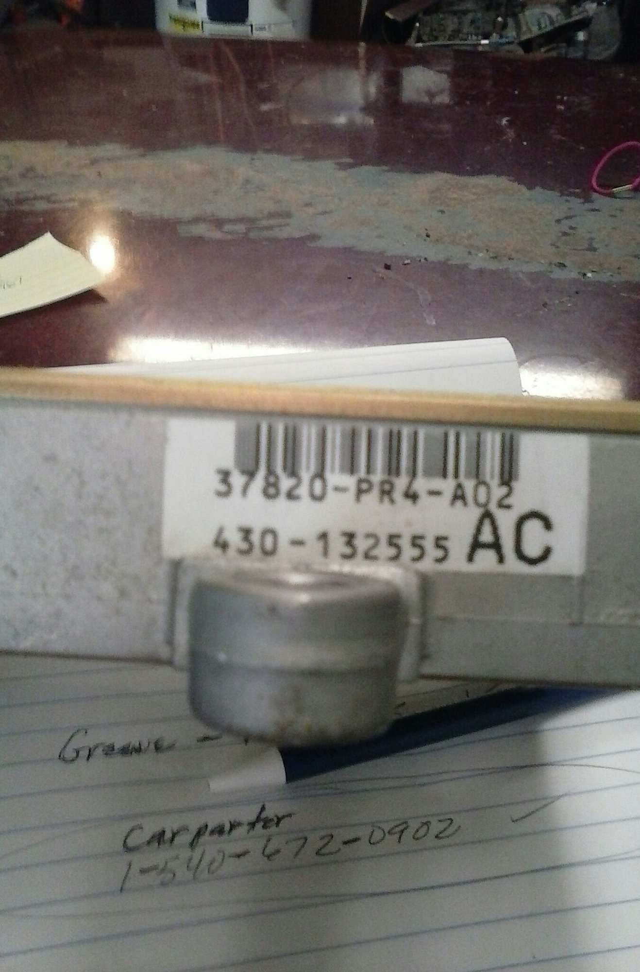

Update on the Honda repair/build. Still having issues with running rich and idling being a bit on the rough side. I had thought that maybe it was the ECU so I pulled that and found a PR4 ECU. I am going to include some photos of what I have. I also checked the distributor and it seems to be an OBD0 distributor as well.
I don't have any check engine lights on either.
ECU Code
What was wrote on the other side of the ECU
Dis. Cap
Dis. Cap different angle.

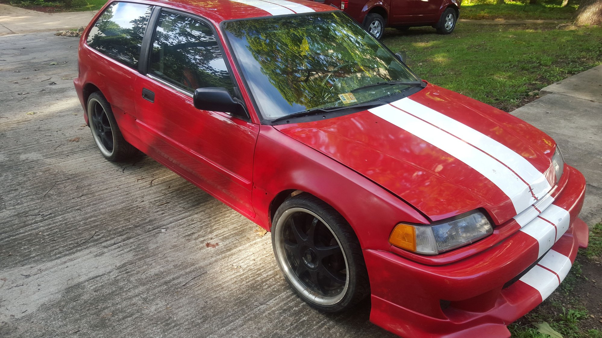

dude flippin sweet stripes & red man !
Old Nov 12, 2015 | 12:05 PM
Afroshark's Avatar
Joined: Oct 2015
Posts: 13
From: Virginia
Default Re: New Honda head
quit makin fun of meee.... lol
I don't even know if those will stay after I decide what to do about the paint and stuff. That is a ways down the road though I need to get it running right first and foremost.

So found out that the idiot that did the swap was either lazy or just didn't care we found wires from the starter cut and rigged with a relay. Found the main fuse from the battery to the brain box was blown and instead of getting a new fuse they "jumped" it. Found random hoses from the intake manifold that were just capped off with a screws. Not too sure where they are supposed to go either. I am enclosing some new photos. We are still running a little rough and rich. No where near as bad as before though. All the research that I can do suggests that we should be running lean with the ECU we have but, alas we are not.
