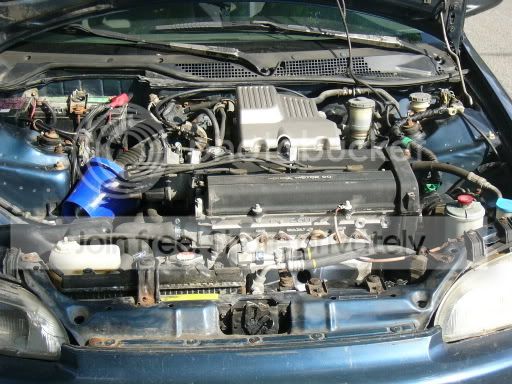

I kept both civic driver side and upper tranny mount for my b20z swap ! i used integra rear mount and front tranny mount and the b20 front mount came the engine !
b20z IM will fit in a eg but not the b20b ! i used b20 harness combined with my d15 obd1 plug and harness ! Im currently running with stock p06 ecu and everything run fine but i'm looking the chip it with crome or uberdata !
I ran the 1/4 mile in 14.8 with short ram intake and removed muffler but with stock civic exhaust line !
