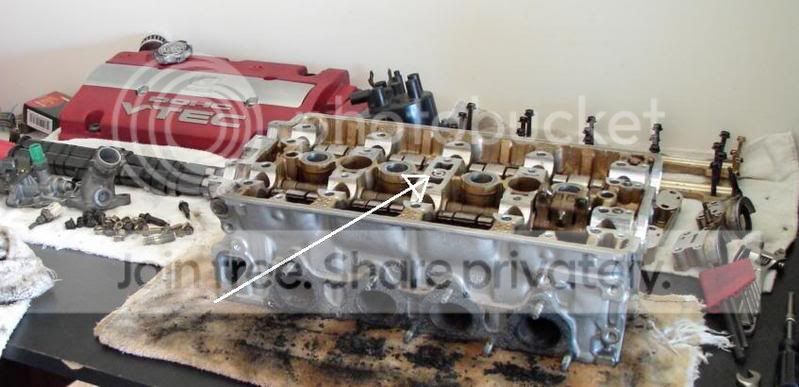

We were putting my head back and I heard this little piece from I don't know where fall to the floor. Anyone have any idea what it can be? I think it came from around the radiator area.

lol its not from the ac hose for sure.. that goes inside the head.. right in the middle.. i hope you didnt assemble the head completely yet
ill post a pic for you..

goes right in the middle hole right there

We reailzed it was from his head. My head thats going on the car had it in already, just no O ring. Pete figured it out though. Thanks.

Ups... it's quite vital part... It allows cams lubricating.

Thats the oil orifice, it goes right where Mykizism is pointing at.
