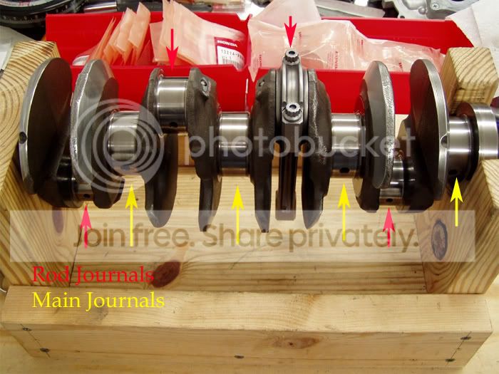

Because the kit comes with a 55mm main journal crankshaft you are going to need a 98+ block which also have 55mm mains. 97 and down blocks have 50mm mains.
Old Dec 18, 2006 | 06:28 PM
Revi's Avatar
Posts: 1,502
From: USA
Default Re: (Revi)
Heres what im talking about, the main journals are different in the 92-97 and the 98-01 blocks.
If they offer the kit with a 50mm crank, then you can use the 92-96 JDM block, which is closed deck and i believe thats the one you were talking about.

i believe the new crank is 55mm. i hope the valves aren't bent. if it is, i'll jus get a new v alve kit (sooner or later).
Old Dec 18, 2006 | 06:43 PM
ge_itr's Avatar
Posts: 517
From: bonnerdale, arkansas, usa
if my mains are 50mm and the new one is 55mm. will it fit? what customs do i have to do?
Old Dec 18, 2006 | 06:47 PM
98vtec's Avatar
moderator emeritus
Joined: Oct 2002
Posts: 16,357
Likes: 6
From: Cantonment, FL
Default Re: (ge_itr)
<TABLE WIDTH="90%" CELLSPACING=0 CELLPADDING=0 ALIGN=CENTER><TR><TD>Quote, originally posted by ge_itr &raquo;</TD></TR><TR><TD CLASS="quote">if my mains are 50mm and the new one is 55mm. will it fit? what customs do i have to do?</TD></TR></TABLE>
you would have to get the mains bored.
