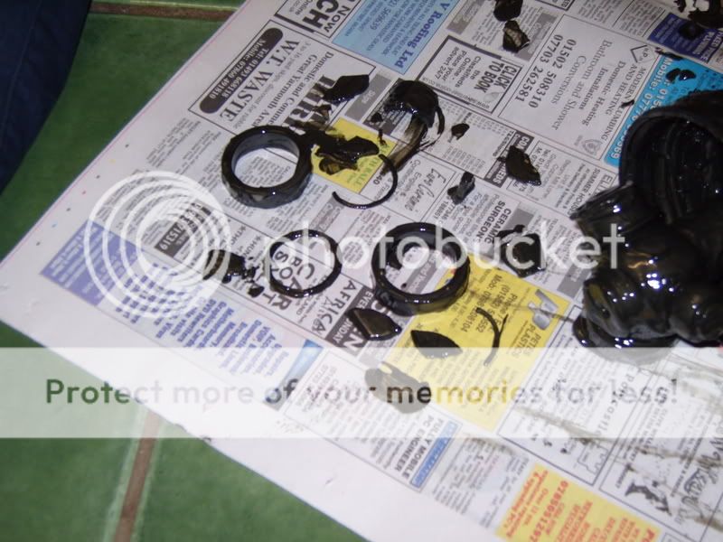

well, i shattered my inner CV joint on the passenger side (US DRIVER SIDE) on my boosted JDM lude 1992 vtec here are the pics
so anyway, im a bit broke at the mo, found a 5th gen axle at a junk yard and i know it wont fit my 4th gen, but my question is if i remove the outer CV joint from my 4th gen axle and put in on the 5th gen, well it be ok?
