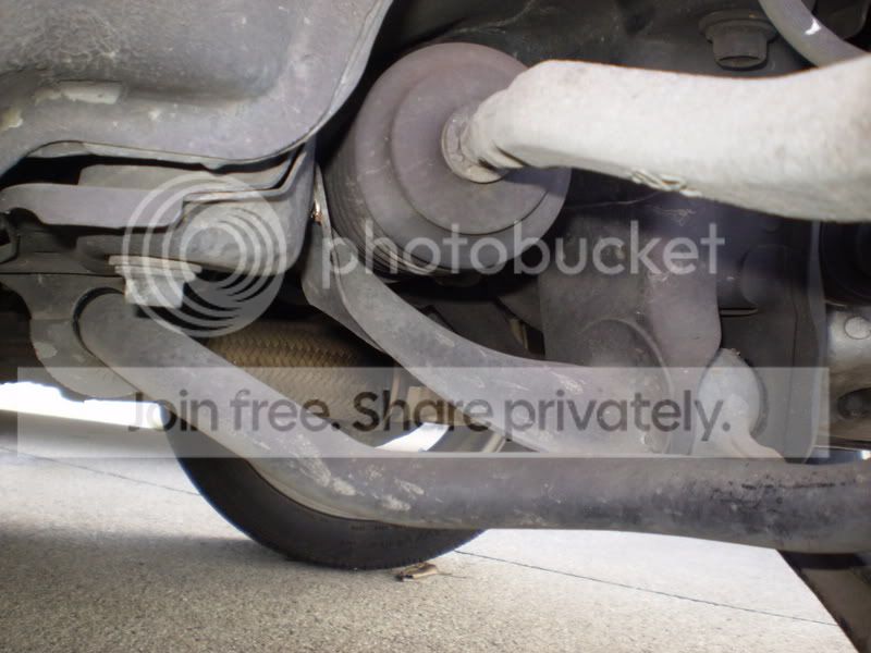

so i wrecked my prelude..and it bent the bracket that holds the lower control arm onto the frame..the bracket is rivited on..and is bent about an inch towareds the front of the car...what can i do to fix this? just bed it back? or drill out the rivits and find a new one or get a new one custom made?

Old Dec 24, 2006 | 09:16 AM
ericstambaugh07's Avatar
Posts: 212
Default Re: frame damage (ericstambaugh07)
your cradle is bent. i bent mine once before too. sucks realllly bad replaceing it. go to a body shop with frame machines, they might be able to just bend that back and weld it up. but no, your not gonna be able to just drill the rivets out and replace. you have to replace the whole engine cradle.

im just replacing my whole cradel and all of my right side susp.
change the cradel .
go to a junk yard a pick up a used one.

i just got all my parts from a junk yard. i got a cradel and everything on the pass. side susp. the shock, brakes, halfshaft, a arm, control arm everything! lol just now to change it all out and then onto my h23 turbo project!!!!

SAME EXACT THING just happened to my Prelude... $150 for the subframe cradle, $20 for the lower control arm, and $79 for the alignment... Back to normal.
