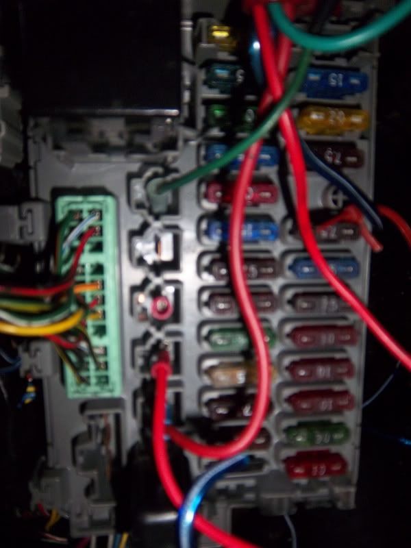

Here is the Fuse box I am using, I noticed nothing is hooked up to the "Option connectors". Is this good or bad?

I'm not a wiring genius or anything, but here is the little theory I've came up with.
I'm using a 5th gen fusebox, and wiring, so therefore, maybe I should try a 5th gen gauge cluster and wiring? I've been seeing all kinds of DIY's and GSR clusters, that would be nice, plus I think I have the wiring for it in my garage (Blue gauge cluster plugs?). Anyone shed light on this theory? It already has a yellow plug in the harness (Which I believe is a SRS hookup in 96-00 civics)

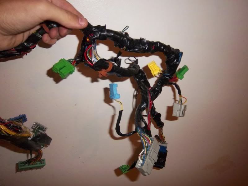

Picked up a 91 wiring harness, going to rip out this guys hackjob dash wiring tonight and see what happens <3

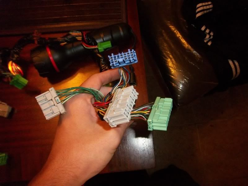

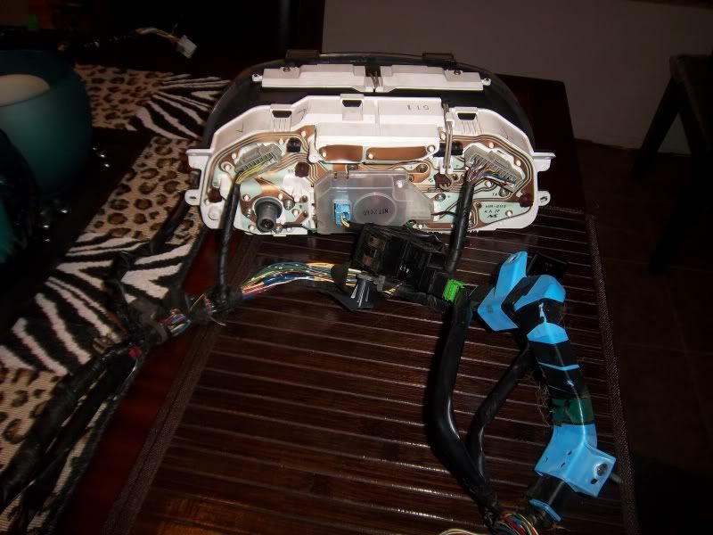

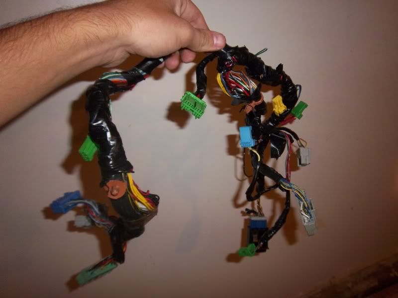

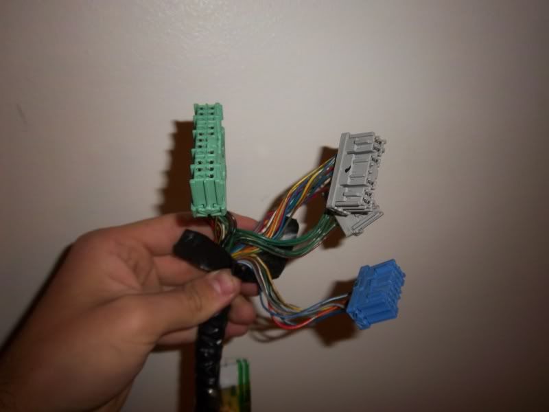

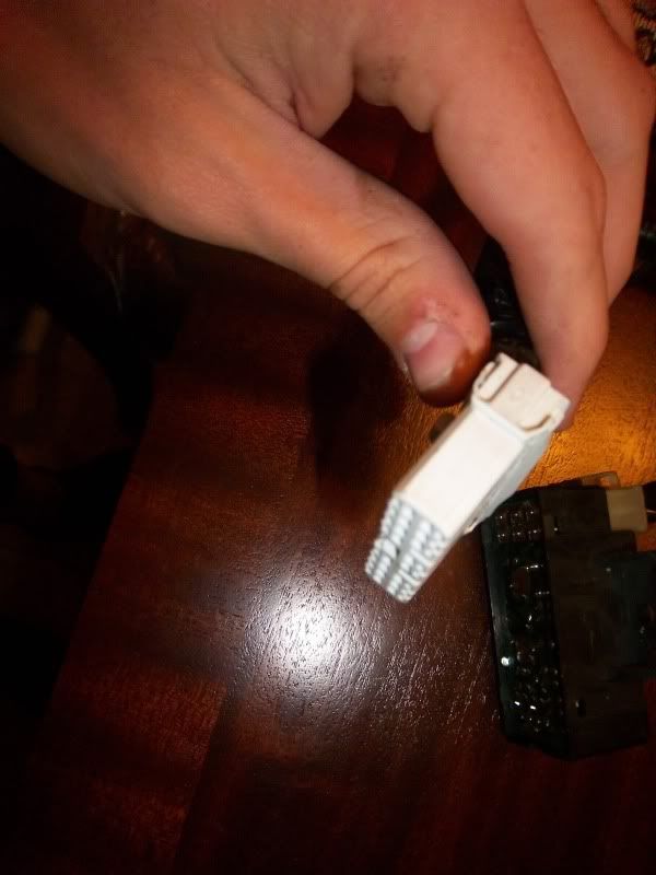

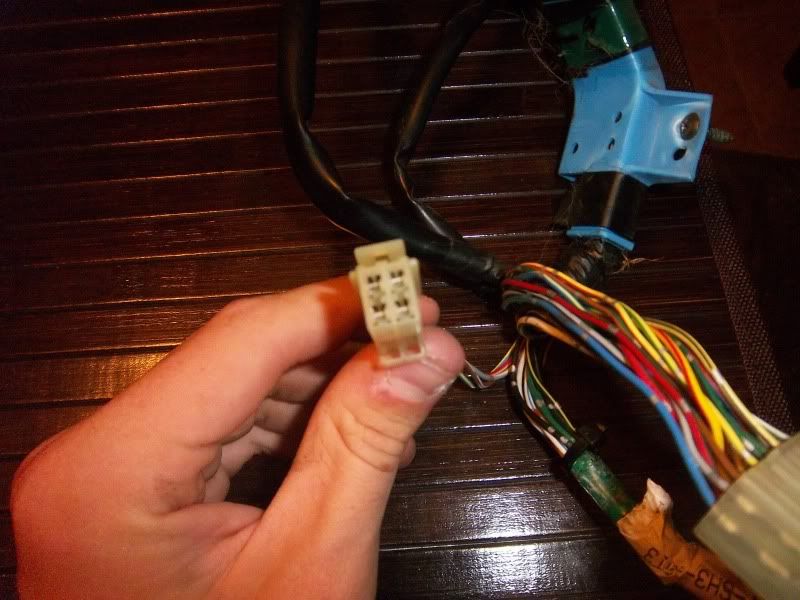

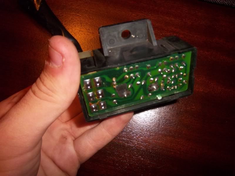

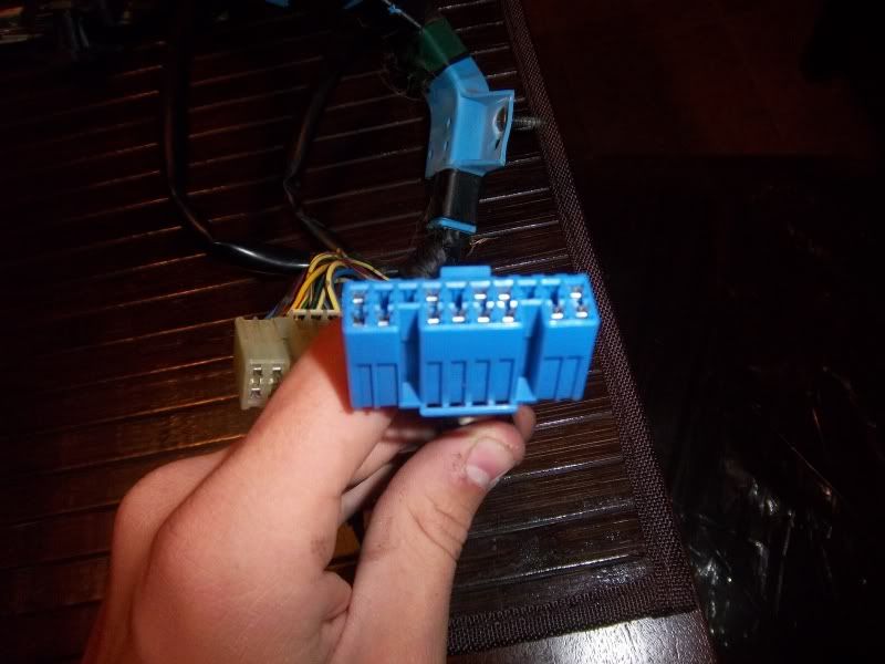

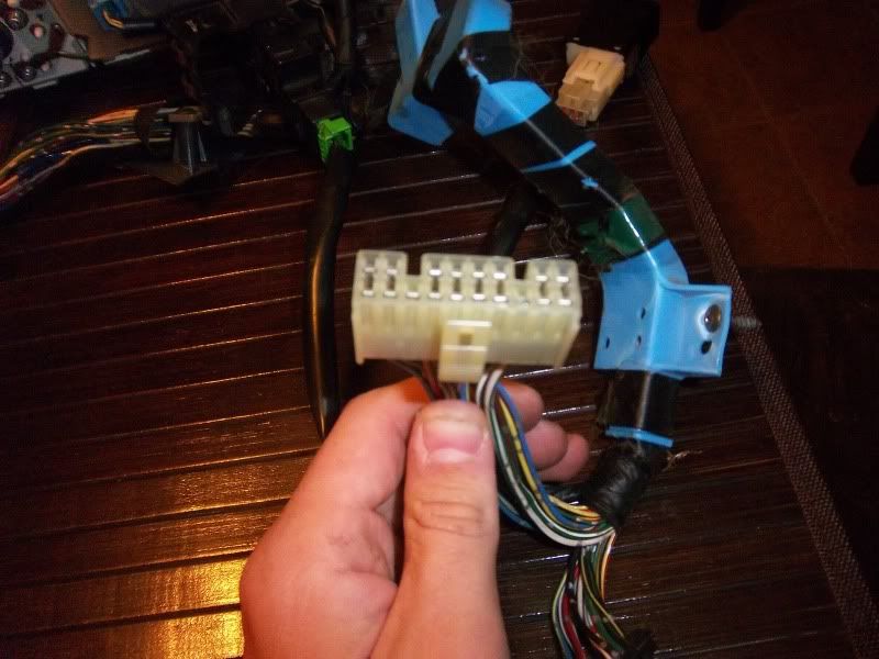

Okay, so I got the dash harness out of a 91 Civic. This is what I got, I need a little wiring help though, since the fuse plugs dont fit in the fuse box.
First off here is my exact fusebox (I think its out of a 92-95)
Here is the harness I pulled out of my car [Lol]
Here is the harness I got, I already hooked up all the plugs that fit right in, so I could give you guys a better idea of which plugs I'm either not sure of, or don't fit.

ok so my only thought is to run the obd0 dash harness into the obd1 harness you would be hacking it to fit the plugs. So in thought why not look up both diagrams for the dash harness's and re pin the obd1 harness instead of cutting ends off the obd0 to fit????

I figured I could just take the plugs off my current fusebox (Blue one and the two that go into the fusebox), and splice them into the 91 dash harness I got, wouldnt that work?
