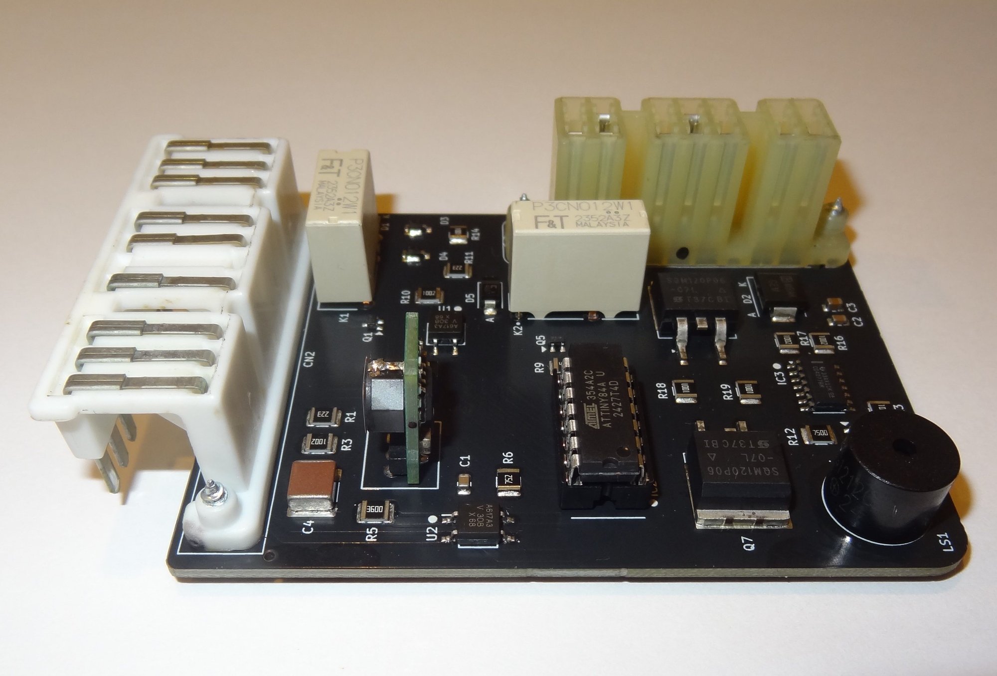

Here is a closeup picture of the final version of the updated ICU. This picture does not show the case but I always ship them in an OEM case.

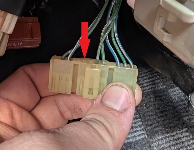

I recently came across my first USDM example of a Civic/CRX that does not have a wire that provides the washer pump signal to the ICU. It is a 1990 CRX DX built in Japan.
The additional feature that runs the windshield wipers when you spray washer fluid on the windshield will not work for a car that does not have that wire.

It would be easy to disable that feature if you don't like it, simply de-pin the wire in the location I pointed to in my June 1st post. For safe keeping you could place the wire in the empty wire location right next to it (because that location doesn't connect to anything) De-pinning is easy and also easily reversed, it is not destructive, you don't need to cut the wire. It just requires a really small screwdriver or something like that

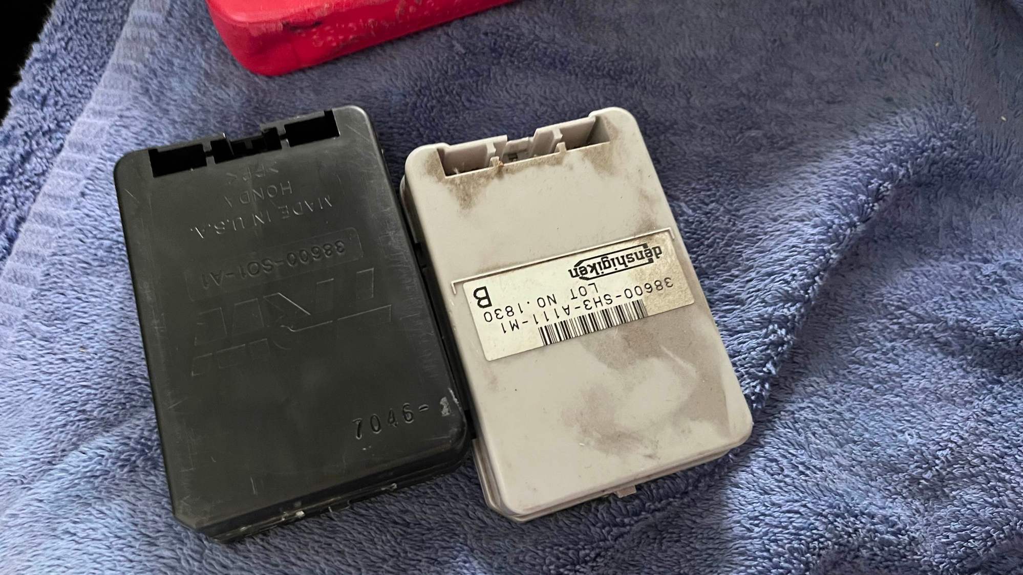

I watched your video and took these photos. If you need better photos, please let me know!
Also, I'm fine with no "headlights on" warning. Don't have it now so I have a mental note to make sure the lights are off.
