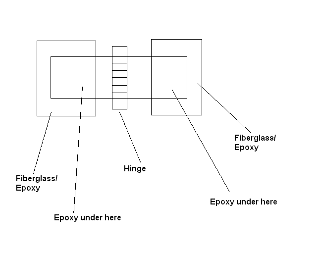

The fiberglass is completely optional (for added strength over a greater surface area). If I was going to do the hinges though, this is how I'd do it:
1. Strip the carpet from the area in which you plan to glue the hinges or fiberglass (probably underside so it'll look clean).
2. Carefully epoxy the hinges in place taking care to ensure no epoxy gets in the way of the hinge...I'd use 5 minute so it lays up faster.
3. Lay the fiberglass over the flat surfaces of the hinge, and have it go over the edges about 1 inch (make sure the 1 inch area is clear of any carpet as well). Then when you have it positioned to where you'd like, mix some more 5 min. epoxy, and brush it over the fiberglass letting it soak in.
4. give it a quick sanding, and spray the fiberglass or hinge area black.
Done.
Total cost of parts: Not more than $20.00, and it'll last forever as long as you don't start using your cargo cover as a snowboard.
*Edit* Here is a ghetto 2 min. paint drawing of the above directions:
Good luck!
