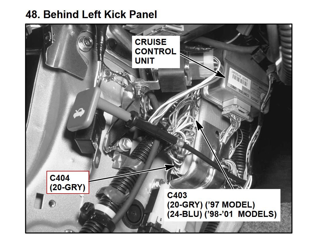

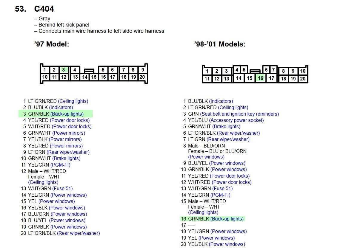

You may have been looking at this video:
For a '97 CR-V, the Grn/Blk wire that feeds the back-up lights (reverse) is at terminal pin number 3 of the gray Connector C404; instead of terminal pin number 16 on 98-01 CR-Vs.
