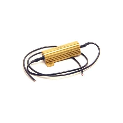

I installed a couple putco led resistor's one on each front turn signal and it corrected the hyperflashing problem. It now blinks at the original oem speed.
If you change all four turn signal's you will need to put a resistor on each one. I installed one on the driver side and it fixed that side, but the passenger side hyperblinked.
Amazon sells them cheaper than the shop I went too, but I needed them quickly.
These are the aluminum ones

I was able to swap turn signal relay that plugs into the fuse box under the dash to an electronic turn signal relay that can handle LEDs. This got rid of the fast blinking I had in my 93 with just the rear bulbs swapped to LEDs. I expect it should work with all of them swapped. I used a Novita EP34 "electronic turn or signal flasher" which can be bought at most local auto parts stores like autozone for ~$13. A lot less work than wiring resistors in properly.

Post #27. Get some of those. One for each corner. If you're saying that's what you did and it's still not working then you're on your own.

Is resistor and flasher the same thing, just another name? If I were to put LED turn signals bulbs and they hyper flashed, then all I need is to add a resistor and that's it? Or is there anything else I need add?
The electronic flasher is a replacement (electronic) relay. Relays and resistors are not the same thing.

If you go the resistor route you wire in 4 of them and use your stock relay. The hope I had based on the electronic relay was that I don't have to wire in resistors at each corner, but I can only get 2 LEDs in without funky things happening like both side signals going on at the same time.
