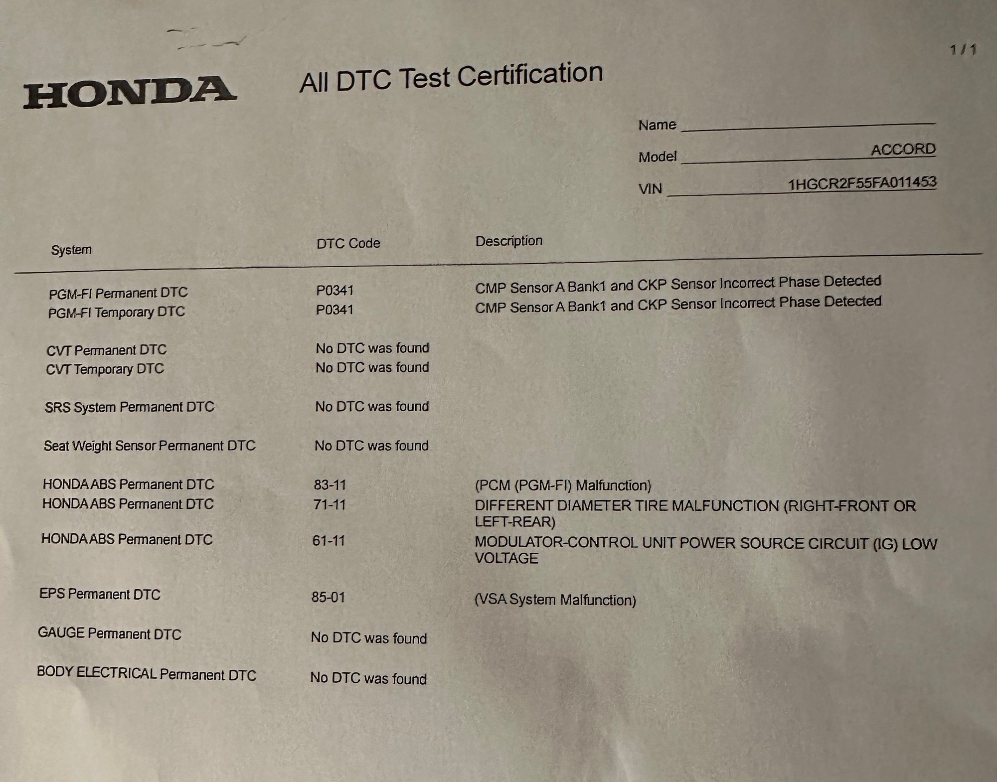

Does anyone know the part number for a 2015 Honda Accord Sport TPMS Sensor?

What trouble code or indicators do you have?
The 2015 Accord comes with an indirect TPMS that doesn’t use tire pressure sensors mounted inside the tires. Instead, it uses the existing VSA wheel speed sensors to monitor and compare tire characteristics while driving.
The VSA wheel speed sensor part numbers are different depending on the location. Also, it may not be due to the wheel speed sensor.
