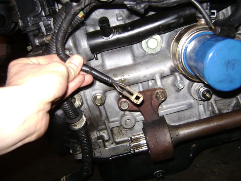

I'm putting a h22a into a 95 Accord. This looks like a typical thermostat ground however it's not within reach. I know a ground is a ground but I'm curious where Honda mounted it. PICS:
This is where I routed it to:

Pretty sure you can look up the Honda ground locations, so just trace that wire from its source, and then look up where it actually did go.

If your fuel system doesnt work when it is not grounded, then it should be routed to the thermostat housing area.
I'm almost positive that is where it goes.
Tucked in the back will work just fine though.

Good point, I'll leave it as is. I'm surprised the Accord wiring harness didn't come close to the stock thermostat grounding location on the H22a. If I have any issues with fuel or the ecu I'll know where to look first. Thx

I'm pretty sure what you have pictured above is the engine harness ground (G101). It is attached to the end of the intake manifold on the F22B1-2. Not the thermostat. You should attach it to the H22 manifold anywhere you can find a spot. It's the same thing as the thermostat ground only they moved it to the manifold on the Accord's

Did the ground end up working on the back of the block by the oil filter or did you have to relocate it to the intake manny? And did you have any fuel injectors issues when starting your H swapped accord?
